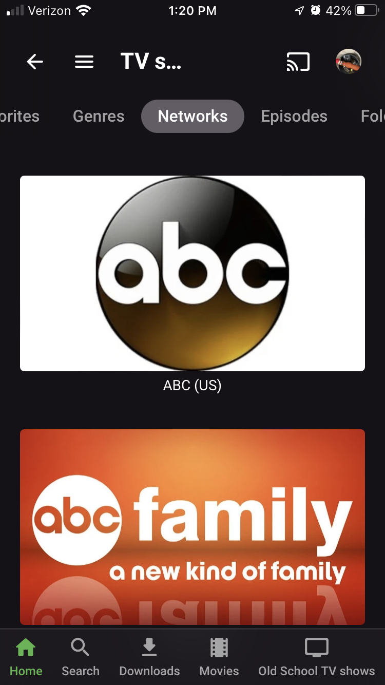

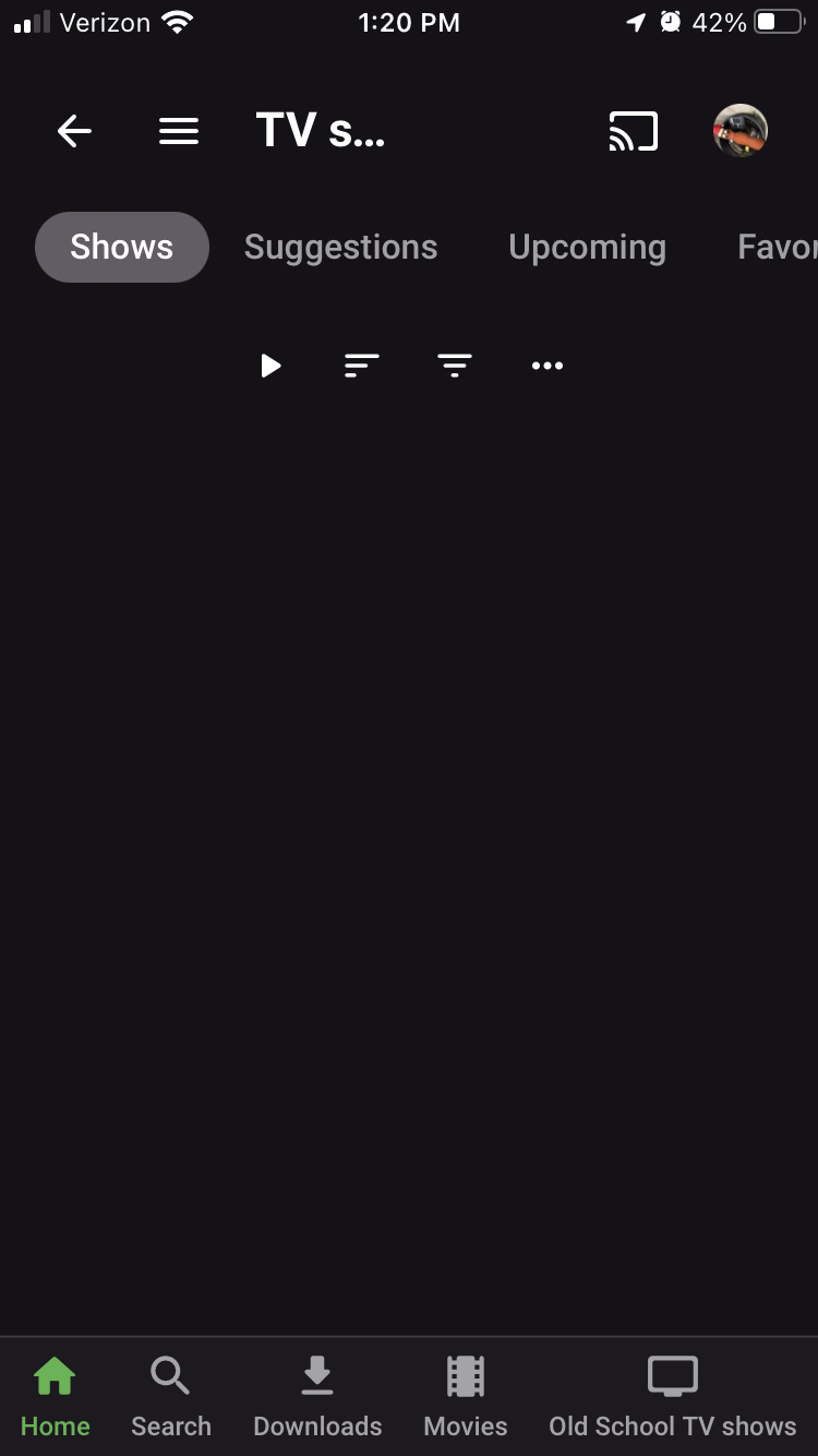

A few weeks ago I noticed my TV shows not showing anymore (image 1). If I go over to favorites or networks they display through that though. I tried deleting and re-adding the file location then the media folder from emby itself. Neither fixed the problem. The media folder refuses to actually delete from Emby for some reason and even when it said Zero folders were feeding it and scanning the library I could still access my shows. If anyone has any advice to what’s going on Thank you in advance.

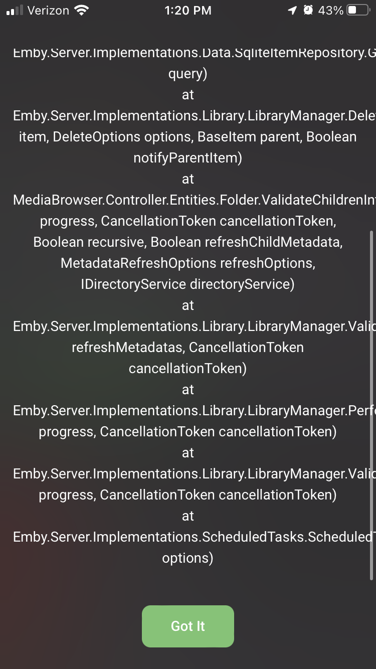

embyserver.txt
Happy2Play
Not sure of the cause of this one but you will have to follow the steps in the KB to see if it can be saved or start a new one.
SQLitePCL.pretty.SQLiteException: Error: cannot rollback - no transaction is active
Corrupt Database : Emby
Google suggests cause by disk space issue.
