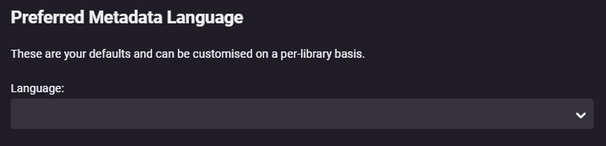

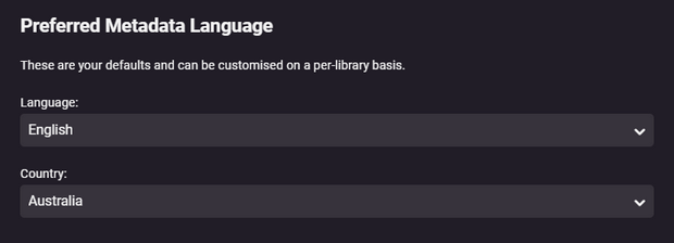

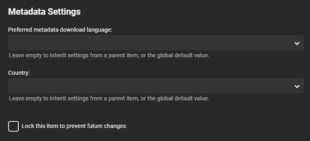

Happy2Play 9814 Posted April 5, 2022 Posted April 5, 2022 (edited) @seanbuffcan you verify "Preferred Metadata Language" on Settings-Library, Advanced tab. As that is the Global setting, then you have the optional per library and per series options (but they should/will inherit the global setting if they are blank). To me somehow your global setting is no longer set. Edited April 5, 2022 by Happy2Play
seanbuff 1360 Posted April 5, 2022 Posted April 5, 2022 2 minutes ago, Happy2Play said: @seanbuffcan you verify "Preferred Metadata Language" on Settings-Library, Advanced tab. As that is the Global setting, then you have the optional per library and per series options. Global Setting: Library Setting for TV Shows: Series Level (Man v. Food): What stands out to me is my "global" country is set to Australia, but my "library" country is set to US -- not sure if that makes a difference.
Happy2Play 9814 Posted April 5, 2022 Posted April 5, 2022 21 minutes ago, seanbuff said: What stands out to me is my "global" country is set to Australia, but my "library" country is set to US -- not sure if that makes a difference. To my knowledge Country should only affect Parental Rating. Everything looks correct, so we will have to wait for the man to comment as I think all the bases have been covered. 1
