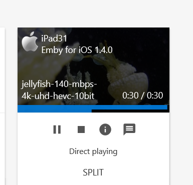

denz 501 Posted July 22, 2017 Posted July 22, 2017 (edited) I put the three jellyfish to a new library and out of the three jeelyfish-30-mbps-hd-h264 when I play it on ipad 2 it is hardly using any cpu but all the others cpu is 100%. I have also noticed when I enable hardware encoding/decoding the dashboard is reporting direct playing but nothing plays but it shouldn't be able to play 1080 video on ipad 2 maybe I am wrong probable am. I attached some ffmpeg logs so maybe someone can have a look. Intel® Core™ i5-7200U Processor is my cpu In this example when I play 4k file it says direct playing but on the ipad there is only a static photo and once the bottom bar goes to 100% after couple of minutes it goes to transcoding and the video plays. Scrap that disabled hardware acceleration and it is still the same starts with direct playing and then it is transcoding. Thank you ffmpeg-20170722-134036.log ffmpeg-20170722-134110.log ffmpeg-20170722-134350.log Edited July 22, 2017 by denz

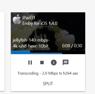

Waldonnis 148 Posted July 23, 2017 Posted July 23, 2017 I'd be curious to know if hardware transcoding is working for you in Emby on something other than mpeg2 transport stream files. If you turn on hardware encoding/decoding and force a transcode by lowering the max bitrate of your iPad client, do the jellyfish files transcode and play back properly? I'm guessing that you will probably have some issues with hardware decoding your recorded television files if they're all mpeg2 transport streams, but the jellyfish samples are encoded differently and you shouldn't see the same decoder problem crop up with them (fingers crossed). If everything works fine with non-mpeg2 files, I'm thinking the best way to handle it in the meantime is to omit hardware decoding for mpeg2 when using QuickSync until the problem is addressed upstream. mpeg2 shouldn't be too hard to decode for most processors anyway, so it shouldn't really increase the load too much and it's better failing entirely in situations like this. It would also allow hardware decoding for more difficult codecs like HEVC rather than having to disable the use of the whole block because of a problem with decoding mpeg2 in certain situations. Another option would be to implement a "fall back to software decoding" solution, but that's a bit more complex to implement. I don't deal with many mpeg2ts files so I'm not sure how common it is for these files to have this type of issue...and it's proving difficult to detect which files may trip up the decoder. Given what I've seen in this sample, it would likely require a deeper analysis of each file to even spot a situation like this. I could probably come up with a way, but it's more analysis than I'd expect Emby to do for every file in a library (short-duration frame dump followed by some output parsing is the "easiest" way). I'm still looking to see if there are any options that might get around this, but I'm not too hopeful, given how ffmpeg handles decoding and seeking.
denz 501 Posted July 23, 2017 Posted July 23, 2017 (edited) Many transcode files are being generated and all the jellyfish videos work the 4k one does take 3 minutes to start. I have attached logs. All the recordings that have been auto converted work with quicksync or at least I think it does since the gpu core clock goes from 300 to 1000 but don't understand why does ffmpeg still uses such a high percentage of cpu, with hardware acceleration enabled or disabled it is the same. As you have mentioned it seems to be only an issue with mpeg2 none of them work so it is an upstream issue. ffmpeg-transcode-37c518e6-145a-4716-a68b-cbb583376ff9.zip ffmpeg-transcode-05027e87-ea83-4533-afef-990e578256ee.txt ffmpeg-transcode-aee41bd5-2417-4d89-8b28-946d1ec22c07.txt ffmpeg-transcode-livetv recording with automatic conversion to mkv.txt server-63636418366.txt Edited July 23, 2017 by denz
