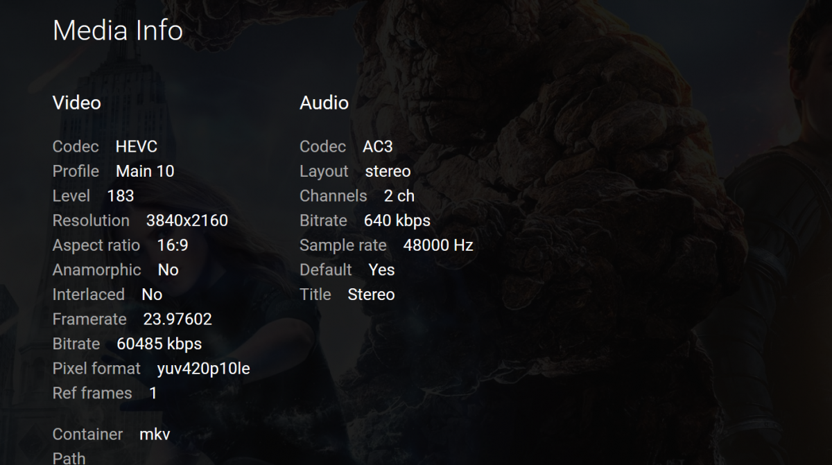

bxsteez 3 Posted December 17, 2016 Posted December 17, 2016 I've been poking around the forums to see if this has been answered so forgive me if I've missed it. I'm trying to transcode a 10bit HEVC file using the my GTX 1070 and I keep getting errors of No NVENC device in the ffmpeg log. I'm not sure why since I'm sure the 1070 supports hw decoding of 10bit HEVC. I try to play it on my Nvidia Shield and the file doesn't even play. Should this be possible?
Waldonnis 148 Posted December 18, 2016 Posted December 18, 2016 (edited) I've been poking around the forums to see if this has been answered so forgive me if I've missed it. I'm trying to transcode a 10bit HEVC file using the my GTX 1070 and I keep getting errors of No NVENC device in the ffmpeg log. I'm not sure why since I'm sure the 1070 supports hw decoding of 10bit HEVC. I try to play it on my Nvidia Shield and the file doesn't even play. Should this be possible? The 1070 should support both hardware decoding and encoding of 10bit HEVC, but if it's giving you an error saying that it can't find an NVENC device, then the problem may be somewhere else. Double-check the driver installation for starters, as this is the most common reason for that type of error in my experience. You can also try transcoding a non-HEVC file (h.264 is easy) using the hardware encoder to make sure the issue isn't specific to ffmpeg's nvenc_hevc encoder. FYI, 10bit pixel formats weren't supported in ffmpeg's NVENC implementation until fairly recently (circa August, I believe). I also don't know if the few issues with the submitted patch were ever resolved (I think there was an issue with yuv420p10, but it's been a few weeks since I read about it) or how much of it was accepted. It may be a work in progress still, since it seems there may have been more involved to add Main10 support. Either way, I would try one of the latest static Zeranoe builds manually to see if the problem is with ffmpeg or on the driver side. If you're not too handy with ffmpeg options, just let me know so I can PM or post some command lines that may be useful for testing this. Sadly, I don't have a Pascal card (yet!) to double-check this. Hoping that will change soon. I've been researching some potential computer upgrade options (1070 or 1080 is leading that race) over the past few weeks, which is why I know about that 10bit patch info. Wacky timing! Edit: One more thing - can we see the media info on the file in question? I doubt it's the file, but just to eliminate a few more potential factors... Edited December 18, 2016 by Waldonnis
bxsteez 3 Posted December 18, 2016 Posted December 18, 2016 (edited) The 1070 should support both hardware decoding and encoding of 10bit HEVC, but if it's giving you an error saying that it can't find an NVENC device, then the problem may be somewhere else. Double-check the driver installation for starters, as this is the most common reason for that type of error in my experience. You can also try transcoding a non-HEVC file (h.264 is easy) using the hardware encoder to make sure the issue isn't specific to ffmpeg's nvenc_hevc encoder. FYI, 10bit pixel formats weren't supported in ffmpeg's NVENC implementation until fairly recently (circa August, I believe). I also don't know if the few issues with the submitted patch were ever resolved (I think there was an issue with yuv420p10, but it's been a few weeks since I read about it) or how much of it was accepted. It may be a work in progress still, since it seems there may have been more involved to add Main10 support. Either way, I would try one of the latest static Zeranoe builds manually to see if the problem is with ffmpeg or on the driver side. If you're not too handy with ffmpeg options, just let me know so I can PM or post some command lines that may be useful for testing this. Sadly, I don't have a Pascal card (yet!) to double-check this. Hoping that will change soon. I've been researching some potential computer upgrade options (1070 or 1080 is leading that race) over the past few weeks, which is why I know about that 10bit patch info. Wacky timing! Edit: One more thing - can we see the media info on the file in question? I doubt it's the file, but just to eliminate a few more potential factors... I am definitely not handy with ffmpeg but I did keep poking around the world of google and I read that the build is hardcoded to 8bit or 10bit. Is that still true? I was able to transcode h264 file without an issue and I'm pretty sure it was being done by the GPU. It's just the yuv420p10le pixel format that gives me trouble I attached the media info. EDIT: I thought I attached the file but forgot to click attach this file lol Edited December 18, 2016 by bxsteez
Waldonnis 148 Posted December 18, 2016 Posted December 18, 2016 I am definitely not handy with ffmpeg but I did keep poking around the world of google and I read that the build is hardcoded to 8bit or 10bit. Is that still true? I was able to transcode h264 file without an issue and I'm pretty sure it was being done by the GPU. It's just the yuv420p10le pixel format that gives me trouble I attached the media info. You can compile ffmpeg for both, but it's a serious pain to do so and probably why none of the mainstream builds have bothered to do so. Mostly, that applies to the software encoders, though, as ffmpeg itself doesn't care. "libx264" and "libx265" encoders are actually library versions of the x264 and x265 stand-alone encoders, and both definitely require special compilation for 10 and 12bit support. What I'm not sure is just how NVENC's interface to ffmpeg is implemented, but it's likely that it shouldn't need special compilation - just that the code is in ffmpeg to talk to the driver properly when it comes to new options. yuv420p10le may indeed be an issue, as I don't think that part of the patch was accepted (it worked, but there were some technical implementation reasons that caused it to be rejected). It may have since been worked on, but I would have to dredge the mailing list and commit logs again to find out. If it's still not suported, it sucks since yuv420p10le is pretty widely used. If you want to double-check that the GPU was used in your successful test, look for the ffmpeg command line in the transcode log and see if you can find any reference to NVENC in there (either a -vcodec or -codec option...or maybe something in the stats output that mentions nvenc). "Speed" isn't a bad indicator as well, since CPU/software transcoding would be significantly slower and pretty obvious (especially if the source was HEVC 2160p). I do compile my own ffmpeg with 10/12bit support locally, but can't redistribute it due to license restrictions on one of the audio encoders that I include in my build. If the problem isn't only with the yuv420p10le pixel format, I may be able to prune out the audio encoder and build a binary to test with, but it may take a few days for me to get that set up and done (stupid holidays). Oh, one other thing - can you run the command below and PM the output to me? I'm mostly curious to see what I would have to work with and what's been implemented so far if I snag a new Pascal card this month, but am also trying to think of a way to work around the apparent limitation (more info is always a good thing): ffmpeg -h encoder="nvenc_hevc"
bxsteez 3 Posted December 18, 2016 Posted December 18, 2016 You can compile ffmpeg for both, but it's a serious pain to do so and probably why none of the mainstream builds have bothered to do so. Mostly, that applies to the software encoders, though, as ffmpeg itself doesn't care. "libx264" and "libx265" encoders are actually library versions of the x264 and x265 stand-alone encoders, and both definitely require special compilation for 10 and 12bit support. What I'm not sure is just how NVENC's interface to ffmpeg is implemented, but it's likely that it shouldn't need special compilation - just that the code is in ffmpeg to talk to the driver properly when it comes to new options. yuv420p10le may indeed be an issue, as I don't think that part of the patch was accepted (it worked, but there were some technical implementation reasons that caused it to be rejected). It may have since been worked on, but I would have to dredge the mailing list and commit logs again to find out. If it's still not suported, it sucks since yuv420p10le is pretty widely used. If you want to double-check that the GPU was used in your successful test, look for the ffmpeg command line in the transcode log and see if you can find any reference to NVENC in there (either a -vcodec or -codec option...or maybe something in the stats output that mentions nvenc). "Speed" isn't a bad indicator as well, since CPU/software transcoding would be significantly slower and pretty obvious (especially if the source was HEVC 2160p). I do compile my own ffmpeg with 10/12bit support locally, but can't redistribute it due to license restrictions on one of the audio encoders that I include in my build. If the problem isn't only with the yuv420p10le pixel format, I may be able to prune out the audio encoder and build a binary to test with, but it may take a few days for me to get that set up and done (stupid holidays). Oh, one other thing - can you run the command below and PM the output to me? I'm mostly curious to see what I would have to work with and what's been implemented so far if I snag a new Pascal card this month, but am also trying to think of a way to work around the apparent limitation (more info is always a good thing): ffmpeg -h encoder="nvenc_hevc" My logs have the following [h264 @ 0000000002f07a40] Warning: not compiled with thread support, using thread emulation [dca @ 0000000001bfe600] Warning: not compiled with thread support, using thread emulation [h264_nvenc @ 0000000001c0f2e0] Warning: not compiled with thread support, using thread emulation [aac @ 0000000001c0dc60] Warning: not compiled with thread support, using thread emulation Output #0, mpegts, to 'E:\transcode temp\transcoding-temp\7a6cdf6e9860bc210f8e0d799d16128d.ts': Metadata: encoder : Lavf57.60.100 Stream #0:0: Video: h264 (h264_nvenc) (Main), yuv420p, 3840x2160 [SAR 1:1 DAR 16:9], q=-1--1, 39459 kb/s, 23.98 fps, 90k tbn, 23.98 tbc (default) Metadata: encoder : Lavc57.68.100 h264_nvenc Side data: cpb: bitrate max/min/avg: 39459629/0/39459629 buffer size: 78919258 vbv_delay: -1 Stream #0:1: Audio: aac (LC), 48000 Hz, stereo, fltp (24 bit), 128 kb/s (default) Metadata: encoder : Lavc57.68.100 aac Stream mapping: Stream #0:0 -> #0:0 (h264 (native) -> h264 (h264_nvenc)) Stream #0:1 -> #0:1 (dts (dca) -> aac (native)) I am going to try the command you mentioned tonight and report back
Waldonnis 148 Posted December 18, 2016 Posted December 18, 2016 Yep, looks like it was using the hardware encoder, which is a good sign. At least we know that it does work on something and communicates with the card/driver. Depending on what the encoder supports, I can generate a small test video file (with just colour bars) to try other pixel formats like yuv444p10le or yuv422p10le. If it only supports the Main10 profile, though, it won't work because that profile is restricted to 4:2:0 chroma sampling. I'll dig in some of NVidia's docs and see what I can find (either way, I'm adding some new samples to my sample library).
