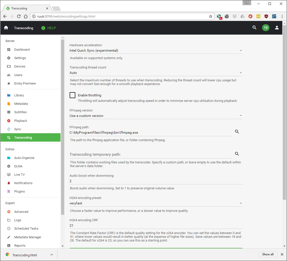

tp90254 0 Posted October 26, 2016 Posted October 26, 2016 (edited) In process of continuing to set up Emby, I am noticing that even though I have "quicksync" selected for Hardware Acceleration -- it doesn't seem to use the qsv_h264 coder. Here's a sample from the logfile: C:\MyProgramFiles\ffmpeg\bin\ffmpeg.exe -fflags +genpts -async 1 -vsync -1 -i "http://127.0.0.1:8096/LiveTv/LiveStreamFiles/f974a3a0609047c992457ada45e9be6c/stream.ts"-t 00:29:59.699 -sn -codec:v:0 libx264 -force_key_frames "expr:gte(t,n_forced*5)" -vf "yadif=0:-1:0" -pix_fmt yuv420p -preset superfast -crf 23 -b:v 25000000 -maxrate 25000000 -bufsize (25000000*2) -vsync -1 -profile:v high -level 41 -map_metadata -1 -threads 0 -codec:a:0 aac -strict experimental -ab 320000 -y "Z:\AvaShare\video\TVDVR\Series\Dinosaur Train\Season 1\Dinosaur Train S01E11 Night Train; Fossil Fred-1.mkv" Also, I requested the "veryfast" profile in the settings, but the logfile is showing "superfast". Looking through the logfile, the encoding speed is consistent with the speed I noticed when testing ffpmeg with software encoding. Thx Edited October 26, 2016 by tp90254
Luke 42241 Posted October 26, 2016 Posted October 26, 2016 In process of continuing to set up Emby, I am noticing that even though I have "quicksync" selected for Hardware Acceleration -- it doesn't seem to use the qsv_h264 coder. Here's a sample from the logfile: C:\MyProgramFiles\ffmpeg\bin\ffmpeg.exe -fflags +genpts -async 1 -vsync -1 -i "http://127.0.0.1:8096/LiveTv/LiveStreamFiles/f974a3a0609047c992457ada45e9be6c/stream.ts"-t 00:29:59.699 -sn -codec:v:0 libx264 -force_key_frames "expr:gte(t,n_forced*5)" -vf "yadif=0:-1:0" -pix_fmt yuv420p -preset superfast -crf 23 -b:v 25000000 -maxrate 25000000 -bufsize (25000000*2) -vsync -1 -profile:v high -level 41 -map_metadata -1 -threads 0 -codec:a:0 aac -strict experimental -ab 320000 -y "Z:\AvaShare\video\TVDVR\Series\Dinosaur Train\Season 1\Dinosaur Train S01E11 Night Train; Fossil Fred-1.mkv" Also, I requested the "veryfast" profile in the settings, but the logfile is showing "superfast". Looking through the logfile, the encoding speed is consistent with the speed I noticed when testing ffpmeg with software encoding. Thx Please always attach complete log files. Instructions on how to do that can be found here: https://emby.media/community/index.php?/topic/739-how-to-report-a-problem/ Thanks.
tp90254 0 Posted October 26, 2016 Posted October 26, 2016 (edited) Please always attach complete log files. Instructions on how to do that can be found here: https://emby.media/community/index.php?/topic/739-how-to-report-a-problem/ Thanks. Thanks for the info.. Last time I posted a log, I felt guilty about all the vertical real-estate it took I am attaching the logfile Log.txt, server log ServerLog.txt as well as a screengrab of the transcoding settings I am using. Thanks Edited October 26, 2016 by tp90254
tp90254 0 Posted October 26, 2016 Posted October 26, 2016 And the Emby Server log? Sorry -- it's attached on the original post now.
Luke 42241 Posted October 26, 2016 Posted October 26, 2016 Well I would need to see the log from when the server originally started, although you can check this on your own. There will be lines like these 2016-10-26 11:59:51.5078 Info MediaEncoder: Decoder available: h264_qsv 2016-10-26 11:59:51.5078 Info MediaEncoder: Decoder available: mpeg2_qsv 2016-10-26 11:59:51.5078 Info MediaEncoder: Decoder available: vc1_qsv 2016-10-26 11:59:51.5293 Info MediaEncoder: Encoder available: h264_qsv If you dont' see those then it means your ffmpeg build does not support quick sync.
Luke 42241 Posted October 26, 2016 Posted October 26, 2016 Oh, and these settings currently only apply to playback and sync. They have not yet been applied to the recording process.
tp90254 0 Posted October 26, 2016 Posted October 26, 2016 Oh, and these settings currently only apply to playback and sync. They have not yet been applied to the recording process. OK -- that explains it. I do see the above "Decoder available: h264_qsv" message in my logfile. But since the settings don't apply to recordings, it's moot. What I am noticing, are incomplete recordings, and some duplicate filenames (i.e. the same filename with a "-1" appended) for the few recordings I have scheduled. My ideal process would be to just record and save the mpeg2, then post-process the mpeg2 into a h264 when server load is light, and lastlyt the original once the conversion is complete. Is this possible?
