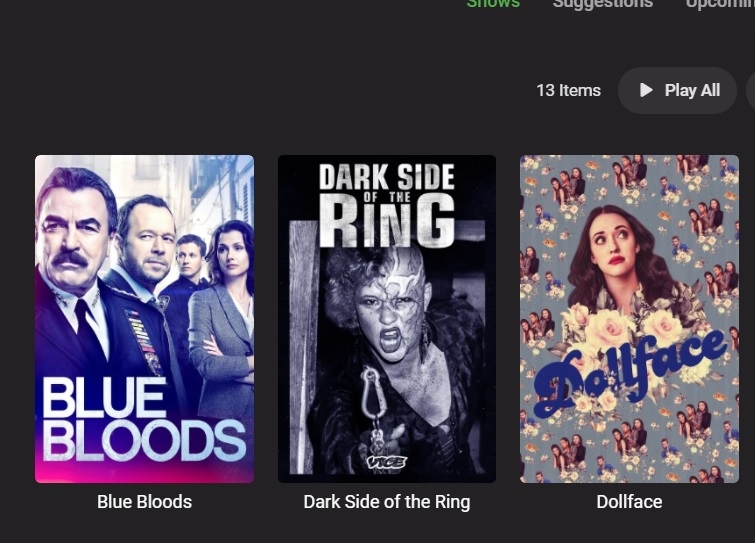

ClemFandango 18 Posted March 25, 2022 Posted March 25, 2022 I've got all of my media on my Synology DS118 organised into folders, one of which is called "Current Television" which is for everything that's, well, "Current" I was randomly going through the library and updating the primary cover images for some of the shows for no real reason, but a few days after I did that I noticed that the images had reset to the original ones. I tried updating some of them again and the same thing happened so I tried removing the library completely and re-adding it and the same thing happened again. I've even tried manually downloading the cover images from The TVDB, deleting the primary image and manually uploading the new image and still it reverts back to the original after a few hours. The library "Current Television" isn't set to automatically refresh either. What makes this strange is that i've got a separate library called simply "Television" where I've also manually updated some of the cover images and this has been fine - same with my "Movies" library as well. It's just "Current Television" that seems to have the problem.
Luke 42243 Posted March 25, 2022 Posted March 25, 2022 Quote I was randomly going through the library and updating the primary cover images for some of the shows for no real reason, but a few days after I did that I noticed that the images had reset to the original ones. HI there, can you please show us a specific example? Thanks.
ClemFandango 18 Posted March 25, 2022 Author Posted March 25, 2022 (edited) That probably would have helped :). Ok, here's a snapshot of the "Current TV" page and I'll use "Blue Bloods" as the main example. The attachment at the top has the "default" image. The one underneath is what I've changed the cover to. I've just done it again be using the magnifying glass search function on the "Primary" image and selected the new one. I can almost guarantee that in a few hours, it'll have reverted to the original image at the top. Edited March 25, 2022 by ClemFandango

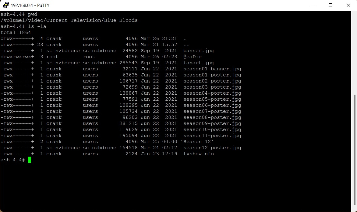

ClemFandango 18 Posted March 26, 2022 Author Posted March 26, 2022 10 minutes ago, Happy2Play said: Did this image actually get deleted? As you see one is saved to /metadata and original supposedly gets deleted from with media. 2022-03-26 21:21:48.333 Info HttpClient: GET https://www.thetvdb.com/banners/posters/5ba9678b8729a.jpg 2022-03-26 21:21:48.603 Debug ProviderManager: Saving image to /var/packages/EmbyServer/var/metadata/library/5a/5a3d7cb58414b20f9492d9d86d41d37e/poster.jpg 2022-03-26 21:21:48.680 Info ProviderManager: Deleting previous image /volume1/video/Current Television/Blue Bloods/poster.jpg But am guessing that is actually not happening and gets restored later. Now I'm signed in via Putty at the moment and I'm looking directly at the "Blue Bloods" folder and the file "poster.jpg" is indeed gone. I've attached a screengrab as proof.

ClemFandango 18 Posted March 27, 2022 Author Posted March 27, 2022 (edited) It's baaaaack .. lol Now the interesting thing is that the file at /var/packages/EmbyServer/var/metadata/library/5a/5a3d7cb58414b20f9492d9d86d41d37e/poster.jpg is still there and is actually still the new image i changed it to. I'm wondering if there's an issue with the Sonarr package though instead of Emby ? My "Current Television" library is exclusively used by Sonarr, which is what creates the user (and group) "sc-nzbdrone" This could potentially explain why it's only happening in this library and not the others I suppose. Edited March 27, 2022 by ClemFandango
ClemFandango 18 Posted March 27, 2022 Author Posted March 27, 2022 (edited) I've just deleted and re-added Blue Bloods in Sonarr, which will have also fully removed those folders from the NAS as well. I'll have to grab an episode before Emby will see it again so i'll do that and change the image again to see what happens. #edit Although saying that, I did fully remove and re-add the entire "Current Television" library yesterday and the problem still happened. The only difference will be that I probably didn't actually physically remove any of the actual content so we'll see if it makes a difference. Edited March 27, 2022 by ClemFandango
Solution Happy2Play 9812 Posted March 27, 2022 Solution Posted March 27, 2022 (edited) Yes you either need to disable options in Sonarr or have Emby save with media as they are competing with each other and local/images with media will always take priority. Same/Similar discussion here not that we know Sonarr is involved. Question about Sonarr replacing images - MacOS - Emby Community Edited March 27, 2022 by Happy2Play added previous discussion topic
