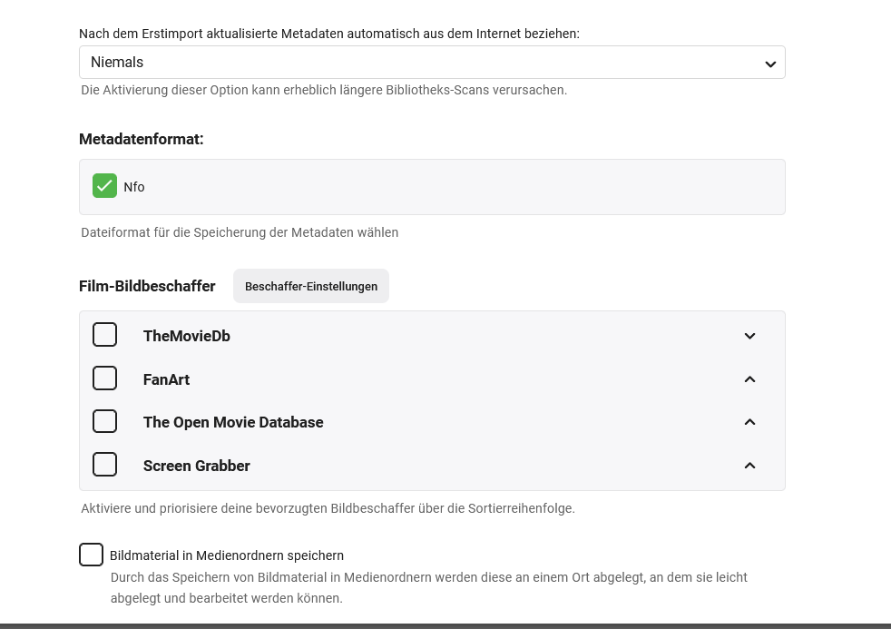

Romek123 42 Posted March 25, 2022 Author Posted March 25, 2022 I just tested this. deleted the movie-set with TinyMedia Manager for Star Trek 1 movie than i updated library in emby and after some time this movie had no movie-set as it should than i added this movie in emby to the star trek collection and updated library again it removed collection again checked the nfo and there is only one line for set: <set/> so this did not help at all i made screenshot from my settings for this library (attachements)
Romek123 42 Posted March 25, 2022 Author Posted March 25, 2022 go to configuration on server there i go to library click on the ... for my movie library and here "Bilbiothek scannen" (rescan library i guess)

Romek123 42 Posted March 26, 2022 Author Posted March 26, 2022 (edited) Looks like its working now. i unmarked the: [ ] Nfo - Dateiformat für die Speicherung der Metadaten wählen. i rescanned library now 3x and custom collections are not gone well, i will montitor this for 1-2 days but it looks good for now ... Edited March 26, 2022 by Romek123

Romek123 42 Posted March 26, 2022 Author Posted March 26, 2022 (edited) ok it works now made yesterday different test colelctions and they did not get removed after several library rescans - i only unmarked this in movie library config: ------------------------------------------ Metadatenformat: Nfo [ ] Dateiformat für die Speicherung der Metadaten wählen ------------------------------------------ And for the TMM question: - no, emby does not save additional collections to NFO's too. I did not rescan this movies with TMM so TMM changed nothing and still emby removed them with a library rescan. - now i have unmarked saving to NFO's and it looks like EMBY saves this data somewhere on my NAS in his own folders - and it works Edited March 26, 2022 by Romek123

Happy2Play 9801 Posted March 26, 2022 Posted March 26, 2022 6 hours ago, Romek123 said: ok it works now made yesterday different test colelctions and they did not get removed after several library rescans - i only unmarked this in movie library config: ------------------------------------------ Metadatenformat: Nfo [ ] Choose a file format to store metadata ------------------------------------------ And for the TMM question: - no, emby does not save additional collections to NFO's too. I did not rescan this movies with TMM so TMM changed nothing and still emby removed them with a library rescan. - now i have unmarked saving to NFO's and it looks like EMBY saves this data somewhere on my NAS in his own folders - and it works No it is only saved in the database so if anything happens to that database the info is lost. But do not agree with the rest.
