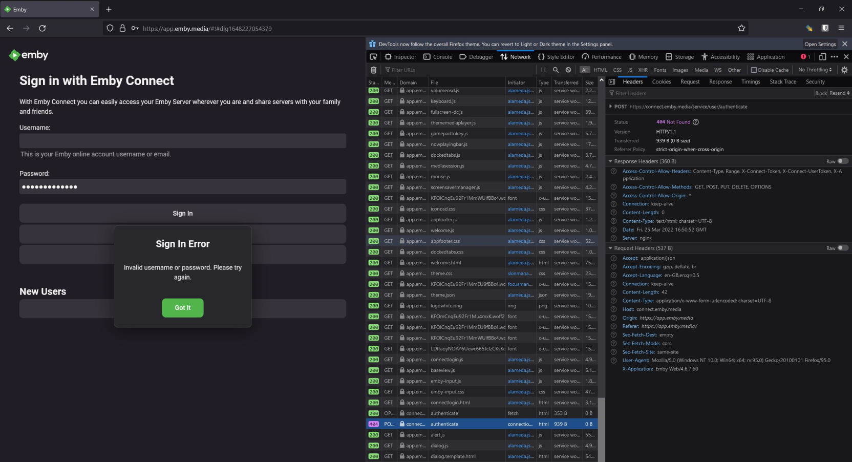

jonsaville 0 Posted March 25, 2022 Posted March 25, 2022 Sorry to pile on here, but I've been unable ever to sign in to app.emby.media. I can reset my password, which drops me into these forums. But when I try to login to "Sign in with Emby Connect" it always fails with a 404 when POSTing to https://connect.emby.media/service/user/authenticate Screencap is from Firefox, but same thing happens in Brave, Chrome etc. Tried reducing browser security level to no avail. My email address / username do not have any weird characters Hope you can help. I've got Emby Premiere via an iOS sub, but I'd really like to replace that with a direct sub and generally move forward. But can't do that if I can't sign in
pwhodges 2036 Posted March 26, 2022 Posted March 26, 2022 Have you tried deleting and re-making the link between your user on your server and your Connect user? Paul
Luke 42252 Posted March 26, 2022 Posted March 26, 2022 On 3/25/2022 at 1:04 PM, jonsaville said: Sorry to pile on here, but I've been unable ever to sign in to app.emby.media. I can reset my password, which drops me into these forums. But when I try to login to "Sign in with Emby Connect" it always fails with a 404 when POSTing to https://connect.emby.media/service/user/authenticate Screencap is from Firefox, but same thing happens in Brave, Chrome etc. Tried reducing browser security level to no avail. My email address / username do not have any weird characters Hope you can help. I've got Emby Premiere via an iOS sub, but I'd really like to replace that with a direct sub and generally move forward. But can't do that if I can't sign in What user are you trying to login with?
