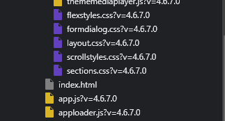

pir8radio 1313 Posted March 27, 2022 Posted March 27, 2022 12 hours ago, Skyfay said: What kind of errors are these, I can't find any on mine. I couldn't find any bugs using the web either. for example some of the emby files (app.js, apploader.js) use the path yourdomain.com/web/modules/app.js and others use yourdomain.com/emby/items so your second location block passes all traffic /app/ which would break these. So the html and scripts will be looking for yourdomain.com/web/..... not yourdomain.com/app/web/ since the html and js served from emby doesn't know /app/ exists, without you doing rewrites in nginx, those items should be broken. from outside of your lan. your first location block would work, since no sub directory in the proxy pass. so you are saying this works fine from your cell phone with wifi shut off?
Skyfay 19 Posted March 27, 2022 Author Posted March 27, 2022 6 hours ago, pir8radio said: for example some of the emby files (app.js, apploader.js) use the path yourdomain.com/web/modules/app.js and others use yourdomain.com/emby/items so your second location block passes all traffic /app/ which would break these. So the html and scripts will be looking for yourdomain.com/web/..... not yourdomain.com/app/web/ since the html and js served from emby doesn't know /app/ exists, without you doing rewrites in nginx, those items should be broken. from outside of your lan. your first location block would work, since no sub directory in the proxy pass. so you are saying this works fine from your cell phone with wifi shut off? The first server block is for all Emby apps, and the second is for the web. Since no sub directory is used for the first one, it works anyway. With the second one with the sub directory, I haven't been able to find any errors on the web so far, and google chrome doesn't show me any errors either.
