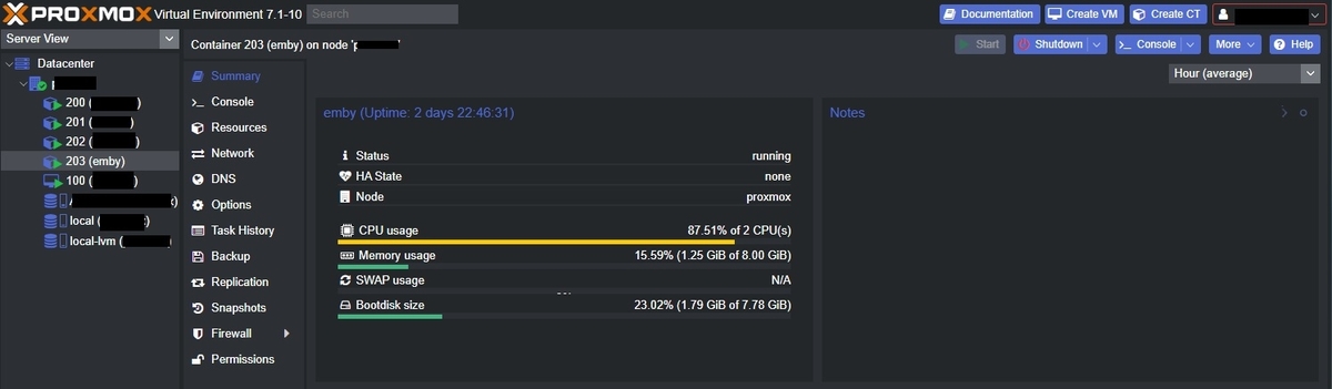

genuser 1 Posted March 18, 2022 Posted March 18, 2022 So far I am enjoying emby. I purchased a 1-month premiere to try all the features I can before deciding on the lifetime purchase. The way I have my emby server setup right now: Dell Poweredge R420 dual Xeon(R) CPU E5-2430 v2 192GB RAM total 8TB ssd storage in RAID10 ZFS 256GB SSD host os LVM = Proxmox7 Emby installed in a debian 11 lxc with currently 2 cores and 8GB RAM. I have tried as much as 8 cores (during testing). Emby detects when it "should" transcode files but the processors are not up to the task. In my research it appears to be linked to the processors not having/supporting intel quicksync. My next avenue of approach is to get an e-gpu setup for hw transcoding. I have everything setup the way I want it so I am trying to figure out a non-invasive way of making hw transcoding possible. With my lxc I can do gpu passthrough and the server itself has 2 x16 pcie gen3 slots. I will go the e-gpu route if I could find a gpu that both works with my server and emby. So, besides the e-gpu route, is there any possibility of emby being able to transcode reliably/efficiently with the existing processors?

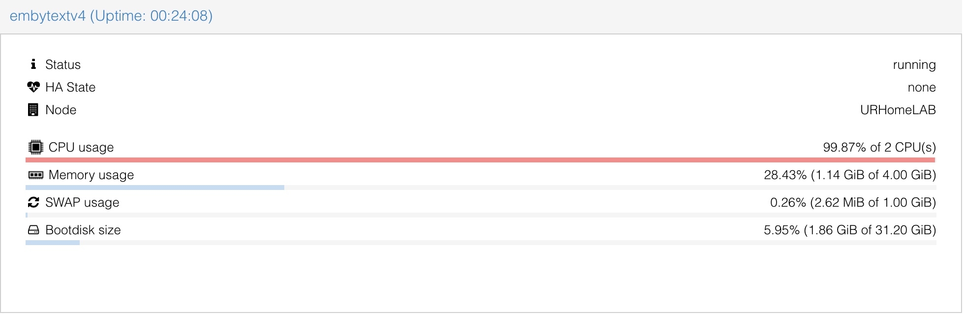

genuser 1 Posted March 18, 2022 Author Posted March 18, 2022 In the two screenshots, only 1 stream is active and being transcoded. It is being transcoded to an android client in the LAN (no access from public world). The cpu usage according to my proxmox host is really high for only 1 stream. Because I don't currently have a gpu for hw transcoding, the only options I have for transcoding in emby is yes, no, advanced and advanced doesn't see any hw capable devices. Even when I attempted to give the lxc 8 cores and 8GB RAM the cpu usage was still around this typically. I have been trying to figure out what settings to convert video files to so that the "weakest" device on the network can direct stream the file but I have come to see the usefulness and convenience of transcoding. For reference, the ID's on my host are 200's for lxc's and 100's for vms. The vm I have (router) is 1 core and 1GB RAM which barely sees significant cpu usage. The lxc's are 1 core 1GB RAM with 1 lxc having 4GB RAM (nfs/tftp/smb etc. server).

CassTG 113 Posted March 19, 2022 Posted March 19, 2022 (edited) So i just setup a Turnkey Debian CORE lxc container to see how it would run for ya Bare in mind this is a little Lenovo M900 Tiny box (local network) with a much weaker cpu by miles (6400T), i tried with 2 cpu and 4 cpu cores and turned OFF intel quicksync so just software transcoding. 2 Cores 1 Movie forced transcode = ave 90% Cpu usage 2 Movies forced transcode = ave 95% Cpu Usage 3 Movies forced Transcode = ave 99% Cpu usage 2 films transcoding played fine as soon as i put the 3rd into transcoding there was not enough resources so one film paused every now and then 4 Cores CPU usage was roughly the same 90-95% with some dips to 60% but 3 streams played fine on transcoding without stutters So the question would be how many transcodes are likely to happen versus cost of gpu solution Edited March 19, 2022 by CassTG
