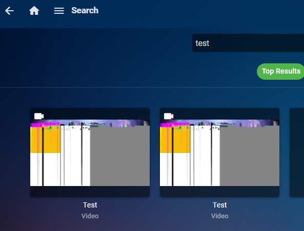

Teredactle 41 Posted March 31, 2022 Author Posted March 31, 2022 Yes, this is true, no way to really guess. For the library who this user's folders are subsets, I actually added the \\?\ before the X:\pictures of that main library because I was having issues with files with very long filenames (max length in Win). So, well Emby sees that top level library as a different path so \\?\x:\pictures is different than x:\pictures which then, for subfolders/subsetsof of x:\pictures like x:\pictures\may, x:\pictures\june, are no longer seen as subsets of \\?\x:\pictures So, for me I solved 2 issues at the same time - so, pretty happy about that! Would this be an accurate statement as a workaround to get the features to work that would otherwise not work when using subsets? If you want a library with subsets from another, make that other (top level) library use \\?\. Solves the issue for Windows users (I guess) at least and I don't believe there is any negative side effect (even if you don't have issues with long filenames).
Happy2Play 9814 Posted March 31, 2022 Posted March 31, 2022 8 minutes ago, Teredactle said: Yes, this is true, no way to really guess. For the library who this user's folders are subsets, I actually added the \\?\ before the X:\pictures of that main library because I was having issues with files with very long filenames (max length in Win). So, well Emby sees that top level library as a different path so \\?\x:\pictures is different than x:\pictures which then, for subfolders/subsetsof of x:\pictures like x:\pictures\may, x:\pictures\june, are no longer seen as subsets of \\?\x:\pictures So, for me I solved 2 issues at the same time - so, pretty happy about that! Would this be an accurate statement as a workaround to get the features to work that would otherwise not work when using subsets? If you want a library with subsets from another, make that other (top level) library use \\?\. Solves the issue for Windows users (I guess) at least and I don't believe there is any negative side effect (even if you don't have issues with long filenames). I can sort of see how this would fake Emby as they are two different paths methods. But you will have duplicate via the two paths a everything will be in "Picture" then you have the duplicated subset. \\?\X: is technically the same as X: But the written database paths would be different. Example with normal path and subsets the item path will alway equal x:\picture\may\any.jpg, but changing one path with \\?\ changes the database path to no longer make them match and technically create new items ids for each making them two different items. I would assume path vs network share would do the same thing also.
Teredactle 41 Posted April 1, 2022 Author Posted April 1, 2022 16 hours ago, Happy2Play said: I would assume path vs network share would do the same thing also. Can we get a confirmation from @Luke on this?
Luke 42289 Posted April 1, 2022 Posted April 1, 2022 Yes that would duplicate everything in the manner he's describing.
