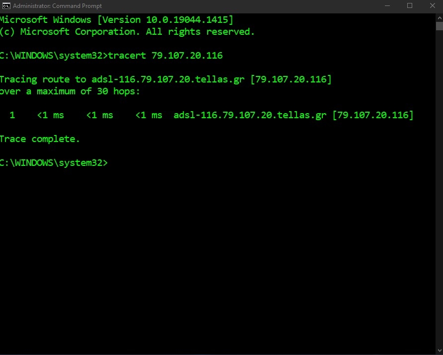

FancyNerd92 9 Posted March 16, 2022 Posted March 16, 2022 Hello, i have a problem with Emby Remote I'm getting an error This site can’t be reached. But fist of all I'll start with my router setup. I have for main router an Asus RT-AX88U in LAN AiMesh with other 4 Asus routers RT-AC68U. THe main router is connected in LAN1 on my provider modem/router ZYXEL VMG8623-T50B because of VoIP (they don't provide SIP Accounts so I'm stuck with them...). After a Googling i found that maybe my problem is CG NAT, so i tested in cmd "tracert <<192.168.my.ip>>" and my data is this: After that I call my provider and I said them to deactivate my CG NAT but they said to me I have not. So I tried to connect my Windows machine direct to ZYXEL VMG8623-T50B and not through Asus RT-AX88U. After that I was able to get in on Emby Remote and i was run another test and I get this: So I haven't CG NAT in my connection but I'm guessing something is going on with ZYXEL VMG8623-T50B. I want your help because I don't know what is the problem and what I can do about it. Thanks!

Carlo 4561 Posted March 16, 2022 Posted March 16, 2022 5 hours ago, FancyNerd92 said: Do you know what the 192.168.50.1 address is? Was that the computer you plugged directly in? If it was then it looks clean. Keep in mind if you have two routers in place you could be causing your own double NAT. You either need to set the first router in bridge mode (no routing, no NAT, no anything) plugged directly into the 2nd router which now is in charge and does NAT/routing/firewall, etc or You have to setup port forwarding on the 1st router pointing to the 2nd router. Then on the 2nd router you setup port forwarding to your Emby Server. See if that helps, Carlo 1
