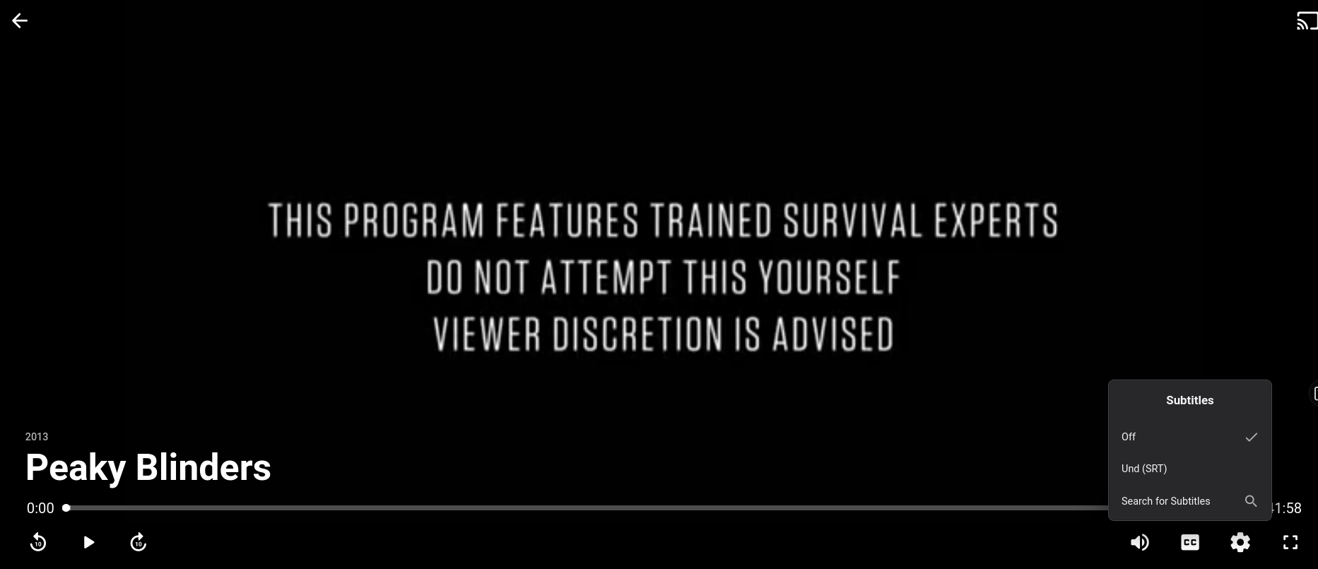

If srt still not shows up, please check if srt's are offered on Emby's WebUI playerback. As mentioned, they must be available there, otherwise it's still an issue on Emby server.
Edited by quickmic
quickmic
Similar for episodes
SRT Available in Emby Server Player (Browser and Emby Tv App) . But Not available in Emby for Kodi. I tried everything reset/Reinstall the Add on everything.
