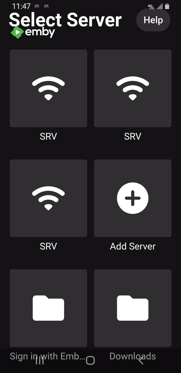

dadofhgnadn 14 Posted March 14, 2022 Posted March 14, 2022 (edited) After a system failure I reloaded Emby and named the Server the same (SRV). Now when I create a new user or an existing user logs in they are presented with the server name (SRV) twice. This creates much confusion and results in the correct server being chosen incorrectly half the time. Is there a way to decommission the incorrect server? Edited March 14, 2022 by dadofhgnadn Image

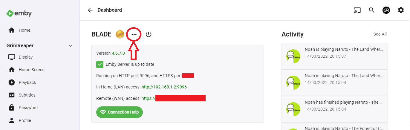

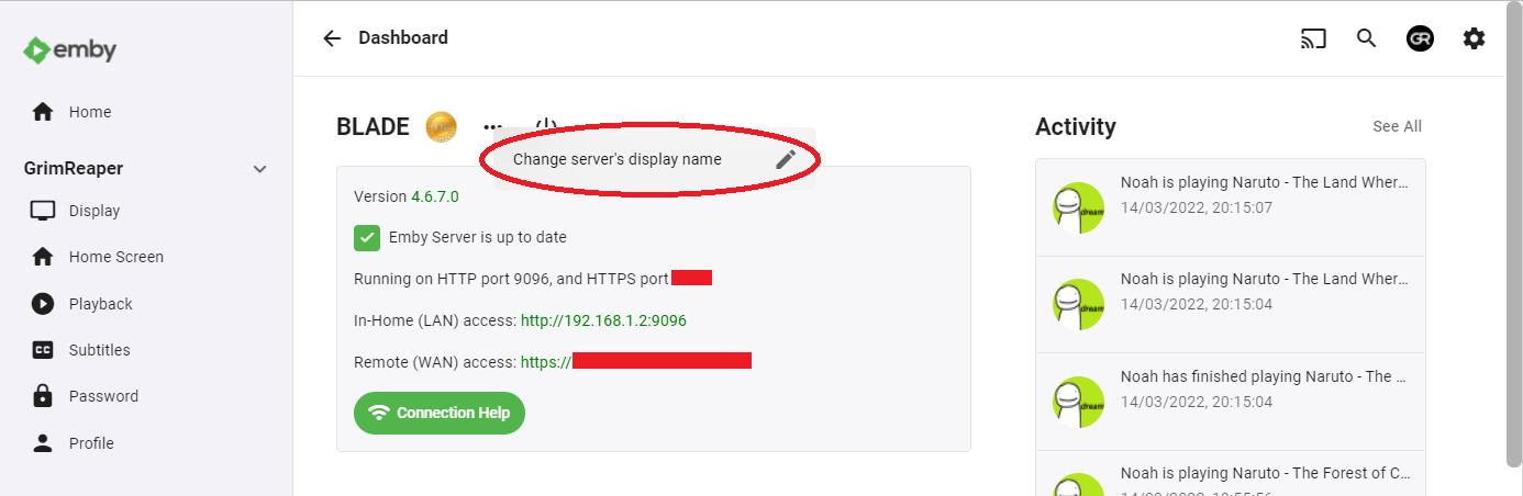

GrimReaper 5207 Posted March 14, 2022 Posted March 14, 2022 First, you should rename your new server to something else, so they'll be easier to distinct, like SRV (New). Next, each user must Forget/Delete SRV server from their server list by three-dot menu/long-press (depending on the client app used).
dadofhgnadn 14 Posted March 14, 2022 Author Posted March 14, 2022 (edited) Is there a procedure to rename the server? I would imagine that this would muck up those that have already successfully logged in to the correct server. Thanks Edited March 14, 2022 by dadofhgnadn Those already logged in
Solution GrimReaper 5207 Posted March 14, 2022 Solution Posted March 14, 2022 (edited) 40 minutes ago, dadofhgnadn said: Is there a procedure to rename the server? I would imagine that this would muck up those that have already successfully logged in to the correct server. Thanks Edited March 14, 2022 by GrimReaper
Happy2Play 9840 Posted March 14, 2022 Posted March 14, 2022 I had the same issue with multiple portable test systems on the same machine until I applied a custom name instead of hostname for all servers. But cannot say how log it takes to update the currently cached select server list. 1
Luke 43424 Posted March 14, 2022 Posted March 14, 2022 That is only the display name and won't impact connectivity. 1
Happy2Play 9840 Posted March 14, 2022 Posted March 14, 2022 1 minute ago, Luke said: That is only the display name and won't impact connectivity. But will the Select Server list update with new name or does one have to remove and readd server?
Luke 43424 Posted March 14, 2022 Posted March 14, 2022 6 minutes ago, Happy2Play said: But will the Select Server list update with new name or does one have to remove and readd server? Not instantaneously but yes it will update. 1
