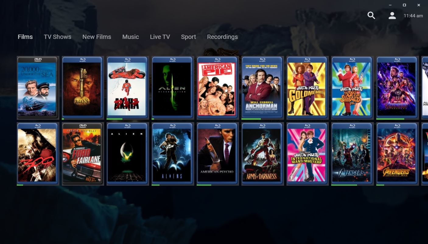

mitch2471 11 Posted March 12, 2022 Posted March 12, 2022 (edited) I’m running the latest version of Emby Server & Theater on a Windows 10 PC. When Emby Theater loads up this is what the home screen looks like. It’s like this for each of the category’s. I don’t seem to have the tiled display showing like the picture from the Emby website (see below). I have adjusted the home screen settings to show recently added, next up, etc but this does not seem to make any difference. Have I missed a setting somewhere or has Emby Theater moved on from the tiled home screen approach & that is no longer possible? Edited March 12, 2022 by mitch2471

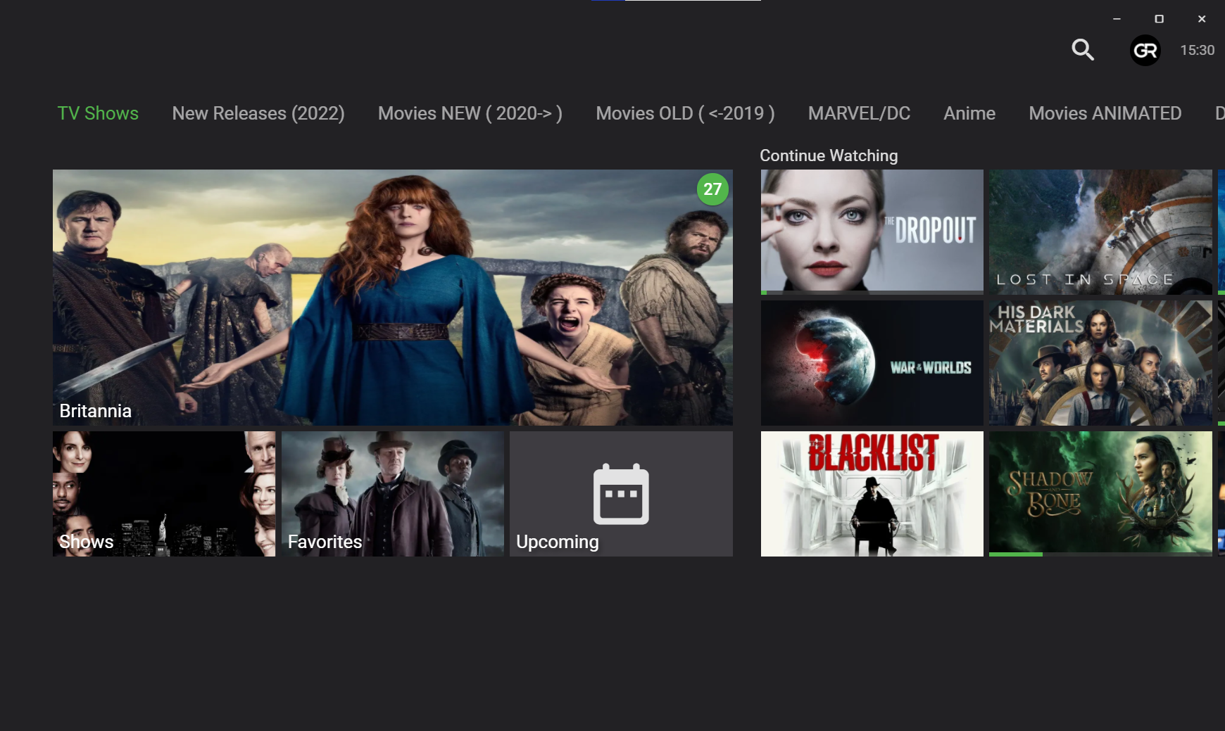

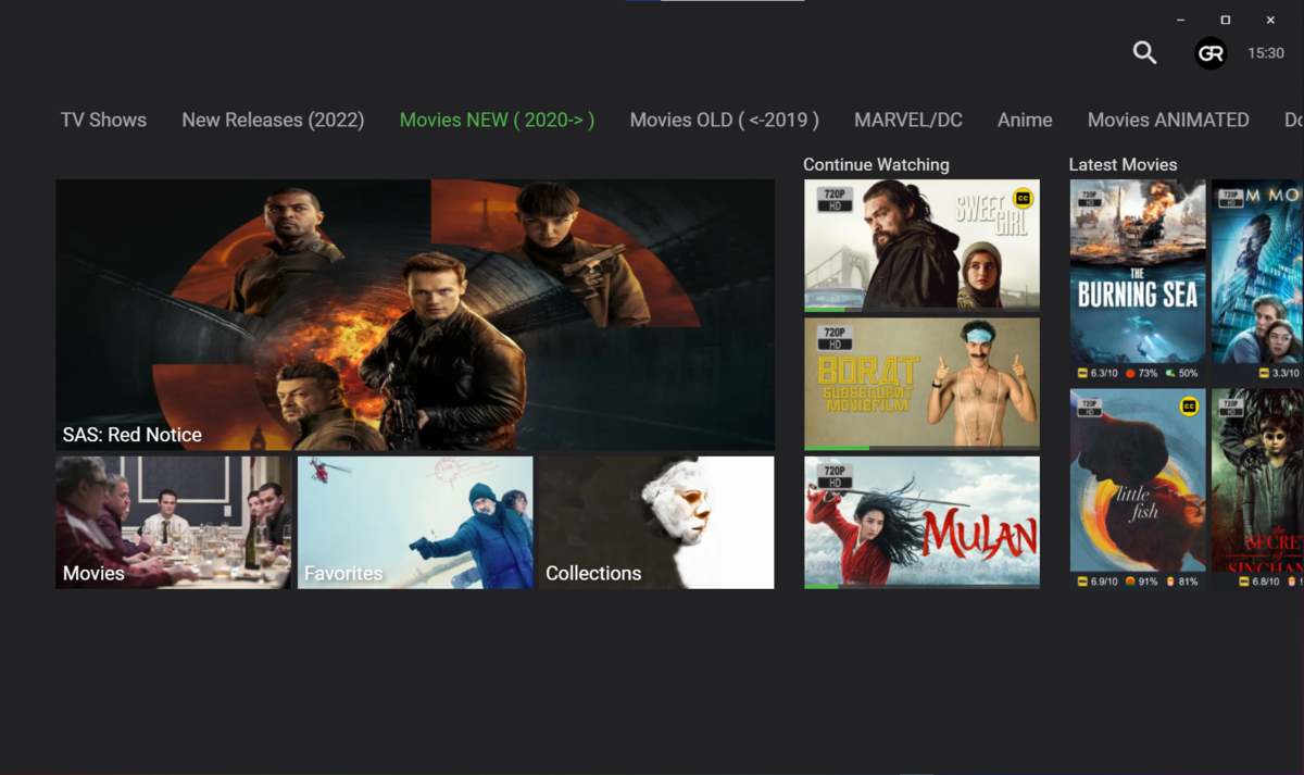

GrimReaper 4895 Posted March 13, 2022 Posted March 13, 2022 19 minutes ago, mitch2471 said: I have the display set to tv & home screen is set to horizontal. I can observe your behaviour only on Mixed-content type libraries (example: Documentaries library), as stated by @Happy2Play: For TV Show and Movie libraries, tiled view present: Are you positive your libraries did not auto-change to Mixed content, as it was known to happen in certain scenarios upon upgrade? Can you share a screenshot of your Settings>Library tab?
