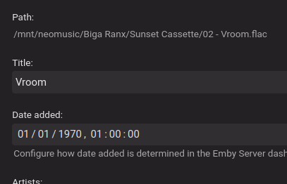

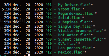

ryancey 56 Posted March 10, 2022 Author Posted March 10, 2022 33 minutes ago, Happy2Play said: Metadata is written with media or only in the database only images can be saved to custom central location. Oh okay, I got confused by the help text under the form (Specify a custom location for downloaded artwork and metadata.). I thought metadata was saved too as a NFO in this custom location. An example with a random album in the metadata manager And on the disk And the setting is NOTE: when creating a new library, I didn't delete the previous one to prevent losing artworks (some of them I needed to manually upload), so the files were still somehow indexed in the database I guess, which might explain why it didn't read the creation date. If I should delete every library referencing the files, how to prevent losing the artworks that are saved in the custom location?
Happy2Play 9813 Posted March 10, 2022 Posted March 10, 2022 I am guessing that is not the actual file creation date on that platform, but do not know anything about that platform. I can say I do not see this issue on my Windows systems.
ryancey 56 Posted March 11, 2022 Author Posted March 11, 2022 8 hours ago, Happy2Play said: I am guessing that is not the actual file creation date on that platform, but do not know anything about that platform. I can say I do not see this issue on my Windows systems. The platform is Linux (official Emby in Docker image). The actual creation date is december 20, 2020. Is that a bug then?
Happy2Play 9813 Posted March 11, 2022 Posted March 11, 2022 9 minutes ago, ryancey said: The platform is Linux (official Emby in Docker image). The actual creation date is december 20, 2020. Is that a bug then? Would be a weird bug if it only affects you, but dev or someone more familiar with the platform will have to comment further.
Solution Luke 42246 Posted March 11, 2022 Solution Posted March 11, 2022 It could be that the .net runtime is unable to get the date created timestamp for your file system. If that's true then the next release of the server may help with this as it updates to a newer version.
