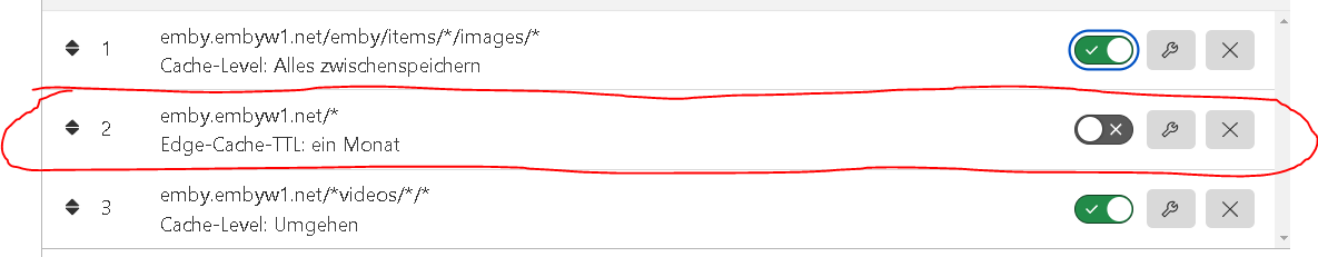

Solution Leinad86 6 Posted March 8, 2022 Author Solution Posted March 8, 2022 Hi, i found the problem. It was a page rule at Cloudflare. I must have messed things up when creating the other 2 rules. When I deactivated this rule, everything went immediately without any problems. No more loading symbol and all formats are played directly. Also have the secure connection is required activated again. Also tested with the stable version of the FireTV Stick. Everything is going great. Now let's see what the users say. Especially those who have the LG TVS. Thank you for your support 1
