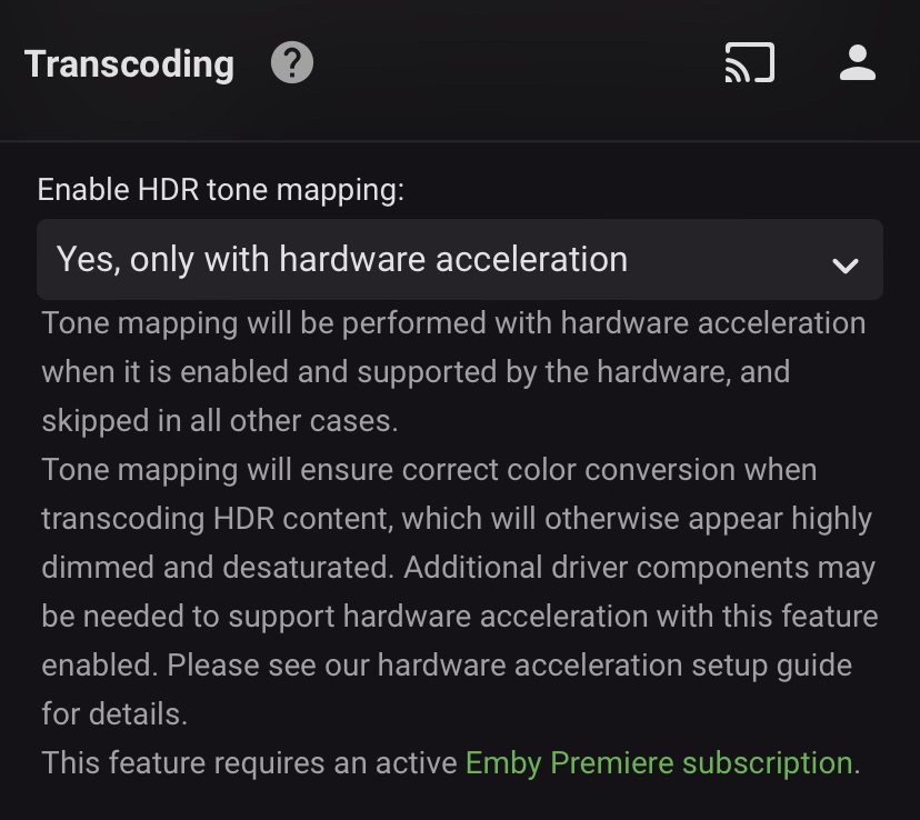

thunderclap 52 Posted March 7, 2022 Posted March 7, 2022 I run Emby on Unraid and am having a little trouble with HDR content. Generally speaking, HDR works as expected, however I've come across an issue with an older Roku Streaming Stick, the 3800X. The devices max resolution is 1080p and has no HDR support. Okay, not a big deal, because when a person with this device tries to watch a 4k HDR movie it transcodes to 1080p. However this is where the trouble starts: the tone mapping is wrong and the picture is washed out. I assume if the server is transcoding the 4k HDR content to 1080p it should be also be converting the HDR to SDR. Is this correct or am I mistaken? If it should be doing this then does anyone have any ideas how to correct it? Enable HDR tone mapping is enabled for hardware acceleration only, and I have QuickSync set as the preferred decoder/encoder under Advanced. Also, I have /dev/dri configured properly and working in Unraid. Any thoughts on the matter would be appreciated. Thanks.

Luke 42246 Posted March 7, 2022 Posted March 7, 2022 Hi @mbuhmann how have you configured the tone mapping option in Emby Server transcoding settings?
thunderclap 52 Posted March 7, 2022 Author Posted March 7, 2022 2 minutes ago, Luke said: Hi @mbuhmann how have you configured the tone mapping option in Emby Server transcoding settings? This setting? If so then yes.
