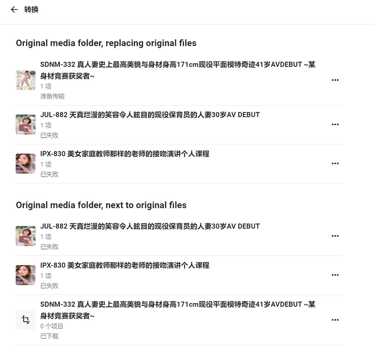

EliteOtaku 4 Posted March 6, 2022 Author Posted March 6, 2022 5 hours ago, FrostByte said: Did you also give Emby RW permissions at the file/folder level? Well, I tried to choose Original media folder, next to original files and this time it works....the compressed video file shows up in library. I did give Emby RW permissions at the folder, if I didn't, Emby should not be able to write, correct? This makes me confused. So I triey REPLACE option again with 2 different video files. Because I had updated from DSM6 to DSM7 last year and reinstalled Emby, I think this may cause the weird problem. I will try to reinstall Emby later if I am free to test. this is the one failed: IPX-830 magnet:?xt=urn:btih:5c60b859a1072717a6b02b0f939c853bb797655c&dn=%2B%2B%2B%20%5BHD%5D%20IPX-830%20%E7%BE%8E%E4%BA%BA%E5%AE%B6%E5%BA%AD%E6%95%99%E5%B8%AB%E3%81%82%E3%82%93%E3%81%AA%E5%85%88%E7%94%9F%E3%81%AE%E6%8E%A5%E5%90%BB%E3%83%AC%E3%82%AF%E3%83%81%E3%83%A3%E3%83%BC%E5%80%8B%E4%BA%BA%E3%83%AC%E3%83%83%E3%82%B9%E3%83%B3%20%E5%8A%A0%E7%BE%8E%E6%9D%8F%E5%A5%88&tr=http%3A%2F%2Fsukebei.tracker.wf%3A8888%2Fannounce&tr=udp%3A%2F%2Fopen.stealth.si%3A80%2Fannounce&tr=udp%3A%2F%2Ftracker.opentrackr.org%3A1337%2Fannounce&tr=udp%3A%2F%2Fexodus.desync.com%3A6969%2Fannounce&tr=udp%3A%2F%2Ftracker.torrent.eu.org%3A451%2Fannounce
