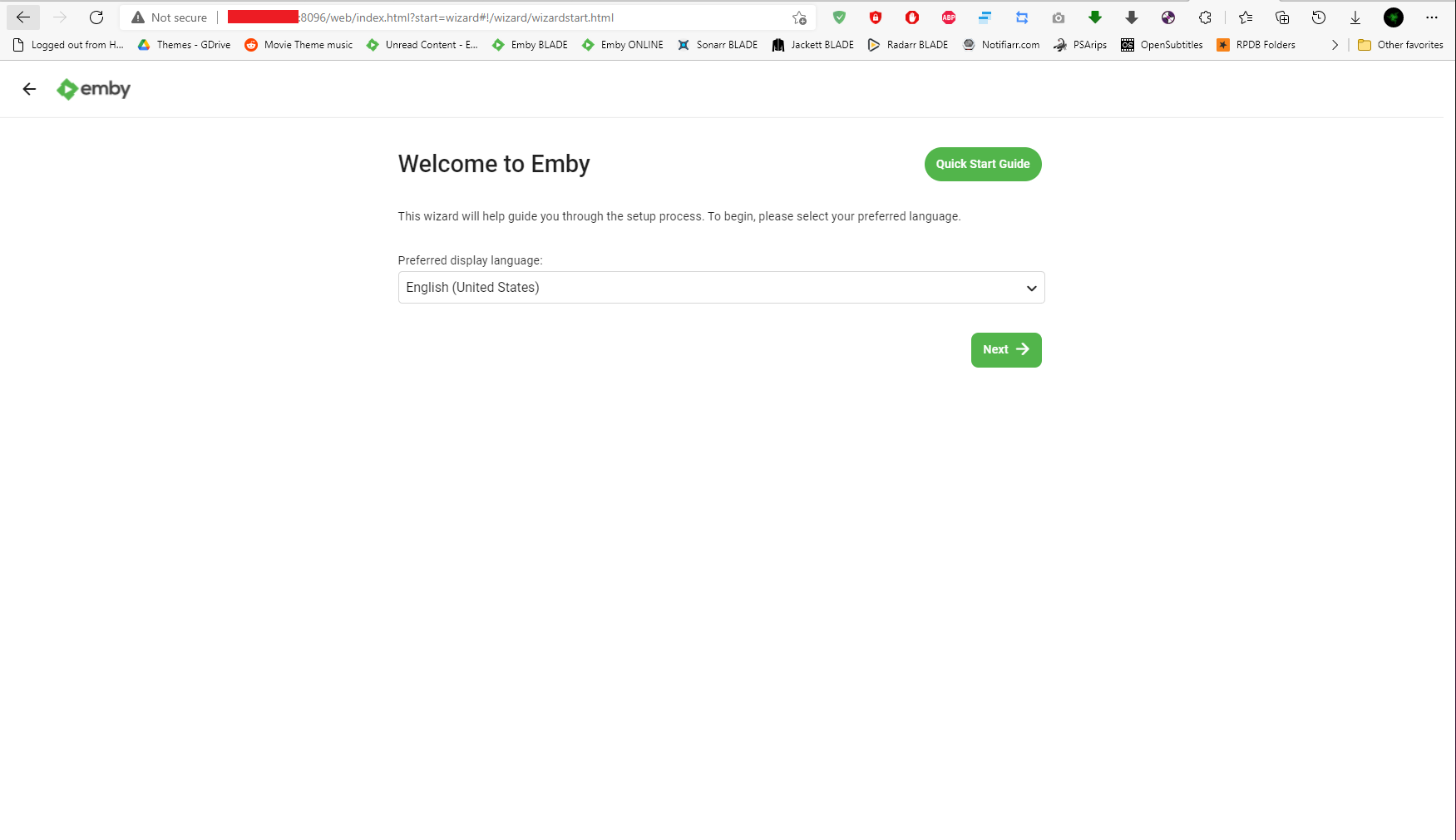

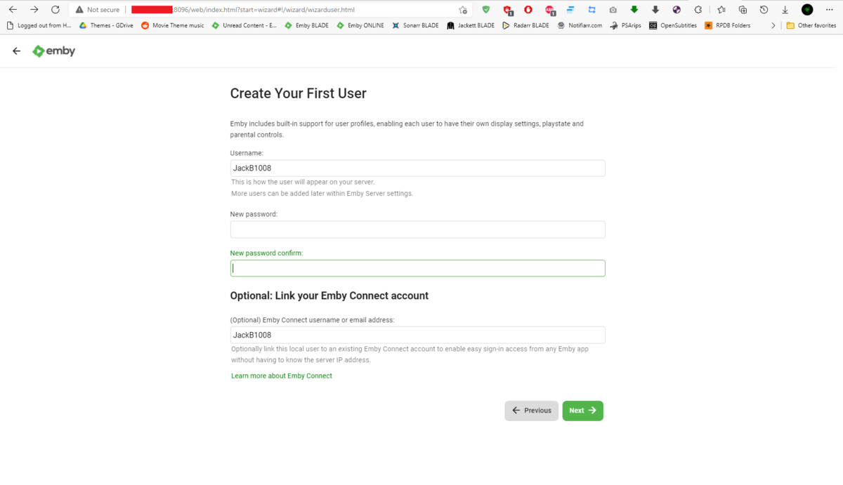

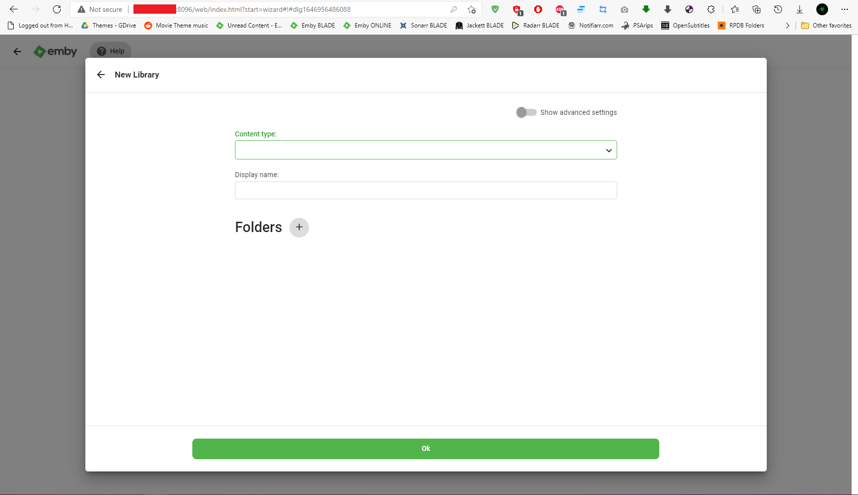

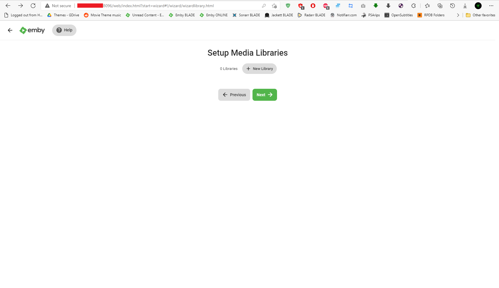

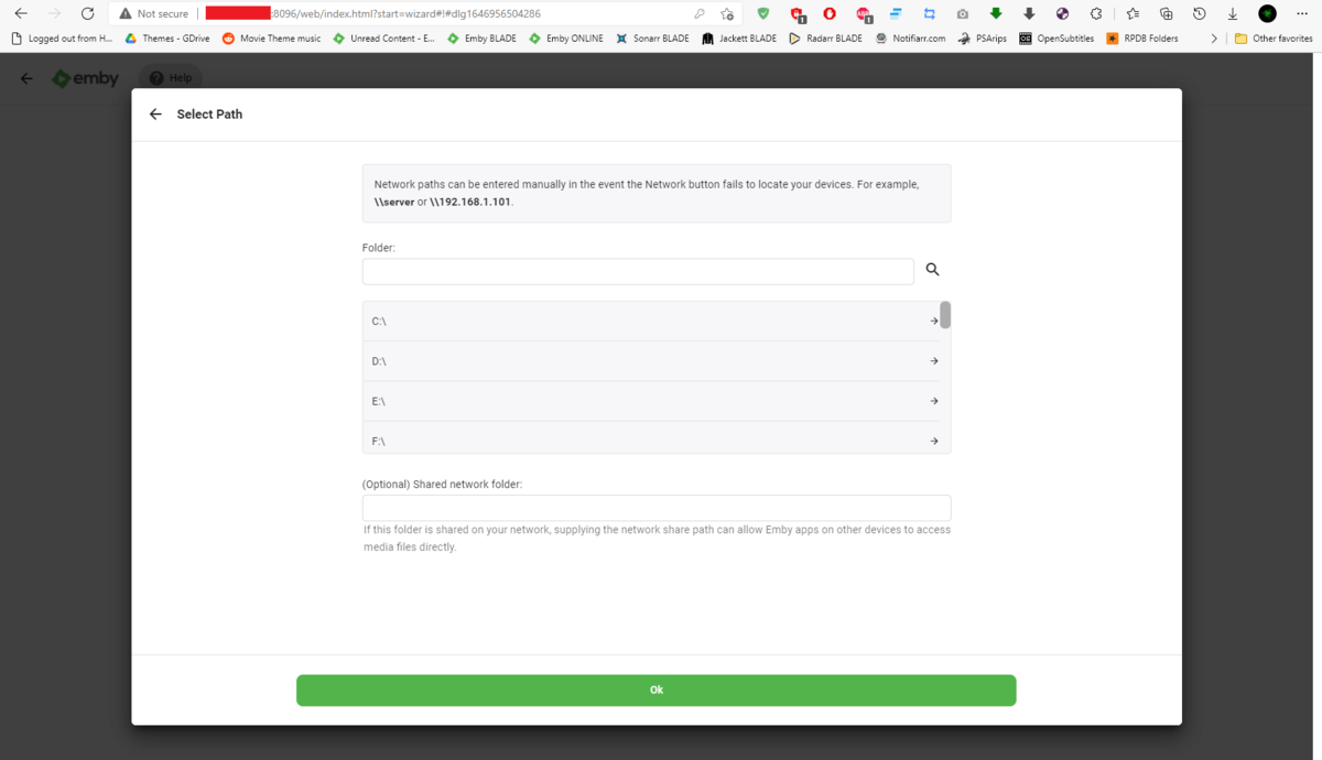

GrimReaper 4927 Posted March 11, 2022 Posted March 11, 2022 (edited) 33 minutes ago, probe47 said: I have tried repeatedly to set up the media server but using support article (https://support.emby.media/support/solutions/articles/44001159319-library-setup) which states to setup the media library click the button. I have tried all the buttons on the page and nothing happens. That is why I started this topic and have yet found an answer or a workaround to setup the media library. What everyone here (including myself) fails to realize is why can't you just connect to local IP:port and setup the server, and then setup all the other things (libraries, access, link to Connect account...) afterwards. That said, as @Happy2Play stated, you have left your server wide open for anyone to access/setup and practically hijack, as you have not completed Startup wizard. If I remote into your server, I can see wizard is still active and have no issues getting Library created: Edit: @Luke, maybe option to link Connect account/enable Port Mapper should be removed from startup wizard as that would force users to setup things locally (or at least complete startup wizard) before exposing themselves and potentially avoid these kind of situations? Atm OP's server is ripe for the picking, and lots of malicious folks in the wild. Edited March 11, 2022 by GrimReaper Append 1
