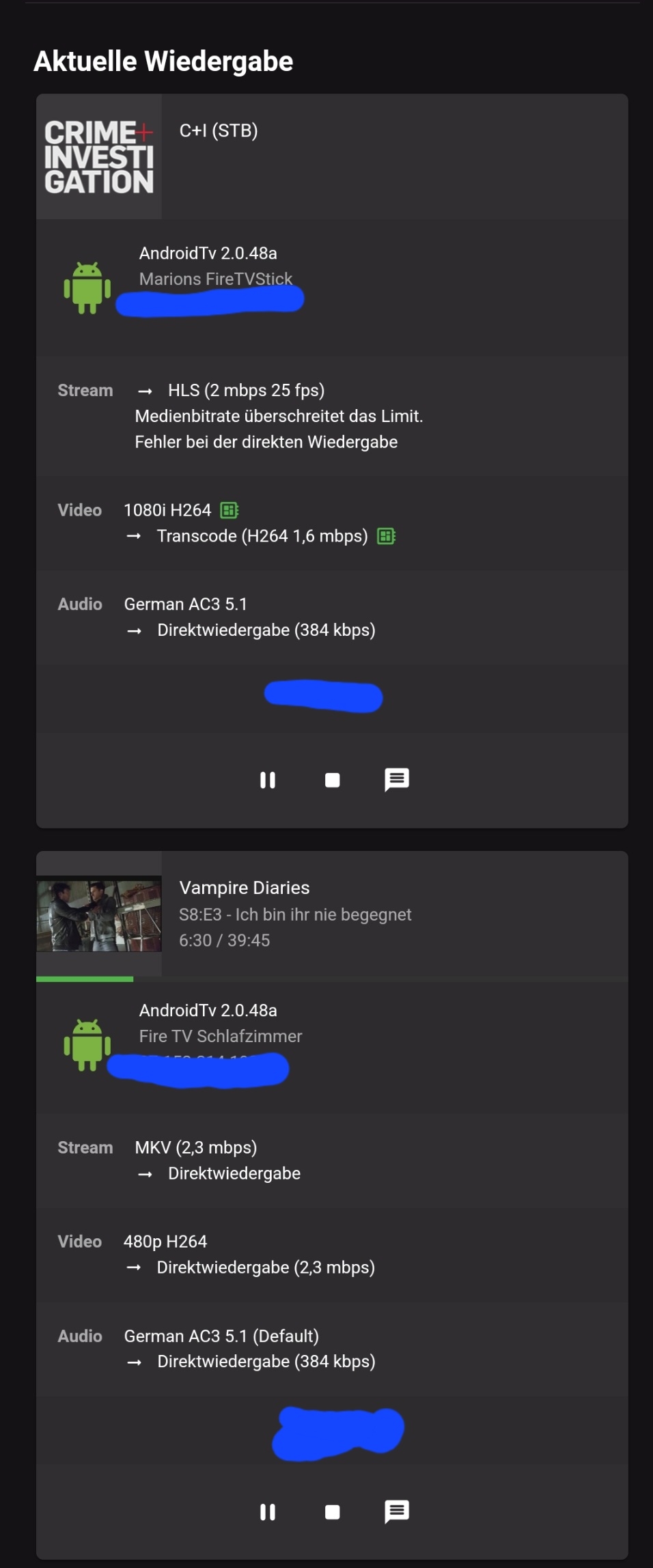

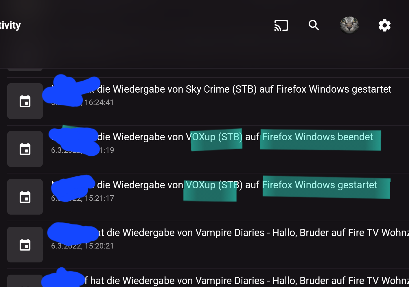

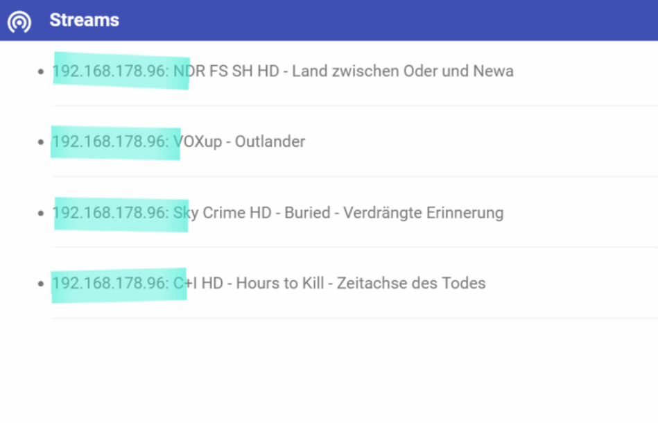

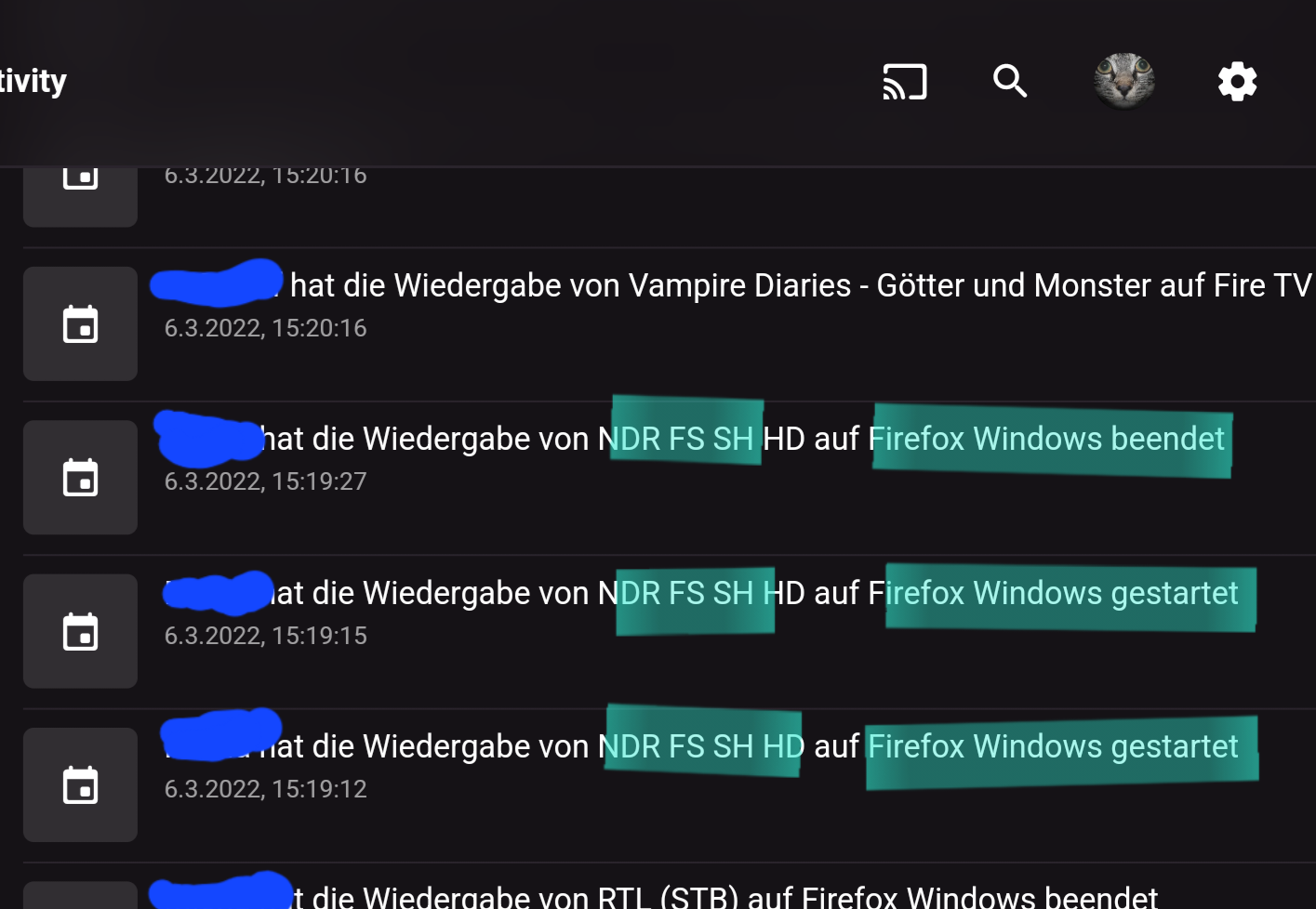

Svennie 4 Posted March 6, 2022 Author Posted March 6, 2022 Today it was definitely a web client that probably didn't end the streams even though they were no longer running on the server. The first picture shows the four streams that are currently being forwarded from the VU+ box to emby. The IP 192.168.178.96 is the emby server. The second picture shows the status for playback in the emby backend. Only one LiveTV channel is running here and a video is being streamed. The last two pictures show how the transmitters were started and stopped. However, one station started twice. For whatever reason. Spoiler
Luke 42241 Posted March 6, 2022 Posted March 6, 2022 Why do you think the station started twice? Is it just because of those activity messages?
Svennie 4 Posted March 6, 2022 Author Posted March 6, 2022 Spoiler You can see that in the third picture. The station is called "NDR FS SH". The station started twice but only ended once. The "VoxUP" station only started once, was terminated by the web client, but continues to run in the background and is no longer displayed in the emby backend.

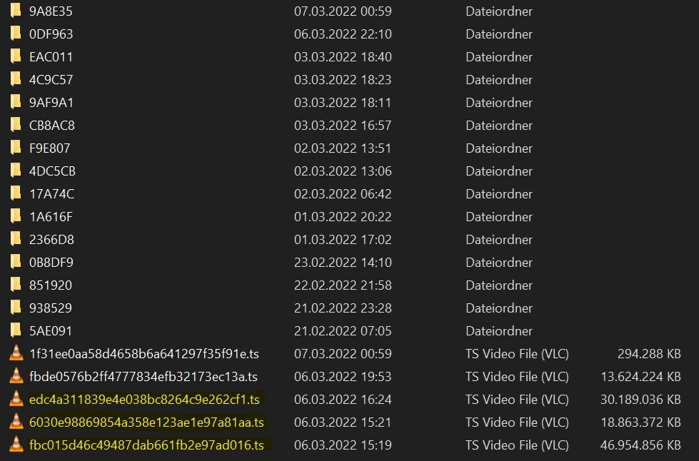

Svennie 4 Posted March 7, 2022 Author Posted March 7, 2022 (edited) I'm at home now and I've looked into the transcoding temp folder. I currently have 5 ts files there. 2 LiveTV channels are being watched and 3 channels are just running in the background, although the client is no longer switched on. The files in the temp folder are getting bigger and bigger. I have attached a picture of the folder. The files marked in yellow are the channels that are no longer watched. embyserver-63782208003.txt Edited March 7, 2022 by Svennie
