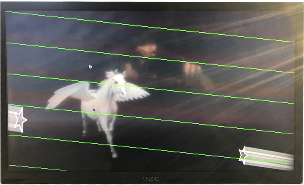

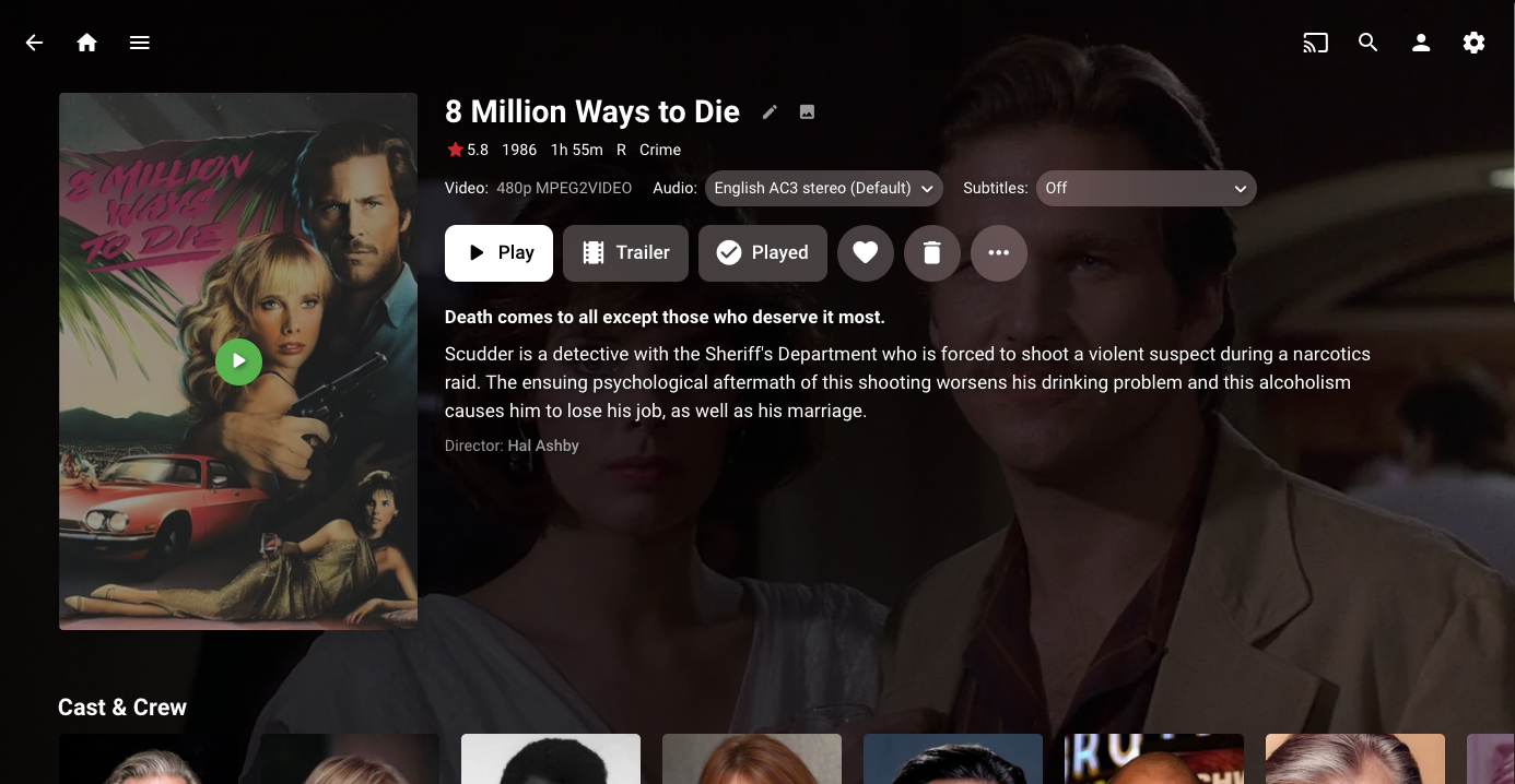

furiousp 2 Posted October 23, 2022 Posted October 23, 2022 Hello Emby Team, I have a similar issue with playback experiencing the diagonal green lines (mainly with) 480i &480p mpeg2 SD media. I've been following this topic, and have attempted fixes based on your suggestions yet the problem persists. Media originates on a dedicated Windows 10 server running via Emby Premiere version 4.7.8.0, I'm the only user. Playback is from a FireStick lite on a late model Vizio tv(I also have the same problem playing a firestick from an older Sony Bravia KDL65HX729 ) . I don't have the striping issue when the same media is played from a web browser or from my late model Sony smart tv w/ android o/s . Additional to the Emby logs attached & screengrabs, I've uploaded the firestick logs to you timestamped:1:49 EST-User: PJ Cilia. Thanks, any insights are appreciated. embyserver(1).txt
Luke 42244 Posted November 1, 2022 Posted November 1, 2022 On 10/23/2022 at 2:26 PM, furiousp said: Hello Emby Team, I have a similar issue with playback experiencing the diagonal green lines (mainly with) 480i &480p mpeg2 SD media. I've been following this topic, and have attempted fixes based on your suggestions yet the problem persists. Media originates on a dedicated Windows 10 server running via Emby Premiere version 4.7.8.0, I'm the only user. Playback is from a FireStick lite on a late model Vizio tv(I also have the same problem playing a firestick from an older Sony Bravia KDL65HX729 ) . I don't have the striping issue when the same media is played from a web browser or from my late model Sony smart tv w/ android o/s . Additional to the Emby logs attached & screengrabs, I've uploaded the firestick logs to you timestamped:1:49 EST-User: PJ Cilia. Thanks, any insights are appreciated. embyserver(1).txt 810.06 kB · 1 download Hi @furiousp have you tried with the new 2.0.83 app update? How does that compare?
softworkz 5133 Posted November 1, 2022 Posted November 1, 2022 @furiousp - If the app update doesn't help, please also post the ffmpeg logs. We need to see the resolutions of the videos that Emby sends to the Firestick client.

ebr 16337 Posted November 14, 2022 Posted November 14, 2022 I think we've determined that the Fire devices have trouble with odd resolutions. What is the exact resolution of the item with the issue?
ebr 16337 Posted November 14, 2022 Posted November 14, 2022 2 minutes ago, chowbok said: 720 × 416. Yeah, that would definitely count as an odd resolution. 1
