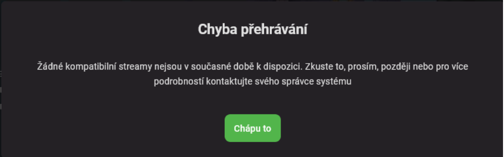

Houfino 41 Posted February 26, 2022 Posted February 26, 2022 (edited) Hi..I have a little problem..I wanted to start Underworld Evolution (2006).. I released the movie and error "Playback error " The others are OK...I don't know why it doesn't work...Thank you Emby version: 4.6.7.0 Synology: DS216play (DSM 7.0.1-42218 Update 2) I don't understand at all ... Where's the mistake? Will you have to explain to me why it doesn't work ... Due to the emby version update? Or? Thank you... embyserver.txt ffmpeg-transcode-a8af4020-0871-480d-8962-c7eb000df3d5_1.txt Edited March 4, 2022 by Houfino

Houfino 41 Posted February 28, 2022 Author Posted February 28, 2022 (edited) I found a solution where the problem..This is a much weirder program from Emby :-O ..Only the subtitles cause the problem !!!! Underworld.Evolution.2006.1080p.BrRip.x264.YIFY.sub Underworld.Evolution.2006.1080p.BrRip.x264.YIFY.srt SUB doesn't let go of the movie SRT releases the movie and OK Why doesn't the .sub work? The emby program is to blame. I did not understand at all .... I have been analyzing for 2 days and I have found a solution ...... Edited February 28, 2022 by Houfino
Houfino 41 Posted March 1, 2022 Author Posted March 1, 2022 Why does .sub subtitles not work ??? Emby does not support .sub ??? Bug???? Proof video here.... https://emalm.com/?v=KLKNS
