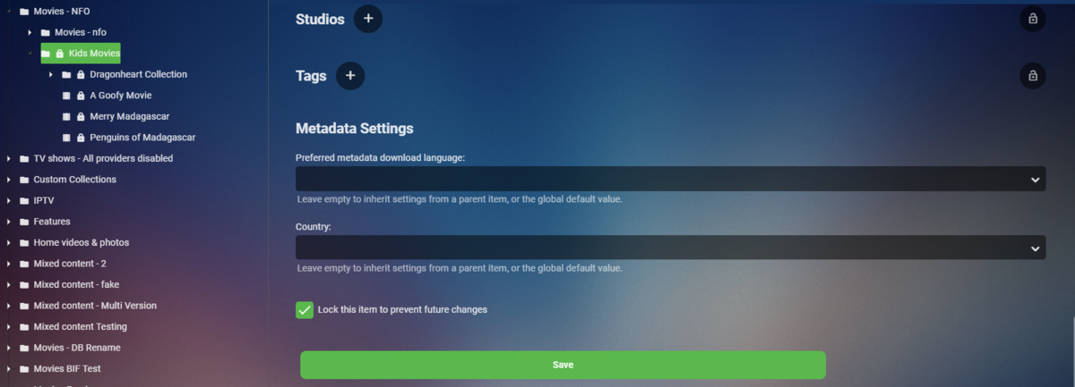

King Pin 34 Posted February 26, 2022 Posted February 26, 2022 Is there a secret button  somewhere so I can lock all my metadata in one fell swoop? Â
GrimReaper 4854 Posted February 26, 2022 Posted February 26, 2022 Are you saving NFOs with your media?

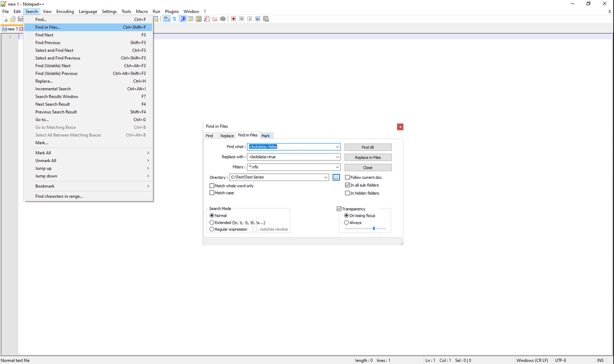

Solution GrimReaper 4854 Posted February 26, 2022 Solution Posted February 26, 2022 Use Notepad++ "Find in Files" on your Movies/TV Shows parent folder and replace all <lockdata>false  with <lockdata>true on all NFOs in one swoop. 1
Happy2Play 9801 Posted February 26, 2022 Posted February 26, 2022 Use to be able to do this via Metadata Manager on the library but it was removed at library level. Still exists at folder level so depending on your setup it could be possible. But there should be a method in the API also. 1
King Pin 34 Posted February 27, 2022 Author Posted February 27, 2022 (edited) 11 hours ago, GrimReaper said: Use Notepad++ "Find in Files" on your Movies/TV Shows parent folder and replace all <lockdata>false  with <lockdata>true on all NFOs in one swoop. That's awesome thank you! Worked perfectly.  Wil that also lock down my image art? Now when is the shuffle going to be fixed or reworked so I'm not watching the exact same tv episode all the time. LOL I was told a while ago that it was a known thing.  Edited February 27, 2022 by King Pin
