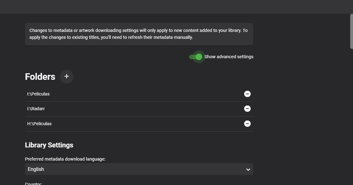

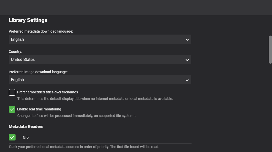

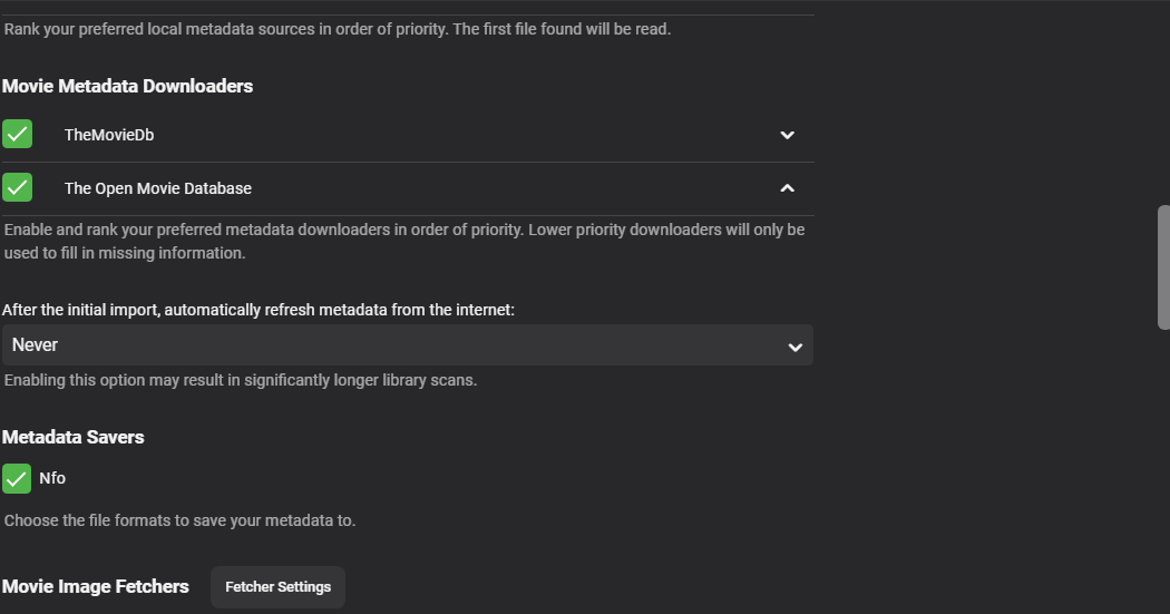

victor@vialy.com 9 Posted February 24, 2022 Posted February 24, 2022 I had to reinstall my Emby server. Everything works now, The Opensubtitles plugin works perfectly doing manual searches. But can't find where can I manage automatic subtitle downloading. It is supposed to be on library setup, but it is not visible there.
Happy2Play 9801 Posted February 24, 2022 Posted February 24, 2022 What client and server version? As it exists between Video Preview Thumbnails and Playback per library.
victor@vialy.com 9 Posted February 25, 2022 Author Posted February 25, 2022 3 hours ago, Happy2Play said: What client and server version? As it exists between Video Preview Thumbnails and Playback per library. EMBY SERVER 4.6.7.0 running on Windows 7 64 Bits Tried on Chrome and Edge remotely. Then tried on localhost with chrome, and it showed up. So, I dont have problems now. But it is strange.
Happy2Play 9801 Posted February 25, 2022 Posted February 25, 2022 Not sure as I currently don't have a Windows 7 system to test on but cannot replicate on Windows 10 remote browser session. Are there browser console errors when you navigate to that location in your remote connection?
victor@vialy.com 9 Posted February 25, 2022 Author Posted February 25, 2022 No. Everything looks as the screenshots I attached in the first post.

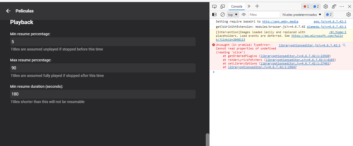

FrostByte 5433 Posted February 25, 2022 Posted February 25, 2022 I believe H2P was talking about the browser console. In Edge you type CTRL+SHIFT+J to bring it up and show any errors.
victor@vialy.com 9 Posted February 26, 2022 Author Posted February 26, 2022 Oh. Sorry. Yes, there are errors in the console. Also, Automatic downloading is not working. Just manual. I attach the server log where I first tried to execute the task, and then I had to perform a manual subtitle search and download. embyserver.txt

Luke 42186 Posted March 5, 2022 Posted March 5, 2022 Hi, I'm not sure why the hosted web app is not showing the options for 4.6 servers, but it will all be resolved in the coming days when 4.7 is released. Thanks.
