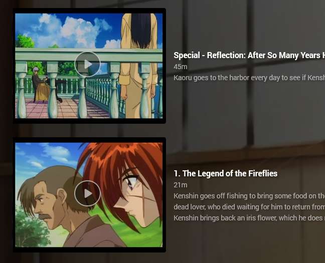

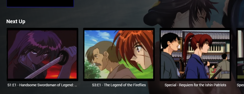

Revenent 15 Posted February 24, 2022 Posted February 24, 2022 Hi folks, Seeing the same issue as the following thread: But since I don't want to recreate the library and fix a bunch of naming issues, I did a little troubleshooting, and found that even though none of the episodes have a Sort Title, it seems to be using the Title as the Sort Title. However, when I go and manually add and remove a Sort Title (basically add "A" and then remove it), the episodes start playing in the correct order. For example: The special is set to appear before episode 10000, but as you can see, it shows up before the first episode. If I go and modify the Sort Title for episode 1, the following happens: That season has a few specials, and that first special is supposed to play before episode 10, so now episode 1 is in the correct position. If I go and do the same to all the episodes, the correct ordering (in terms of episode ordering) is restored. Another symptom, episodes with the issue don't show up on the "Next Up" list. Continuing with the same series, I "fixed" 1x01 and 3x01, and this is what shows up in the list: As you can see, none of the other episodes show up. While I can go through all the episodes and "fix" the issue manually, is there something that can fix this automatically? I've tried refreshing the metadata (show level, season level, episode level), but it doesn't solve the issue. Thanks in advance!

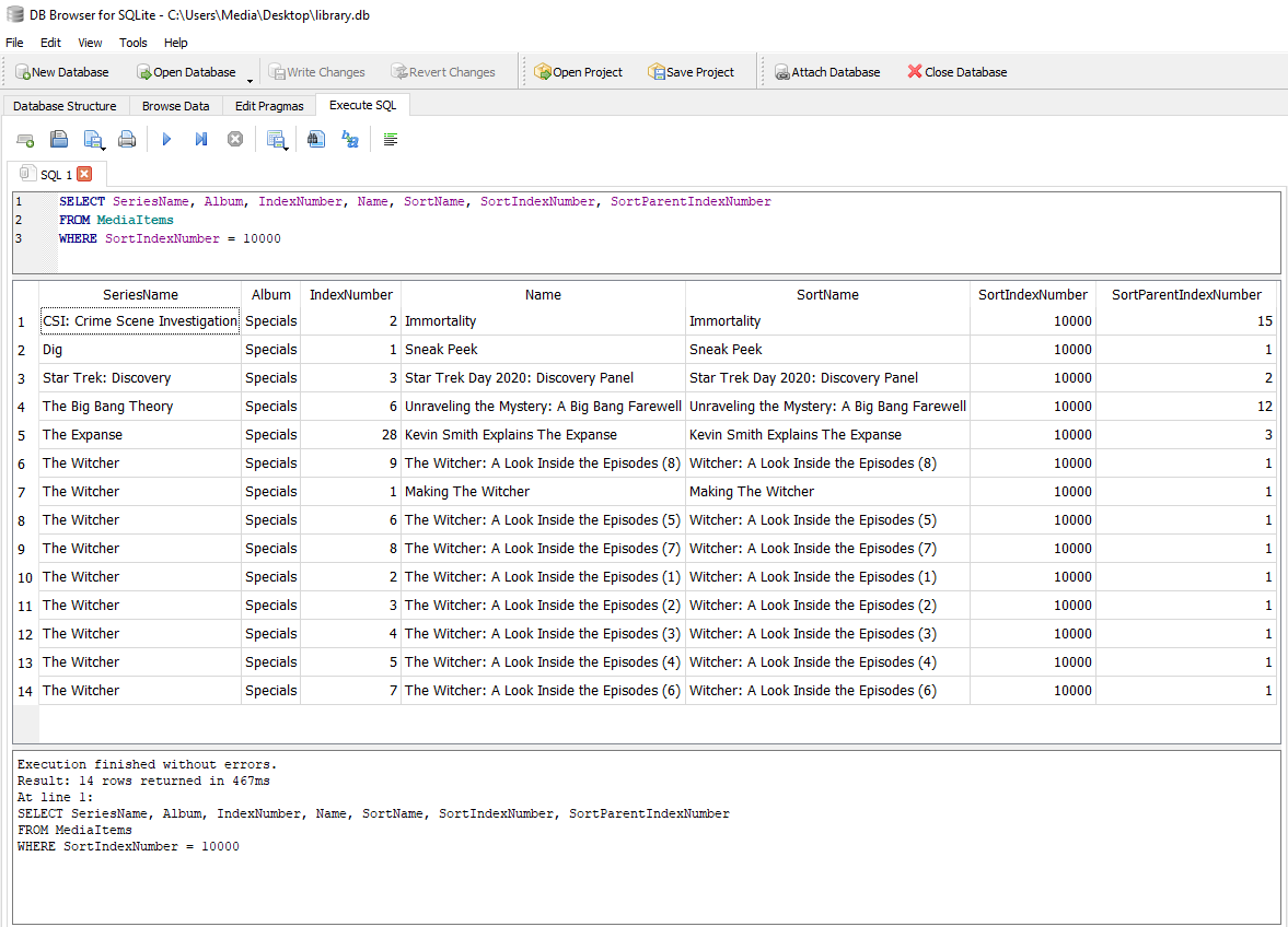

Revenent 15 Posted February 24, 2022 Author Posted February 24, 2022 (edited) OK, took a look at the DB itself. It seems like all the episodes that I haven't touched have a SortIndexNumber of 10000 and a SortParentIndexNumber of 0. The ones I have touched both have (NULL) in the field. Did the DB upgrade mess something up and set those fields to some default value? Edit: Specials seem to be hit as well - if the special had an airing season but not a before episode, it would stuff 10000 in the episode (which I assume maps to SortIndexNumber). Edited February 24, 2022 by Revenent

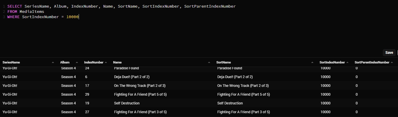

Revenent 15 Posted February 24, 2022 Author Posted February 24, 2022 Agreed, something definitely isn't right. The wonky thing is, normal episodes (i.e. non-special episodes) don't have the aired in season and before episode fields in the UX. So that means there is code that is reading in the fields, but when writing them back out, is doing validation and clearing out those fields. Here's some items in the DB that haven't been "fixed" yet: You can see, they're normal episodes (in the sense that they're not specials), but they have a SortIndexNumber and SortParentIndexNumber. When I look at the episodes in the Metadata Manager, it doesn't show the air before data.

Revenent 15 Posted February 24, 2022 Author Posted February 24, 2022 Yup, totally get that. Unfortunately, at some point, something added the airs before info to the normal episodes (as both you and I have pointed out, there is no UX in the website to add that data to normal episodes). Because of that, it breaks the next episode playing, since the server seems to take those values into account even for normal episodes. It also breaks other things, such as Next Up. The questions are now, how those values got there and who put them there? If there is no solution, I may just run the SQL UPDATE queries and fix the episodes directly in the DB.
