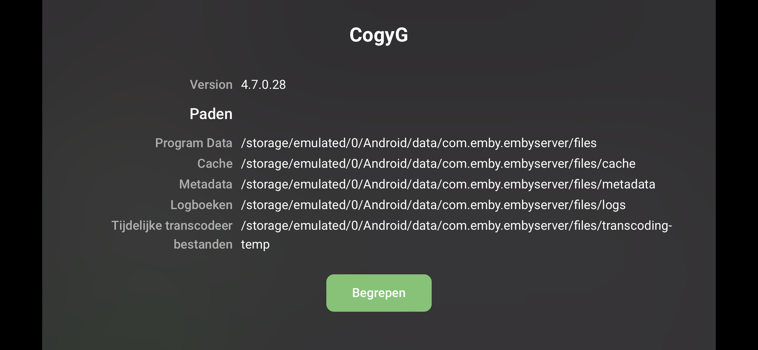

ebr 16332 Posted March 1, 2022 Posted March 1, 2022 Hi. Make sure you have gone into the permissions for the server app (Android Settings->Apps->Emby Server->Permissions) and enabled media and file access. System.UnauthorizedAccessException: System.UnauthorizedAccessException: Access to the path '/storage/COGYG/homes/CogyG/Emby metadata-transcoding/cache/cache/temp/6dfb59968c2b4c7d8a4e310484327b91.jpg' Also make sure you have installed the server to the internal storage of the Shield (not attached or external storage).

ebr 16332 Posted March 2, 2022 Posted March 2, 2022 Hi. This error usually indicates that you have not installed the app to internal storage: CANNOT LINK EXECUTABLE "/data/user/0/com.emby.embyserver/files/ffmpeg/ffmpeg": library "libc++_shared.so" not found: needed by main executable Are you sure you did that?
CogyG 3 Posted March 2, 2022 Author Posted March 2, 2022 28 minutes ago, ebr said: Hi. This error usually indicates that you have not installed the app to internal storage: CANNOT LINK EXECUTABLE "/data/user/0/com.emby.embyserver/files/ffmpeg/ffmpeg": library "libc++_shared.so" not found: needed by main executable Are you sure you did that? Yes is did. everything is installed on the shield
ebr 16332 Posted March 2, 2022 Posted March 2, 2022 And you went to Settings->Apps->EmbyServer->Permissions and turned on media and files? You may have to re-install the app after turning on that permission.
