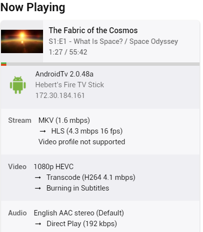

hbbs 8 Posted March 9, 2022 Posted March 9, 2022 I've tested the newest beta and it does work after you move it to internal storage But I've noticed another problem. Just like it's happening to Plex it seems that hardware transcoding isn't working. Back when Emby was starting to implement hardware transcoding I helped Emby devs to speed things up. It happens that I still have the files that I used to benchmark the transcoding speed and I'm only getting 17 fps which is most likely the culprit of all that freezing I'm getting now playing the same two old files on the same hardware I used back then. I've attached some logs and a picture I've taken from stats for nerds. Hope that helps @Luke embyserver (2).txt ffmpeg-transcode-d5d8488c-ef21-41cd-8125-e6e7c4d723b6_1.txt hardware_detection-63782386573.txt
Luke 42239 Posted March 9, 2022 Posted March 9, 2022 5 hours ago, hbbs said: I've tested the newest beta and it does work after you move it to internal storage But I've noticed another problem. Just like it's happening to Plex it seems that hardware transcoding isn't working. Back when Emby was starting to implement hardware transcoding I helped Emby devs to speed things up. It happens that I still have the files that I used to benchmark the transcoding speed and I'm only getting 17 fps which is most likely the culprit of all that freezing I'm getting now playing the same two old files on the same hardware I used back then. I've attached some logs and a picture I've taken from stats for nerds. Hope that helps @Luke embyserver (2).txt 982.46 kB · 0 downloads ffmpeg-transcode-d5d8488c-ef21-41cd-8125-e6e7c4d723b6_1.txt 911.94 kB · 1 download hardware_detection-63782386573.txt 137.9 kB · 0 downloads What about with other files?
hbbs 8 Posted March 9, 2022 Posted March 9, 2022 3 hours ago, Luke said: What about with other files? I've used now the two newest HEVC files that I have at my disposal. Logs attached embyserver.txt ffmpeg-transcode-fea97043-0792-4e1a-8ecf-55e35952b3a3_1.txt
Carlo 4561 Posted March 9, 2022 Posted March 9, 2022 1 hour ago, hbbs said: I've used now the two newest HEVC files that I have at my disposal. embyserver.txt 2.63 MB · 0 downloads ffmpeg-transcode-fea97043-0792-4e1a-8ecf-55e35952b3a3_1.txt 1.92 MB · 0 downloads Hi, I've not been able to to duplicate your results and would like to try it with the same media. Would you be able to provide this episode of The Wheel of Time for us to use testing? Does this only happen with media containing large amounts of subtitles? Just curious, looking at the logs it appears you running the server on a ShieldTV and storing files on a Raspberry Pi? <--The little NAS that could
hbbs 8 Posted March 9, 2022 Posted March 9, 2022 27 minutes ago, cayars said: Hi, I've not been able to to duplicate your results and would like to try it with the same media. Would you be able to provide this episode of The Wheel of Time for us to use testing? Does this only happen with media containing large amounts of subtitles? Just curious, looking at the logs it appears you running the server on a ShieldTV and storing files on a Raspberry Pi? <--The little NAS that could Sure. I just PM'd you with a link in order for you to download it. No. It is happening with other HEVC files with one subtitle. (I have attached a log with one case of that) About the RPi. Yes it serving me files all those years I have a USB HDD Case connect to it. embyserver.txt ffmpeg-transcode-14d41ff8-a8e6-4d10-a4b9-12355d0ad716_1.txt
