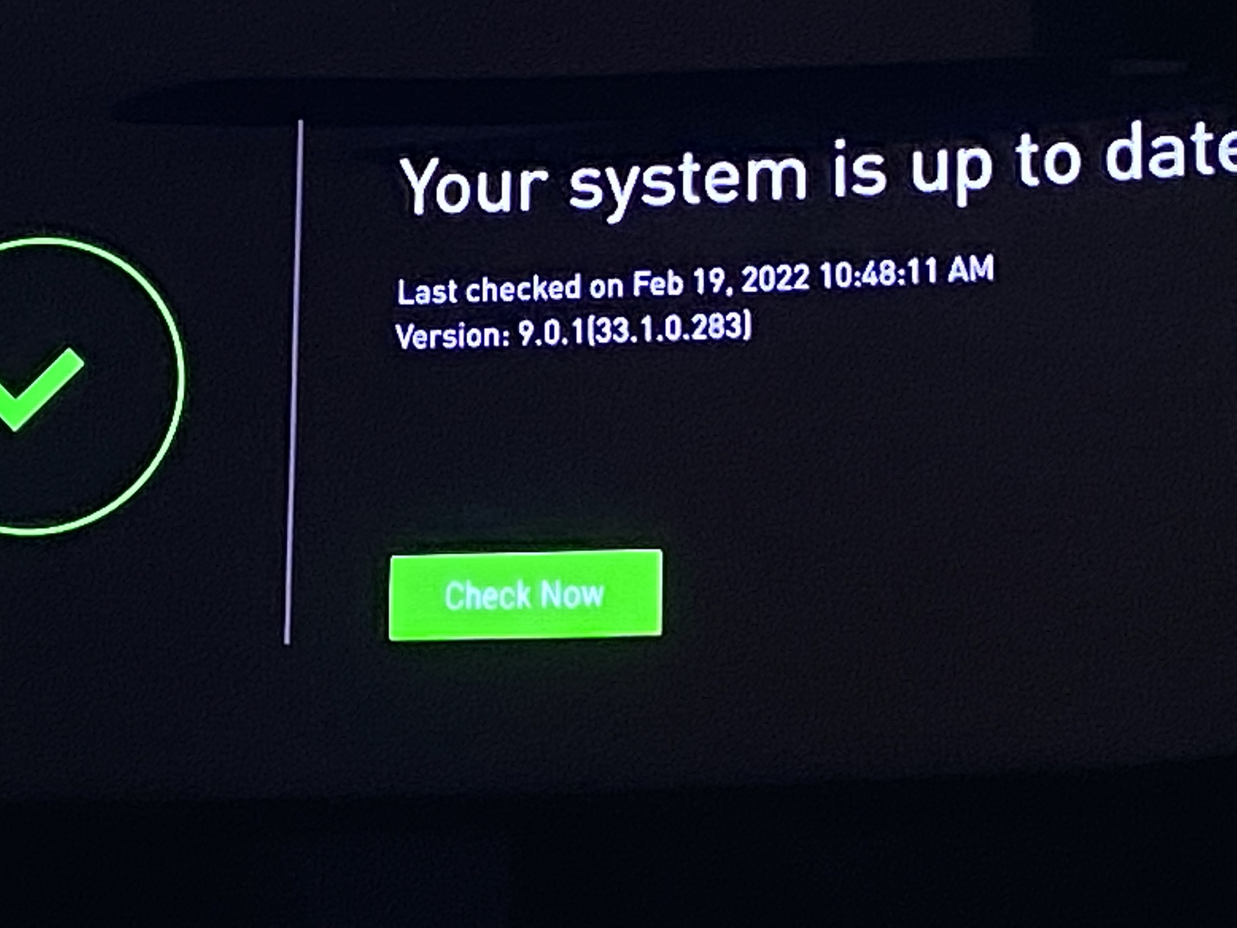

KenFlix21 0 Posted February 19, 2022 Posted February 19, 2022 Hello all, still new to Emby as I've had all kinds of problems since becoming a Premiere user. This particular issue has to do with Emby app not playing on Nvidia Shield-2019, two Samsung Tizen TVs (2016 & 2019) & Roku express. Although no problems playing on iPhone 11 and two Apple TVs. Emby server (4.6.7.0) running on Shield latest (9.0.1). Shield error says Too many errors giving up and proceeds to mark video as played. On Samsung the error is - Playback error, No compatible streams are currently available. What am I missing? Any ideas? Strange that Emby server runs on the Shield but won't play on the same shield but will play on an Apple device without issue. embyserver-2022.02.19.pdf
