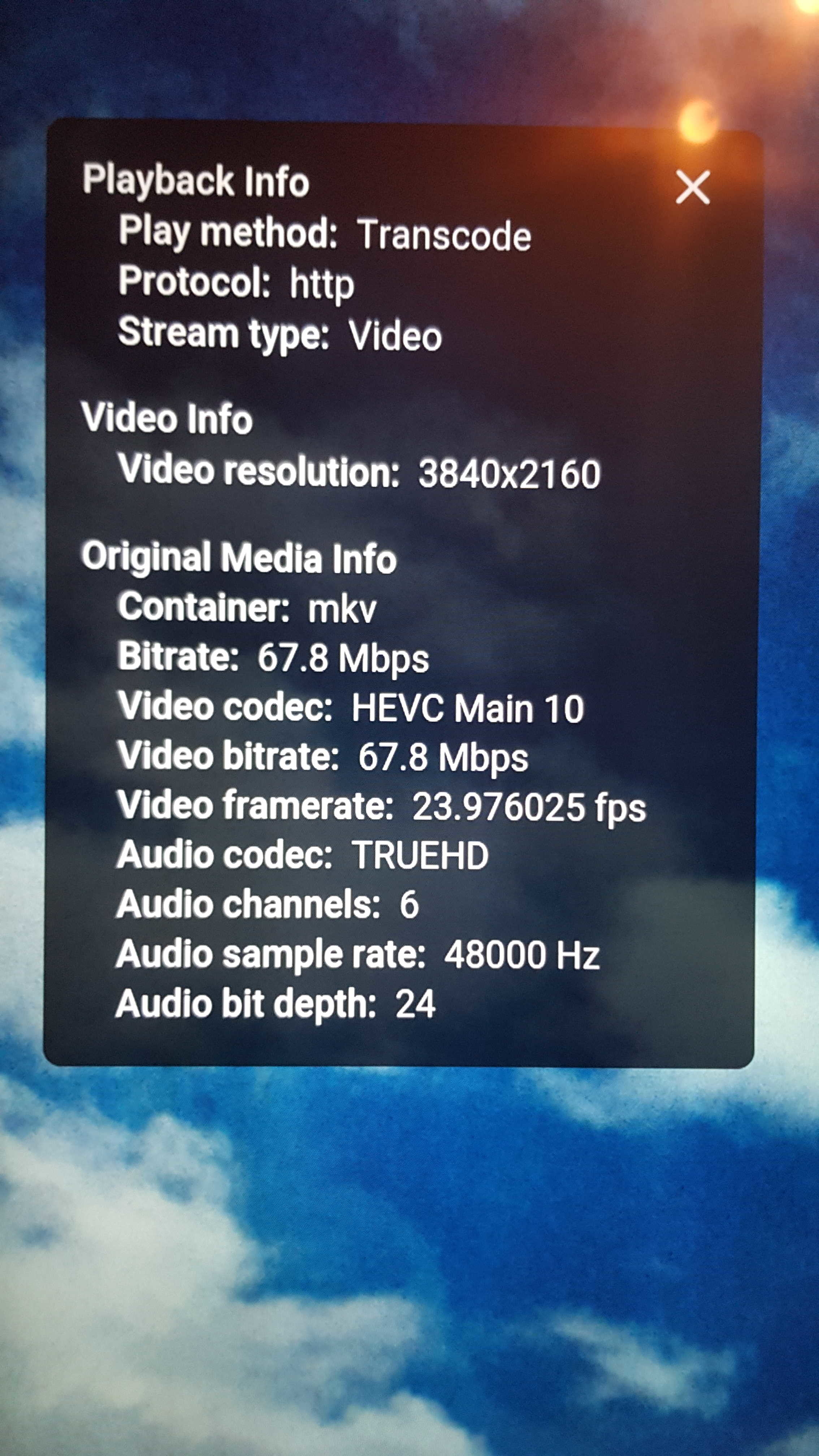

nanuk 36 Posted February 17, 2022 Posted February 17, 2022 (edited) Hi gacopl, hi Luke, I tested this with my 3 LG TVs (OLED65C7D, 55UJ6309 & 43UK6300LLB) all running with the new Emby App Version 1.0.33... with strange results. I tested with a 4K HDR UHD Remux (mkv) with TRUEHD Audio (no Subs activated). On my OLED everything looks like before (video direkt stream and audio encoding from TrueHD to AC3) -> see attachement (OLED.jpg) On the two other TVs the "Nerd Info" shows that the video is transcoding -> see attachement (NON-OLED.jpg) BUT indeed the Emby Server isn't encoding any of the 3... it only shows transcoding on 2 of the TVs in the "Nerd Info" Screen but isn't really encoding. All three TVs are showing a non transcoded video (HDR) only the Infos are different. Maybe it's just a display prob? emby_logs.zip Edited February 17, 2022 by nanuk

Luke 42237 Posted February 17, 2022 Posted February 17, 2022 Hi, there is no video transcoding occurring in any of these examples. It is stream copying the original video and only converting the audio.
nanuk 36 Posted February 17, 2022 Posted February 17, 2022 44 minutes ago, Luke said: Hi, there is no video transcoding occurring in any of these examples. It is stream copying the original video and only converting the audio. That's exactly what I told! "All three TVs are showing a non transcoded video (HDR) only the Infos are different." Only the Information shown in the OSD shows "transcode" although the video isn't being really transcoded.
Luke 42237 Posted February 17, 2022 Posted February 17, 2022 Maybe the stats feature is saying the wrong thing. We'll look into that, but I don't see any video transcoding in the examples you provided.
nanuk 36 Posted February 17, 2022 Posted February 17, 2022 2 minutes ago, Luke said: Maybe the stats feature is saying the wrong thing. We'll look into that, but I don't see any video transcoding in the examples you provided. Yes that's correct! I've never told anything else 1
