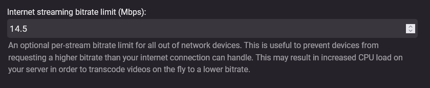

Mkilbride 86 Posted February 17, 2022 Posted February 17, 2022 (edited) So I've been having this issue for awhile. I have 18Mbps upload, so I set my out of network maximum bit-rate to 14.5Mbps. Despite this, Emby responds is weird ways. It will transcode a 9000Kbps 1080p movie to like 3.5Mbps when streaming it to a friend, it will say bit-rate limit exceeded, despite the fact it should not be. When I check the transcode log, it even says, bit-rate limit 14,500Kbps. Then there is this other issue. My friend attempted to stream a 4K Video file with a bit-rate of 64Mbps from me to their TV. It direct played for some reason, instead of transcoding. Obviously my 18Mbps connection could not support this. No matter what option she selected, it kept attempting to direct play. Even selecting the 1080p option in the quality setting did not stop it. What is even weirder, is that I have transcode logs for some reason. Despite it direct playing. I attached a few logs. ffmpeg-transcode-4c83f52a-32d4-482a-b524-21d5658dac84_1.txt ffmpeg-transcode-cc9cac02-f902-4759-9328-e36b3e8ae7e0_1.txt Watching in real time, I saw it going from "Transcoding due to bit-rate limit" to Direct Play, and then it started non-stop buffering for her because obviously I can't supply that bit-rate. ffmpeg-transcode-22e7a1a0-5904-4d3e-a004-8724419d0768_1.txt Edited February 17, 2022 by Mkilbride
Luke 42245 Posted February 17, 2022 Posted February 17, 2022 Hi, in all of these examples the app is requesting a bitrate well below your server-side upper limit. What this means is the user has configured a quality setting even lower, so that is the limit being exceeded. When you configure your limit server-side, you're not setting the user's quality setting, you're setting your own upper limit. The user will also set theirs, and the end result is something fits within both.
Mkilbride 86 Posted February 17, 2022 Author Posted February 17, 2022 Alright. So why isn't there a server wide option? It even describe s it as such it says *all clients outside of network*, makes one think that means other users, not just your own. An option for a universal would be good. Also, my friend didn't select any quality setting until I told her, and even then it tried to direct play despite the request to transcode.
Luke 42245 Posted February 17, 2022 Posted February 17, 2022 It is system wide for all out of network users, but it's an upper limit, not a specific quality value.
Mkilbride 86 Posted February 17, 2022 Author Posted February 17, 2022 Ok, but it's not being applied then. Because my friend is across the country, so out of network, yet it wants to direct play a 4k remux at full bit rate.
ebr 16337 Posted February 17, 2022 Posted February 17, 2022 2 hours ago, Mkilbride said: Ok, but it's not being applied then. Because my friend is across the country, so out of network, yet it wants to direct play a 4k remux at full bit rate. Hi. It is being applied but it is an upper limit, not a lower one. The user probably has their app set to "Auto" which tests the connection and then chooses a safe speed based on that test. You can try having them select a higher bitrate in the app but it is quite likely that will produce buffering or stuttering.

Mkilbride 86 Posted February 17, 2022 Author Posted February 17, 2022 (edited) I don't know, why does it? I set a bit-rate limit for Out of Network devices to 14Mbps. The file has a bit-rate of 64Mbps. Should it not automatically transcode it to a lower bit-rate? That's how it works for many other files. Why is a 4.5mbps bit-rate file remuxed for "exceeding bit-rate", when my cap is 14.5? As the description says itself - it should limit ALL out of Network devices to 14.5Mbps, and it says it will transcode videos on the fly to a lower bit-rate. But it's not. Edited February 17, 2022 by Mkilbride
