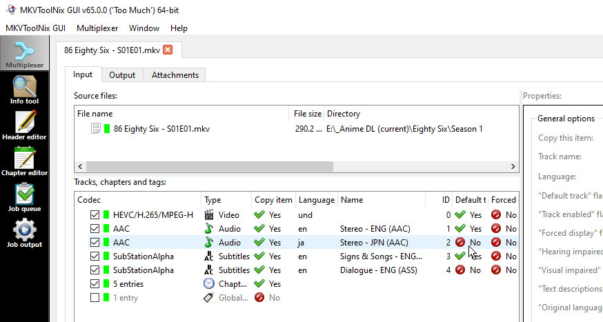

pwhodges 2033 Posted February 18, 2022 Posted February 18, 2022 Is this a case where both audio streams are marked as default in the file? Paul
DarKni8 41 Posted February 18, 2022 Author Posted February 18, 2022 2 minutes ago, pwhodges said: Is this a case where both audio streams are marked as default in the file? Paul Yes paul, You got it right, i have set english audio and sub as defualt.
ebr 16337 Posted February 18, 2022 Posted February 18, 2022 3 hours ago, Raajul said: Yes paul, You got it right, i have set english audio and sub as defualt. Did that correct the problem?
DarKni8 41 Posted February 18, 2022 Author Posted February 18, 2022 38 minutes ago, ebr said: Did that correct the problem? Yes somehow starting video with audio in english somehow works. Very strange bug. Also ebr please check your personal message its about plugin i purchased.
ebr 16337 Posted February 18, 2022 Posted February 18, 2022 18 minutes ago, Raajul said: Yes somehow starting video with audio in english somehow works. Hi. What PW was actually asking is - within the actual file itself - are more than one of the audio tracks marked with the "default" flag.
DarKni8 41 Posted February 18, 2022 Author Posted February 18, 2022 2 minutes ago, ebr said: Hi. What PW was actually asking is - within the actual file itself - are more than one of the audio tracks marked with the "default" flag. No before playing the file i set it to japanese because its anime. But when i start it in japanese video stream fails. But if i start in english it works.
pwhodges 2033 Posted February 18, 2022 Posted February 18, 2022 I am still not sure from what you have written whether you have addressed my question. I am not asking what you do - we already know that - I am asking: if you look at the file (most easily by dropping it into MKVToolNix), do you see the "default" flag set on more than one audio stream? I have a lot of anime, and so am aware that it is not uncommon for this to happen, and it can cause problems in some players, such as Emby. Using MKVToolNix, you should see something like: If you see more than one tick in the default column for audio or subtitle streams, then you will have problems. Paul 1
