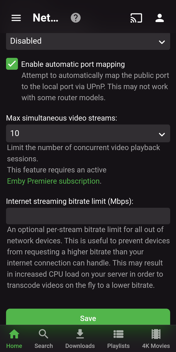

EmbyLogin 5 Posted February 18, 2022 Author Posted February 18, 2022 (edited) On 16/02/2022 at 07:58, Luke said: Check both the server network settings and user permissions. You may have added a limit server-side and then forgotten that you did that. I've gone through every setting I can possibly imagine, nothing has any kind of limits set. Any other solutions? Each user page on the admin console also looks like this. Each user has no limits in their individual settings as well. Edited February 18, 2022 by EmbyLogin
Luke 42239 Posted February 18, 2022 Posted February 18, 2022 How about the global limit in the server network section? And then also the quality setting from inside the xbox app?
EmbyLogin 5 Posted February 18, 2022 Author Posted February 18, 2022 4 minutes ago, Luke said: How about the global limit in the server network section? And then also the quality setting from inside the xbox app? Nothing, double checked the Xbox too. Everything is set to auto. I figured if it was a server-based limit, then it should be affecting me on my Shield as well
