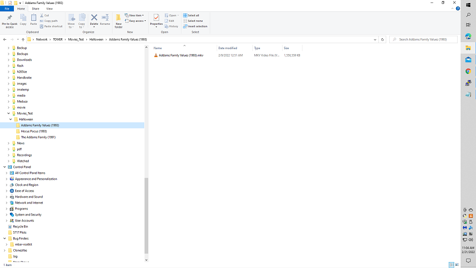

BobbyDing 56 Posted February 21, 2022 Author Posted February 21, 2022 Hi Luke, sorry so long. The issue persists. I have limited access to the system once I start my work week. Today I have off, so I've done some experimenting. This is (I think) on the latest unraid and embyserver OR embyserverbata versions. If I create a MOVIE library, it remains empty (I can watch the scan progress bar spend only a couple seconds). What I've found is it I create the same library using content type TV SHOWS, it finds most of the movies. They are incorrectly named and some are missing as expected. But it found them and populated the library. So for whatever reason content type MOVIES and also MIXED CONTENT come up with empty libraries. I've gone through the setup for the MOVIES type and made sure prefer embedded titles over filenames is not selected. I've tried changing the order of the two database options. It's odd that this happened suddenly. I had created a new MOVIE library for x265 conversions and it was populating fine. I'm using tdarr to convert to x265 and strip out erroneous metadata. A few days after creating the library it suddenly stopped seeing the new additions. I'm attaching a folder view to show my library structure. This movie gets found with content type TV SHOW, but not using type MOVIES. I'll also attach an embyserver log file from when I removed most other TV and MOVIE content so this was the only library in the logs. As mentioned earlier, I set up a binhex-emby container and it works as expected. Could it be the calls to the movie db are being blocked? Would this show in the logs? Just grasping for ideas. Thank you for the assistance. embyserver.txt

BobbyDing 56 Posted March 2, 2022 Author Posted March 2, 2022 @Luke Gained some time for this again. To answer your question, as a TV Library the movies do play. Curiously, a couple days ago I created a library with the type MOVIES, but entered the FOLDERS as one directory down from previous (using "Movies_Test/Halloween" instead of only "Movies_Test"), the library then populated properly with all the Halloween movies. Today I removed that library and recreated it hoping to confirm this was happening and supply you with more logs, but it now fails as it did originally. It's weird that it was working fine, then one day it stopped. Has to a software thing. But which software? This is on unraid and Movies_Test is a share. I haven't added any new containers or plugins recently, but the do get actively updated. Maybe a plugin update borked it? Dunno. As stated earlier the Binhex version is running fine (thank God, as it took some time to get the wife to use emby and I don't want to tell her she has to learn something new). Any ideas what to try next? Thank You! Bobby
