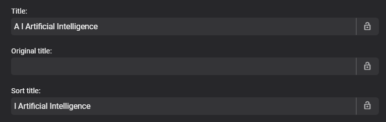

Happy2Play 9800 Posted June 12, 2022 Posted June 12, 2022 Per the linked topic, you need to edit your system.xml to remove SortRemoveWords and refresh your libraries. A Refresh is needed to correct the SortTitle in the database. Otherwise sort titles need to be adjusted per item example A is a SortRemoveWord so A I Artificial Intelligence is sorted to I without removing sortwords or applying Sort Title. <SortRemoveWords> <string>the</string> <string>a</string> <string>an</string> <string>das</string> <string>der</string> <string>el</string> <string>la</string> </SortRemoveWords> Or one needs to add additional sort words and Refresh. Ideally additional sort words should be put in a feature request to be added to Emby. But yes exposing this in the UI would be beneficial.
smn75 2 Posted June 15, 2022 Posted June 15, 2022 (edited) @Luke @Happy2Play I've edit the system.xml file and now the movies are sorted as I want. Thank's Edited June 15, 2022 by smn75 2
