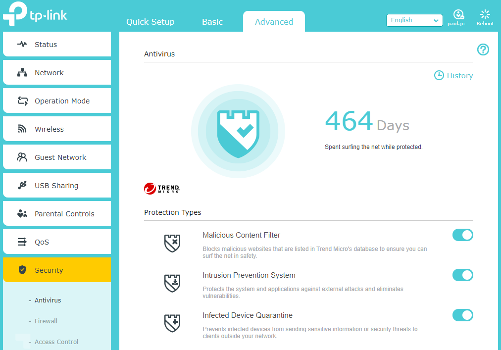

Joe Farmer 2 Posted February 14, 2022 Author Posted February 14, 2022 I have a TP Link AC4000 router which does have an IMGP Proxy enabled for IPTV as per the first attached screenshot. Can't see any other Proxy settings on the router. There is no Proxy configured on the server (running Windows 10) either. I do see Trend Micro Antivirus on the router though, as per the second attached screenshot. Could either of those have anything to do with it?

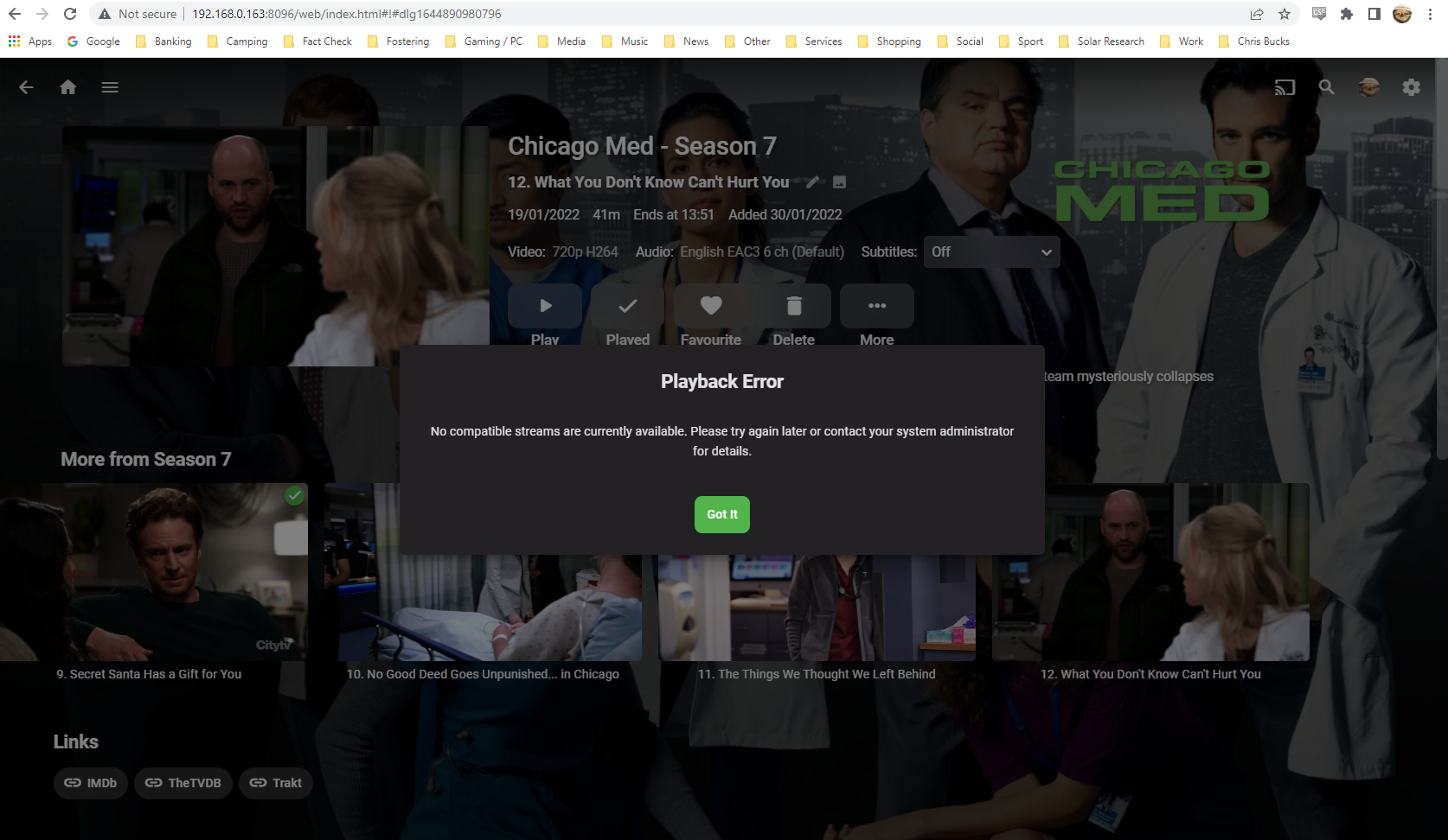

Joe Farmer 2 Posted February 15, 2022 Author Posted February 15, 2022 Both Android TV's seems to have version 2.0.48g. It shows 'Version: 2.0.48g Registered' when I go to settings, it freezes on both those TVs though on one it does come back after a minute or so of being frozen but the other doesn't come back at all, just the blue spinning circle indefinitely, I have to turn that tv off and on again to get it to work again for all of about 5 minutes before freezing again. On my phone it is ""Emby for Android 3.2.35" which the log files relate to. It is not only "D:\Adults\TV" that has the issue, G: also has the same issue, haven't tested media from the other drives yet, do you think it's worth testing? Interestingly I just tested on my PC on the same network as the server just using Chrome and I get the following error however I noticed that only occurred for media on D drive and: G drive. Media on other drives, two of which are external HDD's seem to be working. Testing now to see if media on those other drives freezes as well.
Luke 42186 Posted February 15, 2022 Posted February 15, 2022 4 minutes ago, Joe Farmer said: Both Android TV's seems to have version 2.0.48g. It shows 'Version: 2.0.48g Registered' when I go to settings, it freezes on both those TVs though on one it does come back after a minute or so of being frozen but the other doesn't come back at all, just the blue spinning circle indefinitely, I have to turn that tv off and on again to get it to work again for all of about 5 minutes before freezing again. On my phone it is ""Emby for Android 3.2.35" which the log files relate to. It is not only "D:\Adults\TV" that has the issue, G: also has the same issue, haven't tested media from the other drives yet, do you think it's worth testing? Interestingly I just tested on my PC on the same network as the server just using Chrome and I get the following error however I noticed that only occurred for media on D drive and: G drive. Media on other drives, two of which are external HDD's seem to be working. Testing now to see if media on those other drives freezes as well. @Joe Farmer can you please attach the emby server log from when you tried to play using the web app? Thanks !
Carlo 4561 Posted February 15, 2022 Posted February 15, 2022 This could be router related as you are getting some strange results that normally would be associated with proxies. Do you have any ethernet based devices to test on? Using any devices directly connected to the LAN should bypass the router allowing for a simple diagnostic without making any changes to the router. If you have an older WIFI AP you could try plugging that into your switch (not the router) and then do a test using this "new" WIFI AP. If you don't have any additional hardware to do anything like the above your best bet would be to backup your current router config (if it has that feature) then walk through the UI turning off any advanced feature (keeping a list). The idea is to get it back to being as close to a "dumb" router as possible without using any advanced features like QOS, virus and/or malware checking, proxy, etc... All three of these for example would be turned off: You would also turn off the the IGMP proxy and multicast shown on the screen you posted above as well. I'd then shutdown all network equipment including the devices you will check. Wait 30 seconds then turn on your switches and router. After the router is back up turn on your Emby Server followed by devices you wish to test. If things now play correctly you can slowing start turning features back on one by one while testing. Let us know how you make out. If none of these seem to help we can do a remote support session with you to see if we can spot anything causing these issues. Carlo
