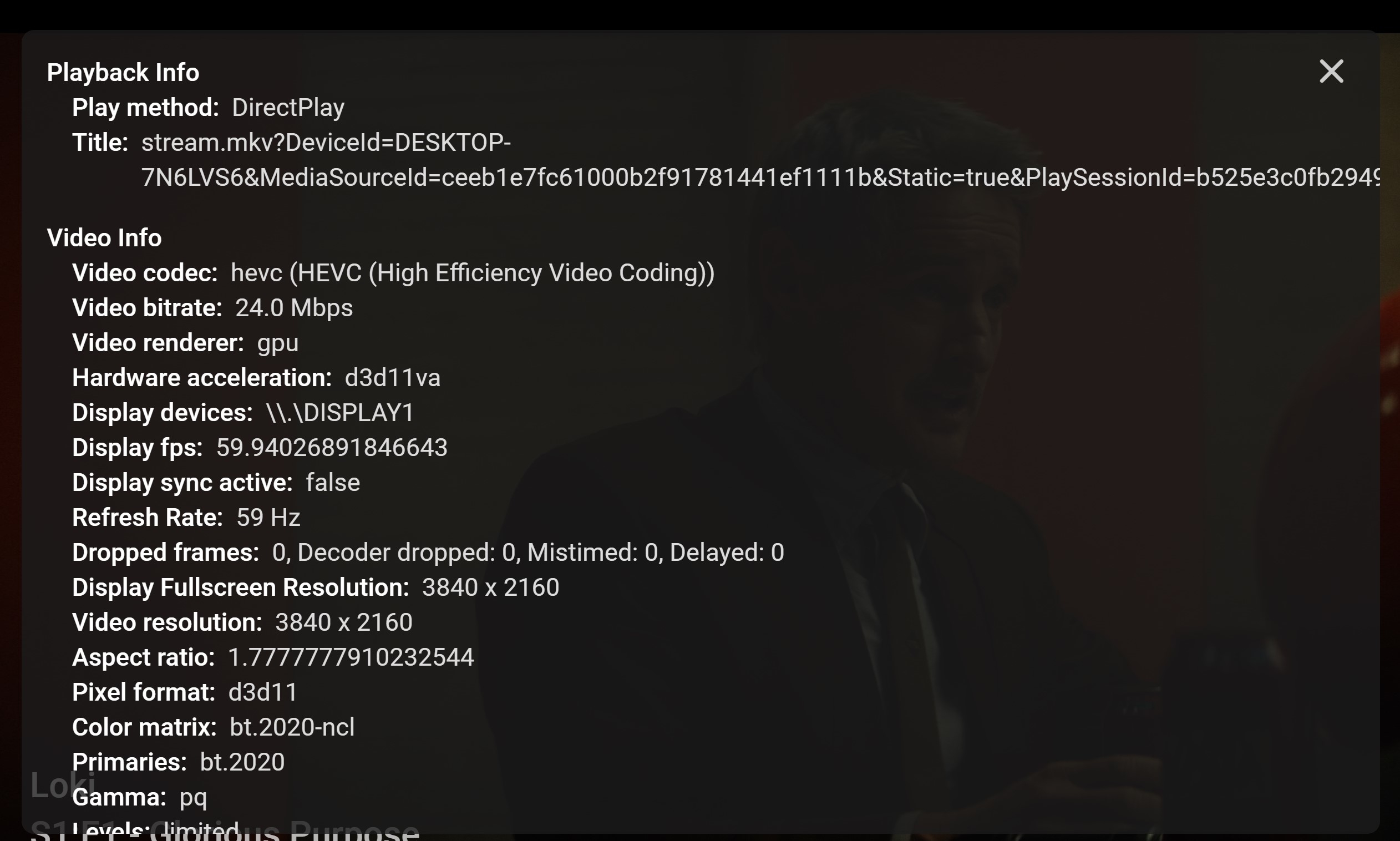

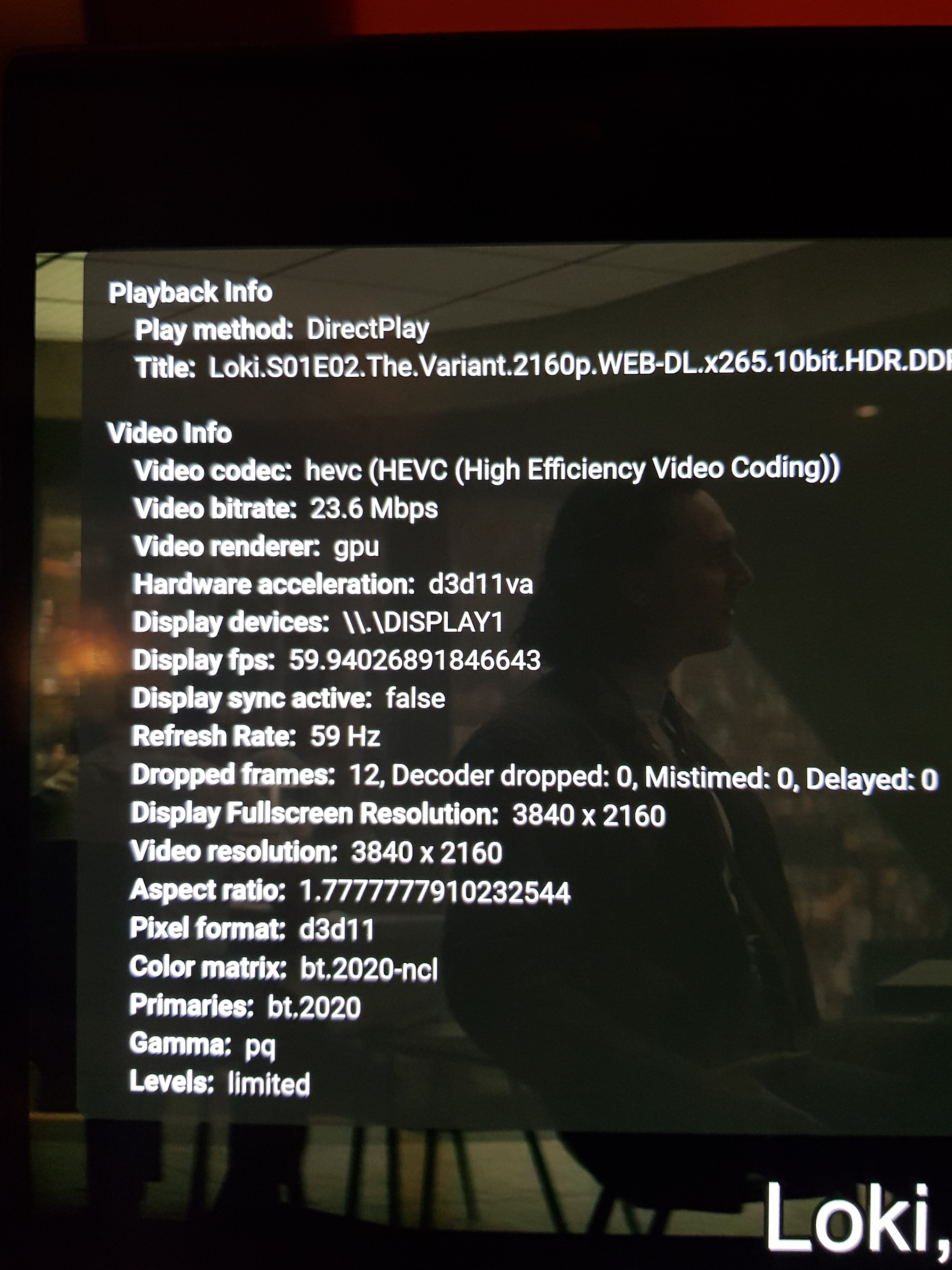

ouraman 0 Posted February 9, 2022 Author Posted February 9, 2022 sure , no problem well, i played a particular file (with high bitrate) , which is causing some troubles to him and now myself... for example an episode of Loki .. (4k hevc10) my bandwidth is a gigabit fiber internet: my network: 1000 down / 400 up (server) his bandwith: 500 down / 100 up 4g network (with VPN): about 100 down / 20 up (to test) i'm going to send the log with my attempts , which can help him later ... i tried in 2 different ways play the same file: 1) in my network, which is working great ... 2) with 4g network (using VPN), which is causing some stuttering and dropping frames * however and not sure if is relevant, the VPN bandwith is only about 20 or 30mbps UP (thats when i try to use my device with VPN to download something from the NAS)... however the DOWN from the NAS is working well ... strange * below from the screenshots in the left i'm in my network directly... which is working great in the right using a 4g connection (through VPN) in the logs ... the last attempt is from my network and 2/3 minutes before was from 4g connection (VPN) which stutters my device is: desktop using the Emby Theater thanks again embyserver.txt ffmpeg-transcode-58eb5a3c-33ab-4f85-b1f7-943f0bd123cc_1.txt

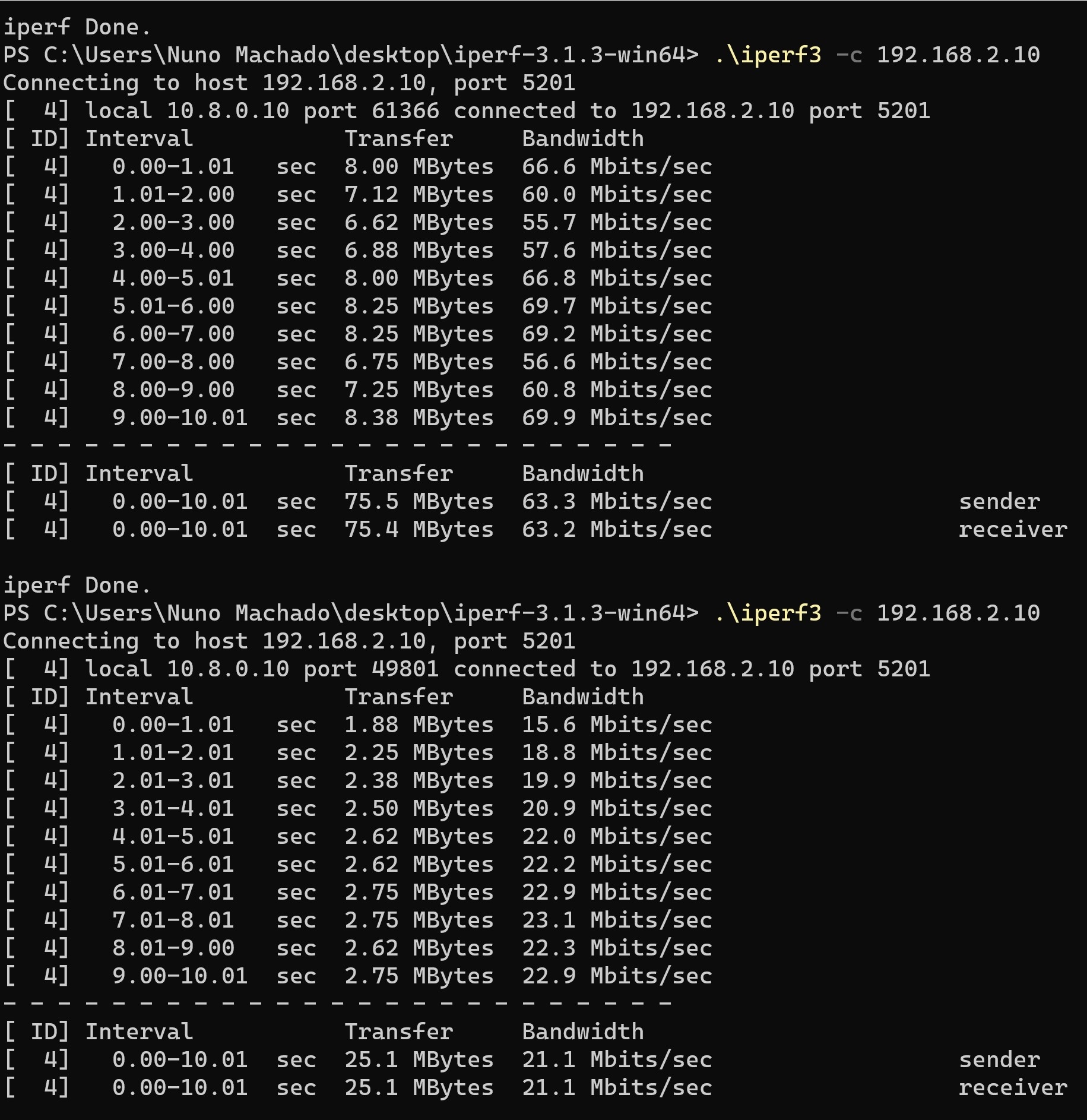

ouraman 0 Posted February 11, 2022 Author Posted February 11, 2022 hi, well i made a few tests with iperf between the server NAS (with openvpn) and the clients to measure the real bandwith (the NUC with the emby server stays righ next to the NAS, so is the same) below i have a screenshot with the test * above i'm using an Access point limited to 100mbps in my network (that's why you don't see the full Gb) * below i'm using the VPN ... so, limited to 20mbps so, this could be the reason? so strange, every movie like 4k i can see without any problems but some series i can't without some stuttering i guess most of the movies goes around 20mb bitrate and some of the series goes above that, could reach the 30 etc etc if that's the reason, i tried without any luck to improve the bandwith.. i guess i'll try to change the VPN from the NAS to the NUC, just to see if i can improve something or probably changing to another vpn like wireguard ...
ebr 16337 Posted February 11, 2022 Posted February 11, 2022 8 hours ago, ouraman said: so, this could be the reason? Yes. If the bandwidth is limited to 20mb/s and you are trying to play items with higher bitrates than that, you will get stuttering, buffering and delays.
