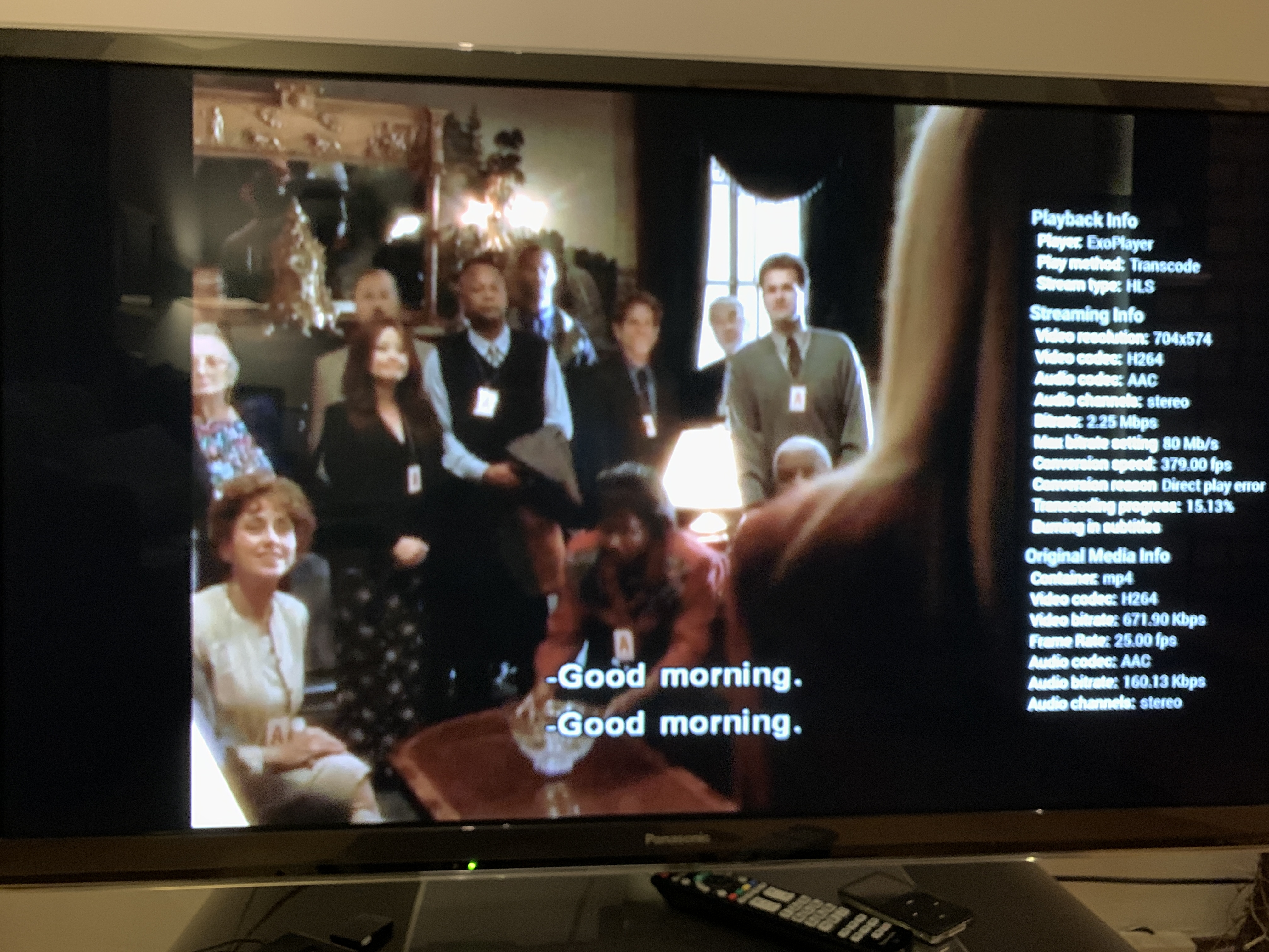

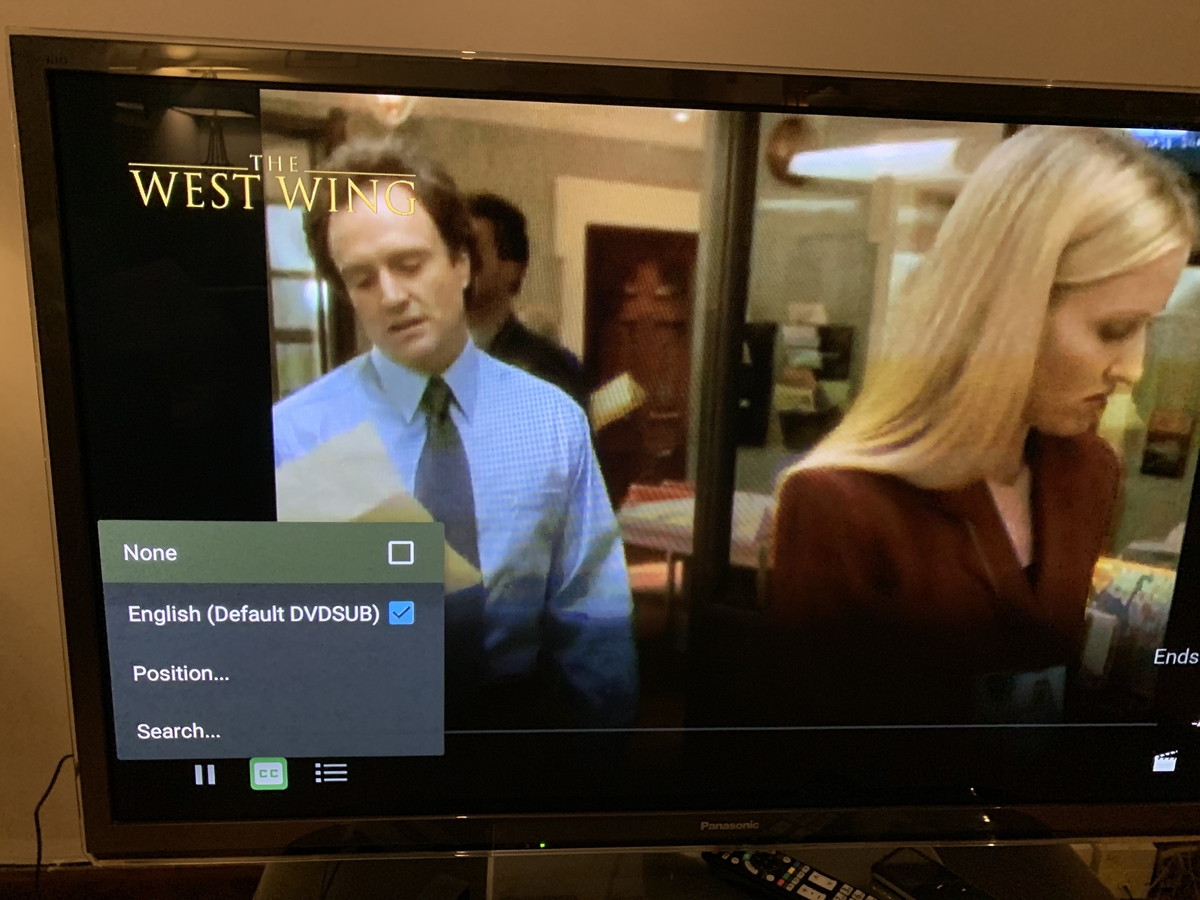

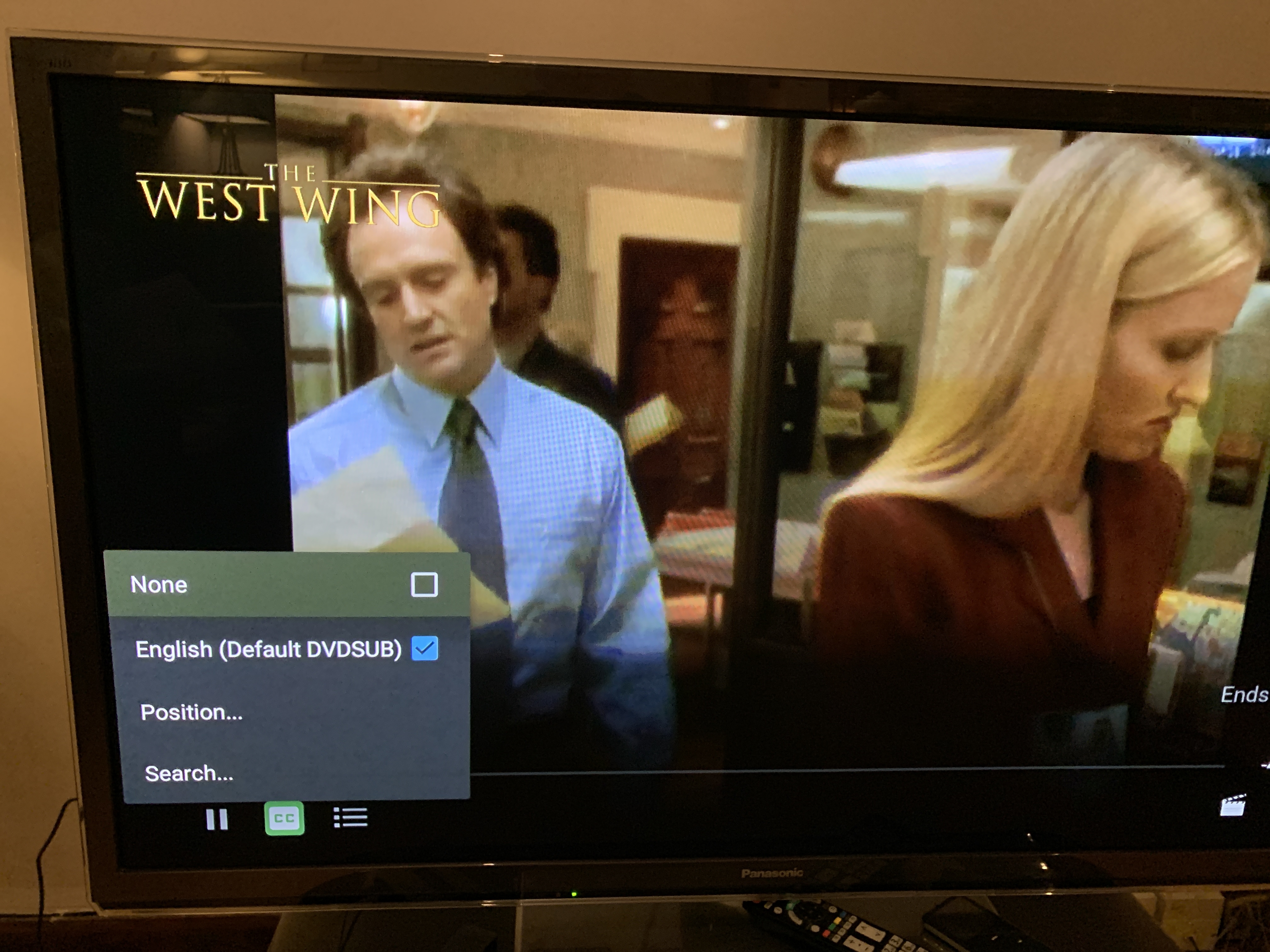

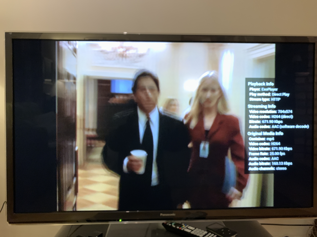

emg456 3 Posted February 8, 2022 Author Posted February 8, 2022 They don't show - I've taken some pics - sorry= they're a bit shaky. Here is the file streaming - direct play So, you can see that the subtitle track is chosen. But none are displayed. I pick "Playback Correction" in the settings menu and answer "Yes" Emby resumes playback but this time transcoded and voila...there are the subtitles. I can turn them off or on. As I said, they work straight off the bat on the LG TV client, ios devices and Emby Theatre. I think what the Handbrake doc may be referring to are subtitles permanently burnt onto the actual video file- ie rendered as part of the image itself so can't be turned off.

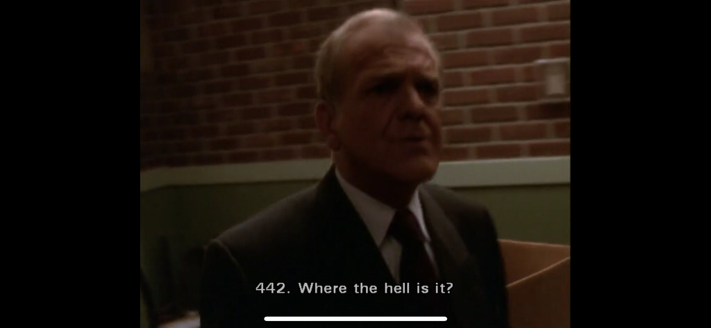

emg456 3 Posted February 9, 2022 Author Posted February 9, 2022 Ok have just sent the log. Logged in as Eddie McGlone and was playing The West Wing - The West Wing_Series2_Episode_5_And It’s Surely to Their Credit Subtitle track selected was English (Default DVDSUB) These subtitles were not showing on screen. log sent about 09:50 utc This image is the same file playing on iPhone a few minutes later- subtitles showing.

emg456 3 Posted February 9, 2022 Author Posted February 9, 2022 Interesting - as I say, other clients show them without issue. What do you think is happening when I switch to transcoded? Is the server burning the subtitles into the stream? Remember, when playing them this way, I can still turn them off or on at will. When the log states that the track doesn't exist in the track list is it Emby which is providing the list to the client? I'd like to get to the bottom of this because I need these subtitles for this particular show.
ebr 16337 Posted February 9, 2022 Posted February 9, 2022 1 hour ago, emg456 said: Is the server burning the subtitles into the stream? Yes. You can see this indicated in the stats picture you posted when you used Playback correction. 1 hour ago, emg456 said: When the log states that the track doesn't exist in the track list is it Emby which is providing the list to the client? Emby (the server) can see the subtitle stream - which means ffprobe recognizes it. It is the player in Android that does not "see" it.
