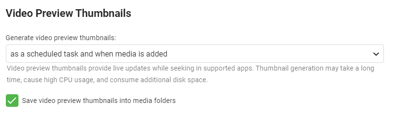

muckngrind 0 Posted February 7, 2022 Author Posted February 7, 2022 Thanks for the reply Luke. That was a very informative thread. If I understand correctly, a quick workaround is to add the nbrl parameter to the mount point in my /etc/fstab file, which I did but still get the same problem (rebooted just to make sure). Also, I've thoroughly reviewed permissions both locally and on the file share and all looks good. If I change the library setting to not store the thumbnails in the media folders, thunbnails are created successfully. Only when I'm storing them in the media folders does it cause a problem. So that seems to suggest a failure to write the .bif files (as opposed to failure to read an executable or library file). However, all other write processes (poster art and nfo files) write successfully to the same directory. I'm really baffled. Two questions: 1) I'm assuming the quick-extract-imageseries process runs under the same user as everything else, right? 2) Can you think of any reason why the poster and nfo files can be written but the bif files cannot? Thanks again for any assistance. This is driving me a little nuts....

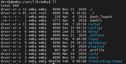

muckngrind 0 Posted February 8, 2022 Author Posted February 8, 2022 Yes, UID 1000 is the emby user on the host. Here are permission on /var/lib/emby Let me know if there is anything else you'd like to see. Thanks for helping...
Q-Droid 1011 Posted February 8, 2022 Posted February 8, 2022 So far it checks out. What level of access does the SMB user with the credentials in fstab have on the NAS server? Does it own the shares or have full control?
