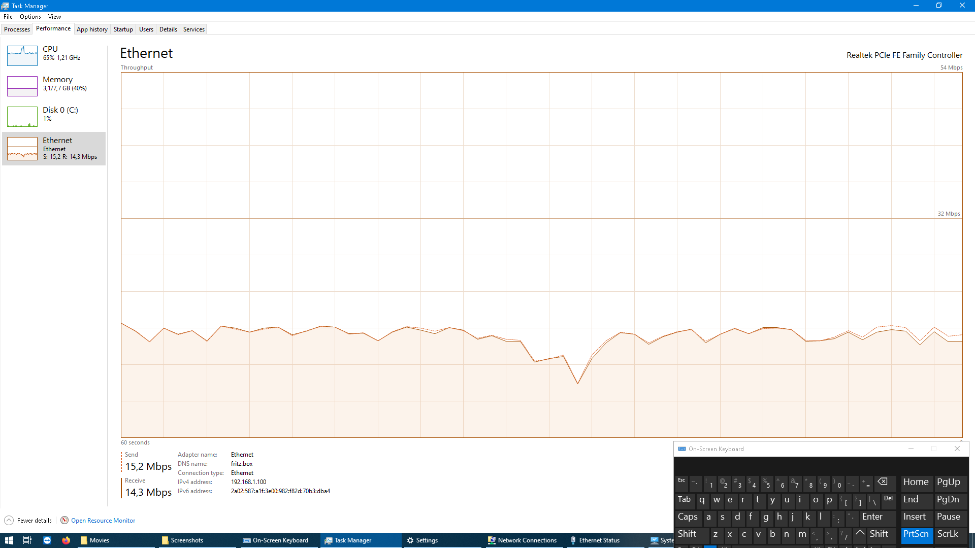

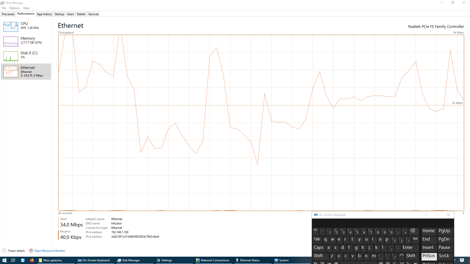

rbjtech 5335 Posted February 9, 2022 Posted February 9, 2022 (edited) Ensure your laptop has connected to the switch at 100Mbit FULL DUPLEX. Due to you having to READ (Receive/Rx) the source from the network, Emby then convert to HTTP, and then SEND (Transmit/Tx) to the clients - the 100Mbit interface needs to run in Full Duplex mode or it can only do one of these at a time. Note the two sets of identical lines in the first graph - this is the adapter bottlenecking. When you only do one (Rx or Tx), the Duplex setting does not matter - Half Duplex will work perfectly well. Note - if using 1Gig, you do not get a choice, it will always negotiate at full duplex, with 10/100Mbit you may get Half Duplex. Edited February 9, 2022 by rbjtech

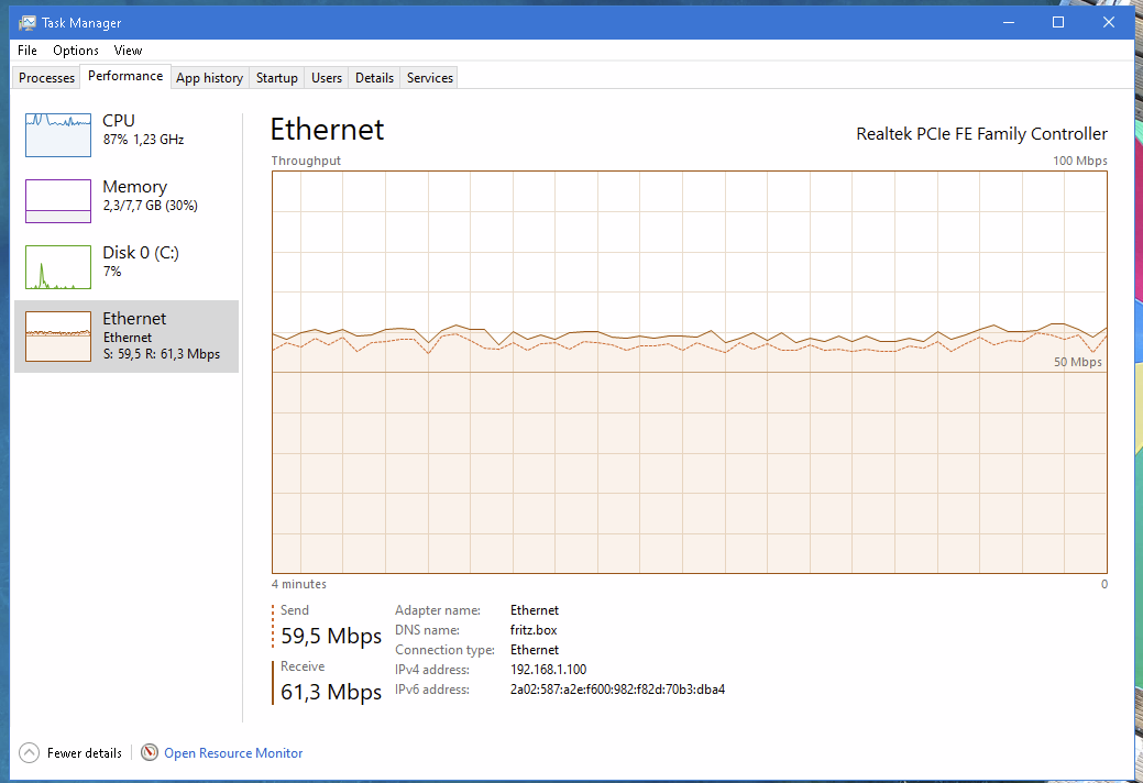

psxlover 32 Posted February 9, 2022 Author Posted February 9, 2022 1 hour ago, rbjtech said: Ensure your laptop has connected to the switch at 100Mbit FULL DUPLEX. I've changed the value on the adapter from auto negotiate to full duplex, and as I wrote on the first message I copied files from the hard drive to my desktop using the netbook, and the speeds were around 50Mbps for down and for up, which is way more than the 15-16Mbps when streaming from that hard drive through Emby.
rbjtech 5335 Posted February 9, 2022 Posted February 9, 2022 35 minutes ago, psxlover said: I've changed the value on the adapter from auto negotiate to full duplex, and as I wrote on the first message I copied files from the hard drive to my desktop using the netbook, and the speeds were around 50Mbps for down and for up, which is way more than the 15-16Mbps when streaming from that hard drive through Emby. When you are just copying - you and not Tx and Rx at the same time - emby does need to do this and I suspect that's what the problem is - OR there are some other network related settings such as TCP offload not set correctly - as your CPU is very high for such a simple single stream playback. Maybe provide some screenshots of the Laptop Network Stack config/settings.

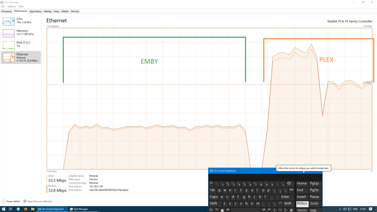

psxlover 32 Posted March 13, 2022 Author Posted March 13, 2022 (edited) As a comparison, same file same server same TV. Left part is Emby limited to 14-16 Mbit/s, and right side is Plex where it even slows down after a while from 40-45 Mbit/s to 32-34 Mbit/s perhaps because it reaches the TV's cache limit (playing without issues though). Edited March 13, 2022 by psxlover Forgot image

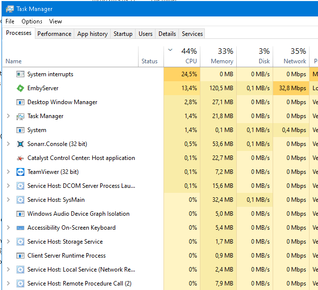

psxlover 32 Posted March 21, 2022 Author Posted March 21, 2022 @Luke here are the logs. It could be that Emby task + "System Interrupts" task are using 100% of one of the two cores, thus the limit is due to hardware resources, but I don't understand what changed with the new router. As I wrote I've tried using SMB1, like the previous router used, in case the SMB2/3 protocols added extra processing overhead, but I didn't see any improvement. logs.zip
