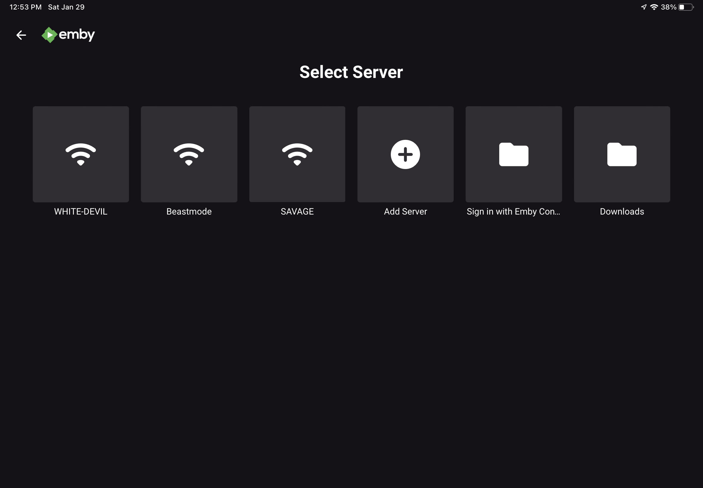

Shelll 1 Posted February 5, 2022 Posted February 5, 2022 Hey guys, So am currently getting a connection failure error when I try to connect to my server called savage. This server was operational and working fine until I installed the virtual desktop streamer app for my oculus rift on the PC(https://www.vrdesktop.net/), they told me to alter a setting that I can't remember which may causing the issue. So now I am getting the error I posted below. I also use a VPN, but I usually was able to access the server even with the VPN was on. I have also try connecting to the server with the VPN Disconnected and still got the same results. I haven't set up the emby connect so this is meant to be only seen by devices on the local network. I have uploaded the logs to this file I followed this thread and didn't find a solution. https://support.emby.media/support/solutions/articles/44001849007-connectivityembyserver.txt Thanks for your help
