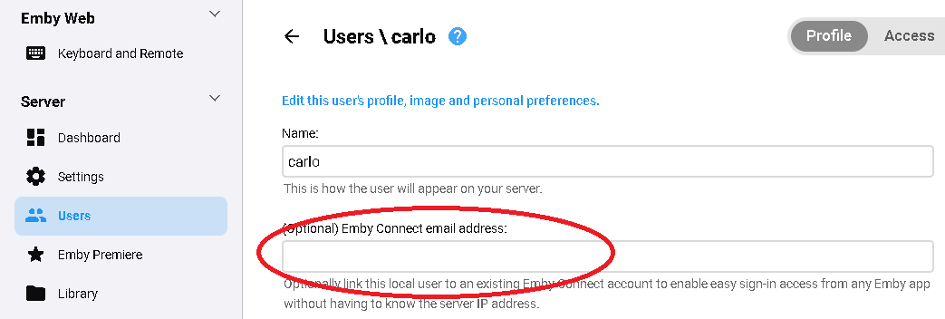

Carlo 4561 Posted June 27, 2022 Posted June 27, 2022 Hello @brian5678 did you by any chance read @triggerx post right above Luke's? Are you logging in using Emby Connect or directly to your server? Do you have anything filled in here for your account?

brian5678 7 Posted June 27, 2022 Posted June 27, 2022 13 minutes ago, cayars said: Hello @brian5678 did you by any chance read @triggerx post right above Luke's? Are you logging in using Emby Connect or directly to your server? Do you have anything filled in here for your account? Already checked. I am not logged into Emby Connect. I have never setup Emby Connect. 1
ptlh2a 3 Posted June 28, 2022 Author Posted June 28, 2022 I have checked mine as well, and I am not using Emby Connect. 1
Carlo 4561 Posted June 29, 2022 Posted June 29, 2022 Thanks for the feedback everyone. That would definitely seem to rule out Emby Connect as a factor. This will likely require the development team reviewing the code to see why the download process isn't kicking off when it should. @Happy2Play Have you by any chance setup a job that transcodes and is ready to download and then adding one that doesn't require transcoding with a quick shutdown and looking at the database for differences between the jobs? I've not done this, so no SQL to give you but wondering if you've tried anything like this?
