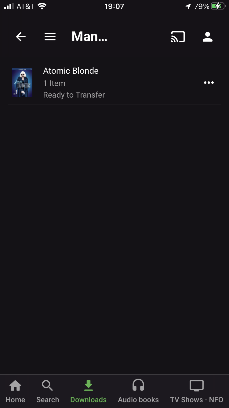

ptlh2a 3 Posted February 4, 2022 Posted February 4, 2022 Good morning. I cannot seem to download any files to any of our IOS devices. When I instigate a download, I see "Ready for Transfer", but it never starts the transfer. I have waited over 3 hours for it to start (I saw in another post that the process can sometimes take a bit of time). This used to work with all of our devices, but now does not. I have instigated downloads both from the receiving device, as well as from the Emby webUI (to send it to a device). Both ways still result in same Ready for Transfer. Playing the files thru the app, Roku, etc...work fine. Server: Ubuntu 18.04 running Emby 4.6.7.0 All devices IOS 15.x (have tried even on 15.3) Emby app v 2.1.1 All of the devices we use are Apple/IOS. I believe I have an older Android device to attempt the transfer with if needed. I have attempted on one of the devices to remove the app, and reinstalled it. That did not seem to resolve the issue as well. I have attached log files from the server in this post as well. Please let me know what would be next troubleshooting steps. Thanks. Pete embyserver-63779544028.txt hardware_detection-63779544034.txt ffmpeg-transcode-c3d1bf6c-d9db-4552-bc08-4c9c953c0407_1.txt embyserver.txt

caveman456 2 Posted March 5, 2022 Posted March 5, 2022 Having the same issue running Emby server on a PC and Emby iOS on an iPad Pro. If I configure the download using the iPad it stalls on Ready To Transfer and does nothing further. If I configure the download via the WebUI on the PC using "Download To" then the download is pushed to the iPad straightaway and completes.
Luke 42241 Posted March 27, 2022 Posted March 27, 2022 Can you try pulling up the downloads setting screen in the app? Everytime you do that we manually kick off the background download process, so if that helps then that might tell us something. Thanks.

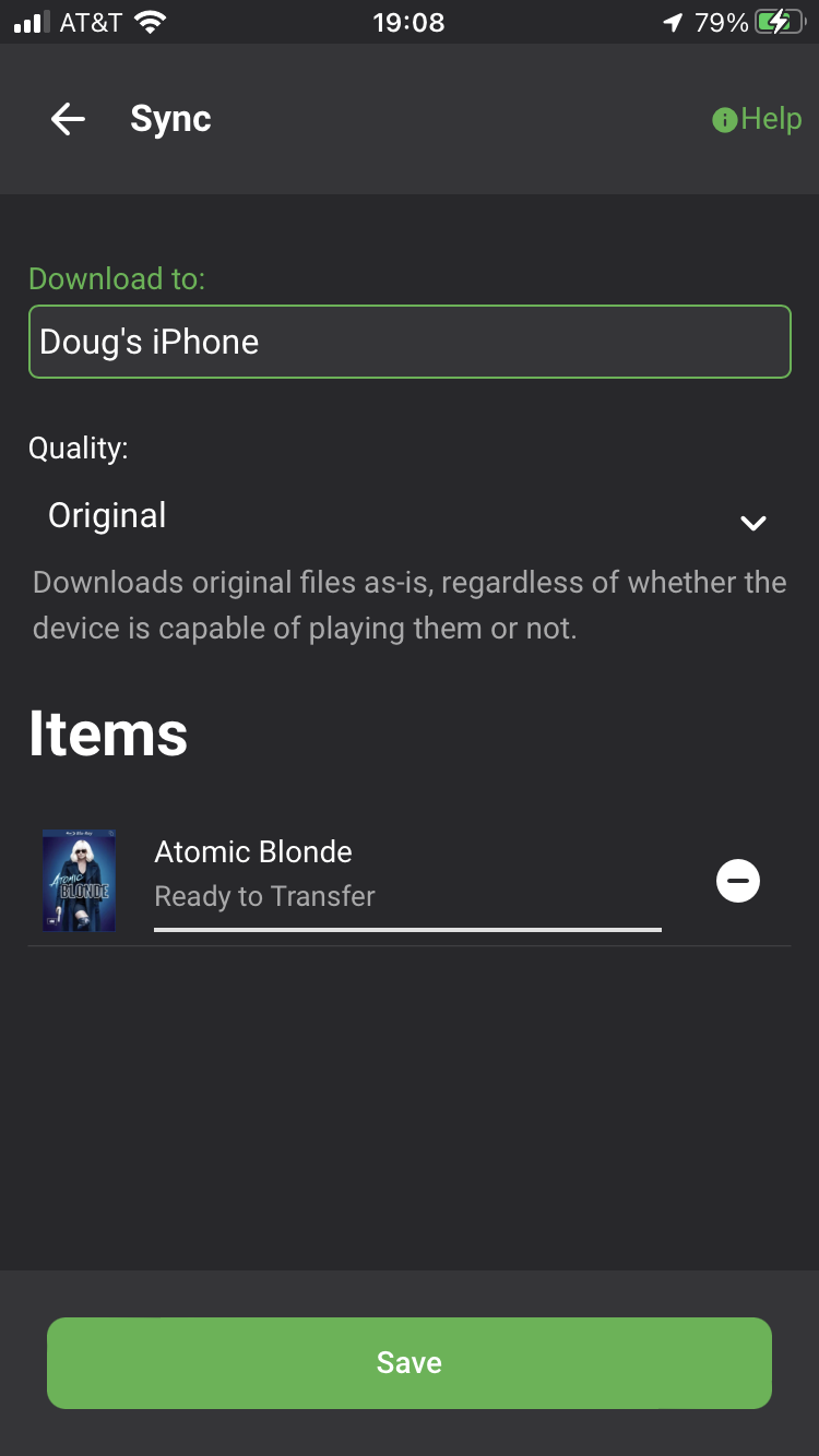

Happy2Play 9811 Posted March 28, 2022 Posted March 28, 2022 (edited) All I see is a disconnect in screens. Selected Download from iPhone. Finished iOS app 2.1.4 iOS 15.3.1 But this was a test on beta 4.7.0.32. Will retest on 4.6.7.0. Edited March 28, 2022 by Happy2Play
Luke 42241 Posted March 28, 2022 Posted March 28, 2022 No, try the app downloads settings screen from inside the app, not the server management screens.
Happy2Play 9811 Posted March 28, 2022 Posted March 28, 2022 (edited) Retested on 4.6.7.0 and conversion shows same as above. But testing the same file with download Original does stop at "Ready to Transfer" and Download to from PC does the same for me. Something about Original. Retested Original in 4.7.0.32 it kicks off a conversion converting audio and container instead of Original. 18:39:48.308 Stream mapping: 18:39:48.308 Stream #0:0 -> #0:0 (copy) 18:39:48.308 Stream #0:1 -> #0:1 (dts (dca) -> aac (native)) 18:39:48.308 Stream #0:2 -> #0:2 (copy) This does not make since as it downloaded locally instead of to device where download was initiated. Edited March 28, 2022 by Happy2Play
Luke 42241 Posted March 28, 2022 Posted March 28, 2022 21 minutes ago, Happy2Play said: But testing the same file with download Original does stop at "Ready to Transfer" and Download to from PC does the same for me. Something about Original. Try pulling up the downloads setting screen in the app. Everytime you do that we manually kick off the background download process. That may help.
Happy2Play 9811 Posted March 28, 2022 Posted March 28, 2022 3 minutes ago, Luke said: Try pulling up the downloads setting screen in the app. Everytime you do that we manually kick off the background download process. That may help. Original will not do anything for me.
Luke 42241 Posted March 28, 2022 Posted March 28, 2022 3 minutes ago, Happy2Play said: Original will not do anything for me. Are you sure you have enough space for it?
Happy2Play 9811 Posted March 28, 2022 Posted March 28, 2022 3 minutes ago, Luke said: Are you sure you have enough space for it? Should be plenty as file size is 4.37Gb
Happy2Play 9811 Posted March 28, 2022 Posted March 28, 2022 For me anything besides "Original" will transfer, just tested 15Mbps option and video copy, auto converted. 20:22:04.958 Stream mapping: 20:22:04.958 Stream #0:0 -> #0:0 (copy) 20:22:04.958 Stream #0:1 -> #0:1 (dts (dca) -> aac (native)) 20:22:04.958 Stream #0:2 -> #0:2 (copy) 20:22:04.958 Stream #0:3 -> #0:3 (copy) Need to look at why Download does not choose the phone but am able to change with Download to. But think this may be a beta issues but will check again later.
