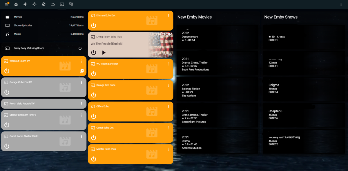

schmittty 2 Posted February 3, 2022 Posted February 3, 2022 I searched several different ways/terms and didn't really see anything related to what I am asking, so here goes hopefully someone can tell me if it is doable or not. Use case: I have Emby Premiere and Home Assistant for my home and all it's "gadgets", I have a Fire Tablet wall mounted in the Kitchen that runs Fully Kiosk browser and goes to the HA dashboard(s). I have a media tab where I can see all the Alexa media player (controls), along with Android/Fire TVs (again controls) as well as the Emby media player controls. Which is nice I can control volume, see what is playing and turn on/off. What I would like to do (for the wife who is not that tech savvy), is display a Live TV channel within an html/iframe card on that media dashboard so when in the Kitchen she can hear and watch on the tablet rather than having to close the Kiosk browser and switch over to the Emby app as that just get complicated and I have to fix. I have looked high and low and I just don't see where it has been done or could be I am searching the wrong terms. I was hoping to do this one of two ways, either directly from the HDHomerun tuner (MPEG-TS) or through an interface to Emby and the live TV component and carve out space on the media page as pictured below along with all other things media. I would prefer not to reinvent the wheel if this has already accomplished in some way, it will only be internal on the same local network as the Emby server so I didn't/don't want to complicate it as far as having to cross an SSL connection or get into any complex authentication configurations. Any direction, ideas or assistance would be greatly appreciated. Thanks in Advance. @cayars

schmittty 2 Posted February 13, 2022 Author Posted February 13, 2022 1 hour ago, cayars said: I've not tried this to see if it could help or not but you may want to see if there is an app for the tablet from Silicon Dust (HDHomeRun). If so, give that a test to see if you have any control over the output or if you can use it as a cast to receiver. Yea, the app works fine. I just have issues with those using it (in this case the Wife). If she has to exit the dashboard to get to that app I can guarantee it will be messy. I was trying to achieve as little effort on her part other than clicking intuitive buttons as she does not need to or want to understand any complexities (I have tried). I guess I was hoping that Emby could expose the live stream already in a usable format, rather than what I am doing now. As far as presentation I think I got what I was looking for.
