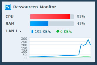

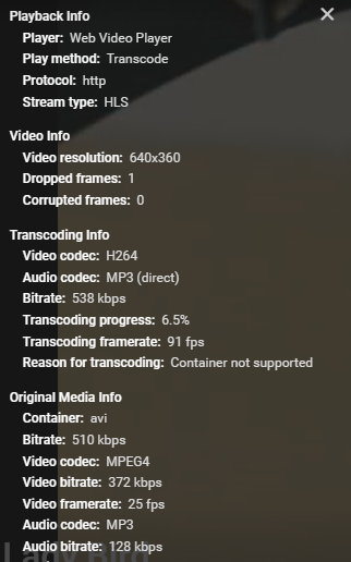

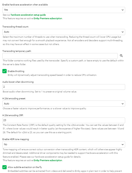

emingy 2 Posted February 2, 2022 Posted February 2, 2022 (edited) Hi, I installed Emby 4.6.7.0 on a Synology RS816. System specs are: DSM 6.2.4-25556 Update 2 Marvell Armada 385 88F6820 @ 1,8 GHz 1 GB RAM I'm only connecting locally to the NAS (Gigabit LAN) and I'm only connecting via Browser (e.g. Opera) I was pretty thrilled by the options Emby offers until I tried to play a movie. Playback tends to stutter, and CPU load on the NAS will shoot up to 90-99%. I also booked Emby Premiere to find out if Hardware transcoding might fix this issue, but it didn't. These are my transcoding settings - pretty default as far as I remember: This is what Stats for Nerds says: While putting together this information, I realize that an overwhelming part of my video collection is in .avi. A few are .mp4 and play just fine with a CPU load below 10%. Is this a general issue with .avi files? And - if so - is anyone aware of a tool to batch convert .avi to a more digestible format? Thanks in advance! Lennart ffmpeg-transcode-31a600c2-1c0c-4ef1-87e0-74a671677f9e_1.txt Edited February 2, 2022 by emingy added transcode log.
