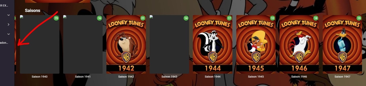

Tangsgod 22 Posted February 1, 2022 Posted February 1, 2022 I just notice that the arrow to scroll the seasons is disapearing IF: - You scroll the seasons to the left - Then, go inside the rightest season - Then leave the season with the top right arrow
Happy2Play 9811 Posted February 1, 2022 Posted February 1, 2022 I am unable to reproduce with steps provided. Even tried with sidebar pinned as the image above suggests. Connected to stable and beta servers.

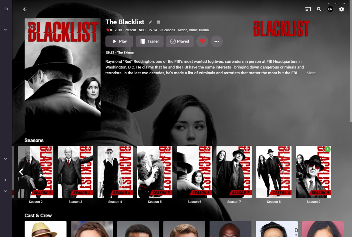

GrimReaper 4895 Posted February 2, 2022 Posted February 2, 2022 (edited) 1 hour ago, Happy2Play said: I am unable to reproduce with steps provided. I can. If at this moment Season 2 were entered (scrolled all the way left right) subsequently pressing Back UI button results in no Left-arrow on Seasons strip/row on mouse hover. However, clicking anywhere on blank space (backdrop) brings the arrow back. 3.0.15 on 4.6.7.0 stable. Edit: Same can be observed on mouse Back (thumb) button as well. Edited February 2, 2022 by GrimReaper Append 1
Happy2Play 9811 Posted February 2, 2022 Posted February 2, 2022 (edited) 48 minutes ago, GrimReaper said: If at this moment Season 2 were entered (scrolled all the way left): Now with this step I can reproduce ie season under the left arrow. Selecting any other season returns to arrow scroller. Will have to look but this issue sounds familar. @Lukethis is 3.0.15, can reproduce in both server versions. But as Grim mentioned clicking anywhere on the screen brings the scroller arrow back. But appears not limited to this row as I just reproduce on "More Like This" row. But does require pinned drawer. Edited February 2, 2022 by Happy2Play 2
Happy2Play 9811 Posted February 2, 2022 Posted February 2, 2022 Also not I reproduced this in Store app also. 1.1.395.0 Pin sidedrawer select series that requires scroll right scroll all the way right select season under left arrow back out of season and you have no left arrow. 1 minute ago, Luke said: Can you reproduce in Chrome? Have not been able to reproduce in Edge, with will try Chrome.
Luke 42239 Posted February 2, 2022 Posted February 2, 2022 What about Chrome with the hosted web app, http://app.emby.media ?
Happy2Play 9811 Posted February 2, 2022 Posted February 2, 2022 17 minutes ago, Luke said: What about Chrome with the hosted web app, http://app.emby.media ? Yes I just reproduced in online web client but have not been able to reproduce in local web client. Edge and Chrome with and without pinned drawer.
Luke 42239 Posted February 2, 2022 Posted February 2, 2022 Ok yes I can reproduce. And you're not able to reproduce with any other section? 1
Happy2Play 9811 Posted February 2, 2022 Posted February 2, 2022 9 minutes ago, Luke said: Ok yes I can reproduce. And you're not able to reproduce with any other section? I can on "More like this" but not "Cast and Crew". Haven't noted it on other rows that I have tested. 1
