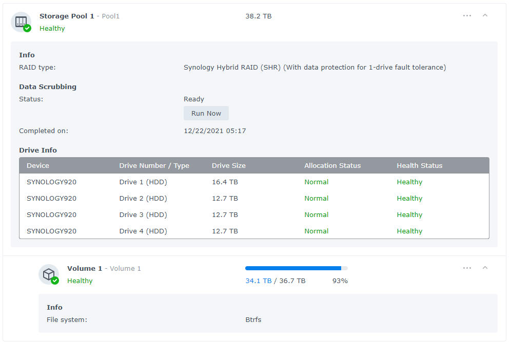

Mine is mismatched as well but with 3 14TB drives and 1 18TB drive.
So here's my NAS:
And here's yours:
I choose two types of RAID arrays based on best results.  The pure RAID 5 works out to be smaller for both of us while the SHR (Synology Hybrid Raid) is larger.
In this you're not really loosing out at all with SHR except that one of the larger drivers is used for parity.
These numbers are raw storage numbers.  As an example looking at mine above I have 44 TB of usable space.  Let's convert that to TiB by diving by 1024 and then multiplying by 1000.
44/1024*1000=42.96.  Now let's multiple that by 89.5% or .9 which will take into consideration the partitions, formatting, file allocation tables and other things leaving me with:
38.46 TiB of usable storage.
That number is pretty close to what Synology shows which is 38.2. you'll see below:
Now looking at your NAS with 34 TB of raw usable space.
34/1024*1000*.895=29.7 TiB of storage would sound just about right.
So between the choices of SHR and RAID 5, SHR is going to be the more flexible and easier to upgrade solution.
