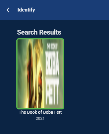

Tangsgod 22 Posted January 31, 2022 Posted January 31, 2022 In Emby Theaters Here is how the posters look when in the Identify popup:

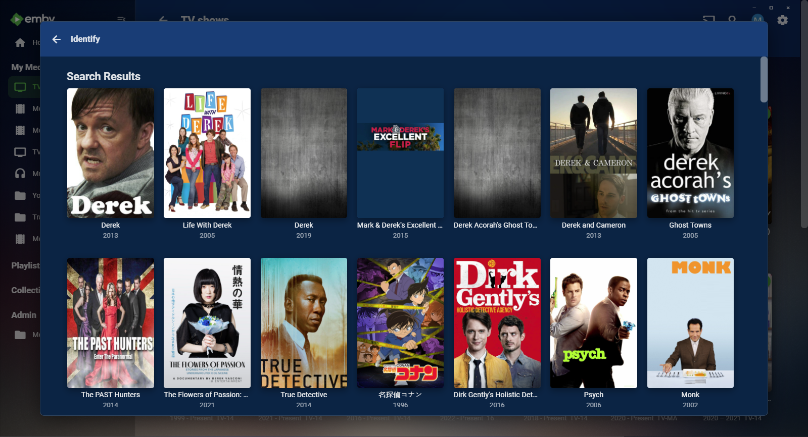

Happy2Play 9840 Posted January 31, 2022 Posted January 31, 2022 9 minutes ago, Tangsgod said: Thanx : Version 3.0.15 I can reproduce it in case it's needed Does the same happen in web client? But what exactly are you doing as that identify image is of many series not a normal one item query as Psych and Monk are nowhere near the same query.
Tangsgod 22 Posted January 31, 2022 Author Posted January 31, 2022 I'm trying to identify the tv show "Derek" https://www.imdb.com/title/tt2616280/?ref_=nv_sr_srsg_0 Here is the result in the web client :
Happy2Play 9840 Posted January 31, 2022 Posted January 31, 2022 Not sure as this is what I get in ET 3.0.15 But I do see all lot of garbage returned for "Derek". Shouldn't matter but what is your metadata provider order?
Tangsgod 22 Posted January 31, 2022 Author Posted January 31, 2022 Yes, a lot of "matches" , but even with 1 match it is the same : Here are the providers :

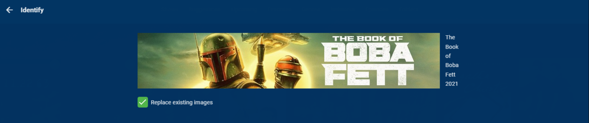

Solution Happy2Play 9840 Posted January 31, 2022 Solution Posted January 31, 2022 (edited) @Lukelooks like issue is v3 vs v4 tvdb api. v3 v4 So this will not change until server 4.7. Edited January 31, 2022 by Happy2Play
Happy2Play 9840 Posted January 31, 2022 Posted January 31, 2022 Just now, Tangsgod said: oh, you reproduced it Yes as my server I was using was beta 4.7, once I switched to 4.6.7.0 which uses a difference api version on TVDB I get what you see. Nothing can be done as TVDB v3 api is the defect as you get Banners instead of Posters.
Tangsgod 22 Posted January 31, 2022 Author Posted January 31, 2022 Ok, then the only way is to update to the beta?
Happy2Play 9840 Posted January 31, 2022 Posted January 31, 2022 1 minute ago, Tangsgod said: Ok, then the only way is to update to the beta? Currently yes As a note you are sort of seeing the exact same thing in web client but you get that blank placeholder because it is a Banner, clicking on image will display it.
