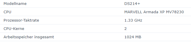

sondereggerlukas 3 Posted January 30, 2022 Posted January 30, 2022 Hey guys, got a playback problem and I don't know, where to start to find it... perhaps, there is someone out there who might help me. Playback of mkv files on Chrome, latest stable version, won't start at all, it just appears a black screen (no background image) with the spinning circle - ends about 10 seconds later. Same file played on a Chromecast with google TV will start immediately. Also on my Pixel 4a the stream works like a charm. So I just wonder if Chrome wants to have the file transcoded and Chromecast won't? My Synology DS214+ is quite old and perhaps this is the matter of fact, that the NAS is just too slow? Emby Server: 4.7.0.22 beta Synology: DS214+, 2 Core ARM v7, 1024MB RAM Chrome: latest stable, 64bit, does not work Edge: latest stable, 64bit, sound works (in video muted), but image is creepy, see attachment. Pixel 4a with emby client: works perfectly Thanks Lukas video_edge.mp4 embyserver.txt ffmpeg-transcode-d3247289-a22c-4dc4-b12b-019d6a200c82_1.txt ffmpeg-transcode-26284b5c-960b-47ec-99ed-7a5cb6385877_1 (1).txt

Solution Luke 42243 Posted January 31, 2022 Solution Posted January 31, 2022 It looks like your server just can't transcode this quickly enough to be playable. What I would suggest is try playing files that can direct play in the browser without transcoding. You can also try using our emby theater desktop app for windows that can direct play a broad range of formats without transcoding. Please let us know if this helps. Thanks

Carlo 4561 Posted February 1, 2022 Posted February 1, 2022 That's a tough one as you either need to use a player that can natively handle the codecs and playback on it's own like Theater or need run Emby Server on a hardware platform that is powerful enough to transcode the streams you can't play in certain clients. The only other thing that can be done is to pre-convert all media to a central format you know will be able to playback on all clients using something like an mp4 container, AVC/h.264 video with 2 channel stereo output in mp3 or AAC format. Have you thought about using the NAS just for storage but running Emby Server on a PC in the background?
sondereggerlukas 3 Posted February 1, 2022 Author Posted February 1, 2022 Hey cayars, had this idea to run the server on a nuc and keep the slow NAS just for the storage - I think, this will be the project for my next vacances... or I will buy a newer NAS At the moment, the internal users are able to get the files correctly via the player on Chromecast or Emby for Samsung TVs, just the guys who wants to access externally have to buy newer hardware or get an Emby Premiere account. Cheers Lukas
