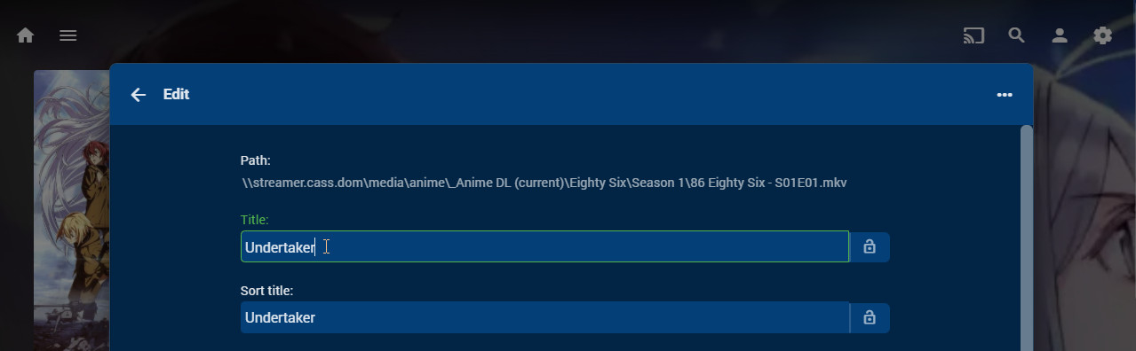

pwhodges 2025 Posted January 29, 2022 Posted January 29, 2022 (edited) The three-dot meu for an item gives an option to edit its metadata, and the first entry there is the title. There is a padlock on the right to lock it: Paul Edited January 29, 2022 by pwhodges
